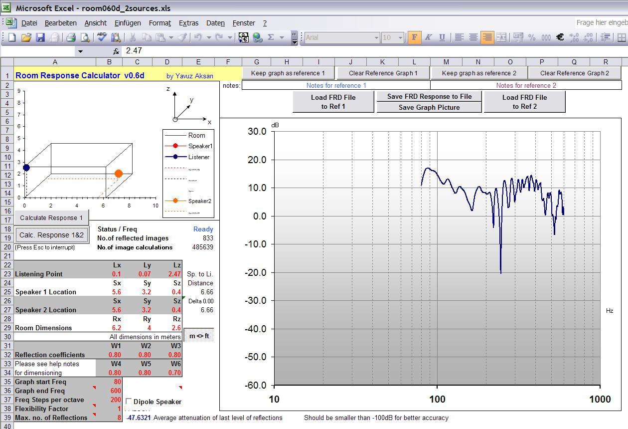

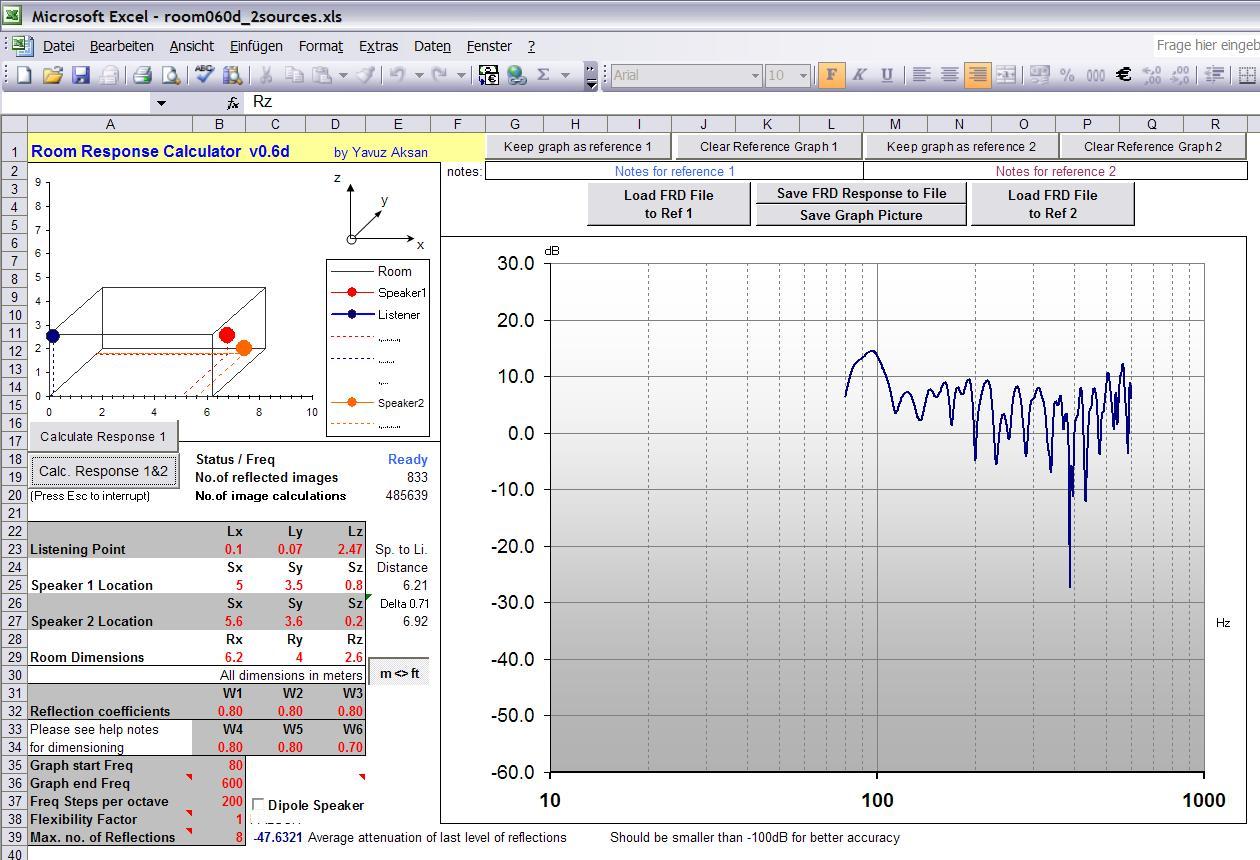

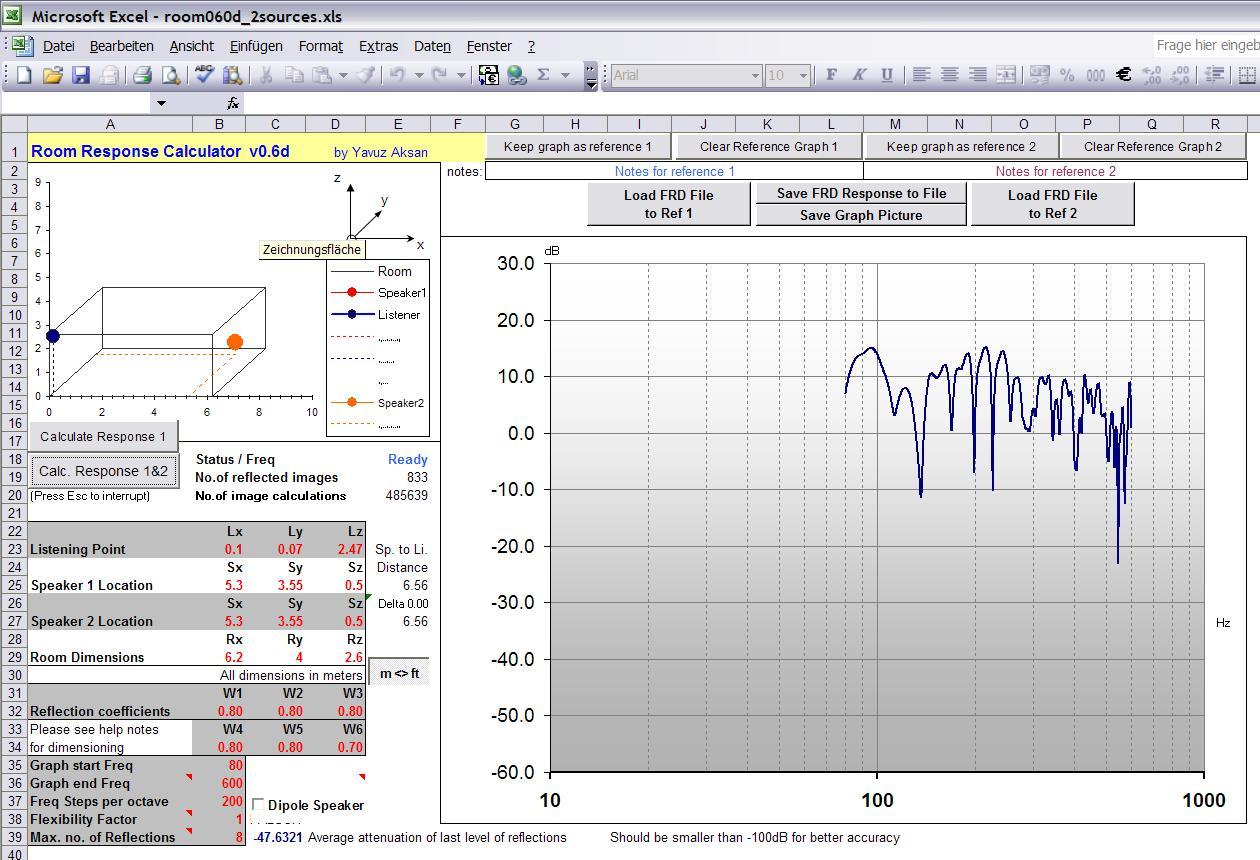

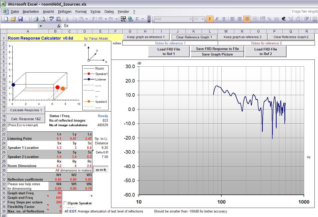

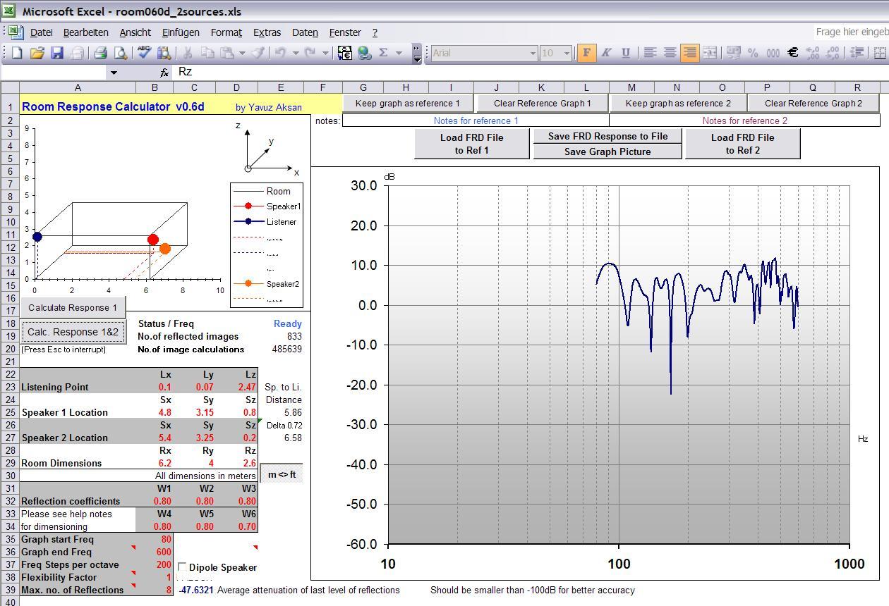

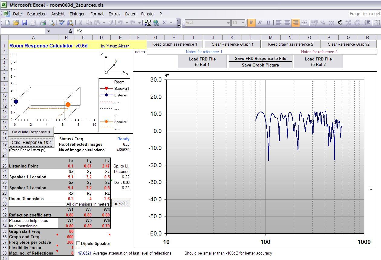

The pictures 1...6 show 3 pairs of "single vs. distributed" sources,
each pair having the same "balance point" in space.
The odd is: You cannot rely on distribution solely.
Speaker and listening position will have to be optimized still, it is just
the probabilty of finding a good combination (having smooth FR) is higher,
when a distributed LF source is used.
Those problems cannot very well be disussed IMO by strict
"do this to get that result" rules, because the problem is a stochastical
one by its nature.
one by its nature.

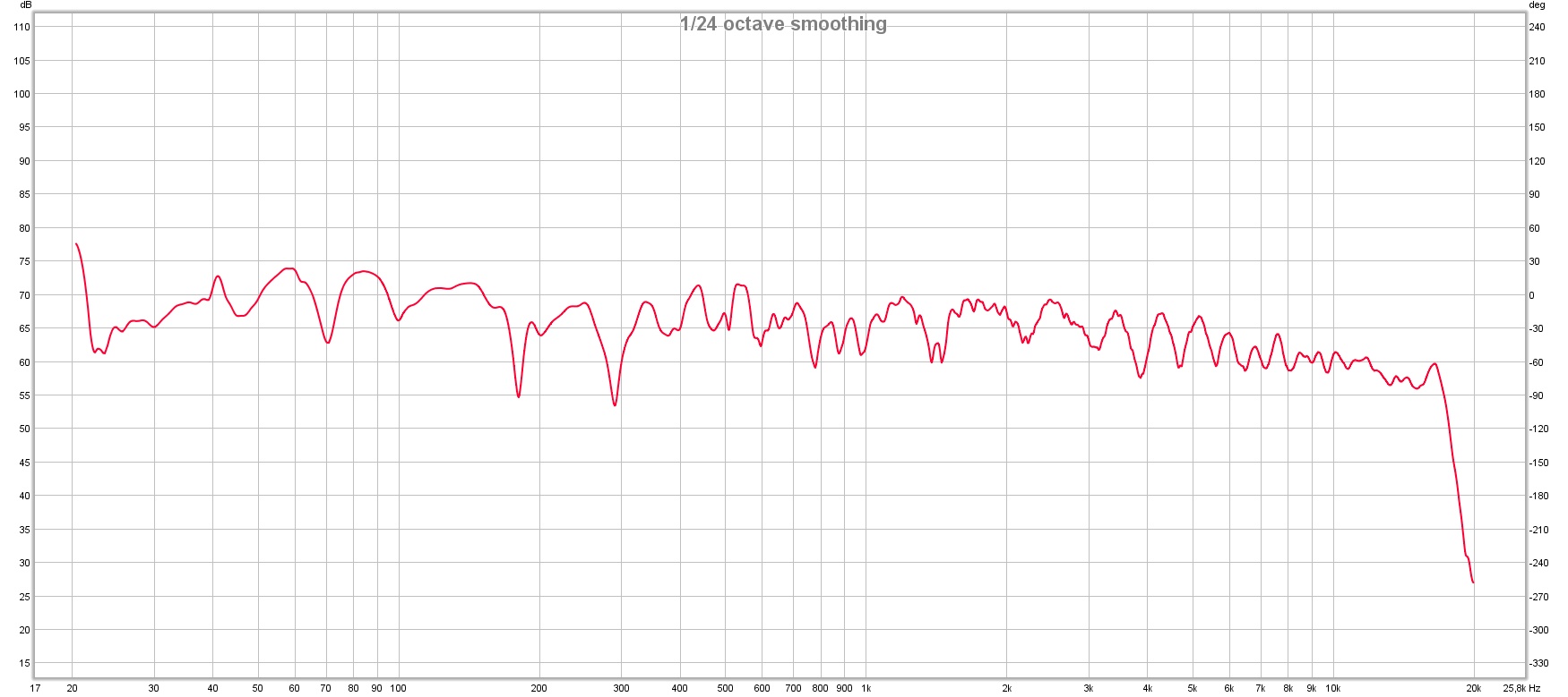

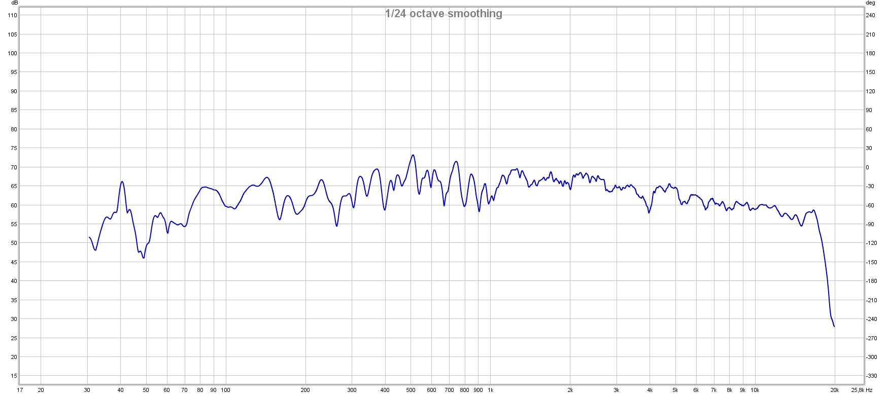

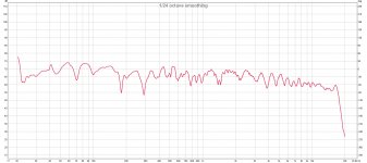

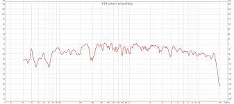

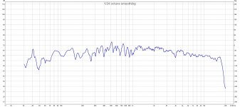

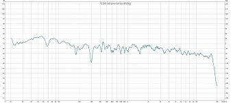

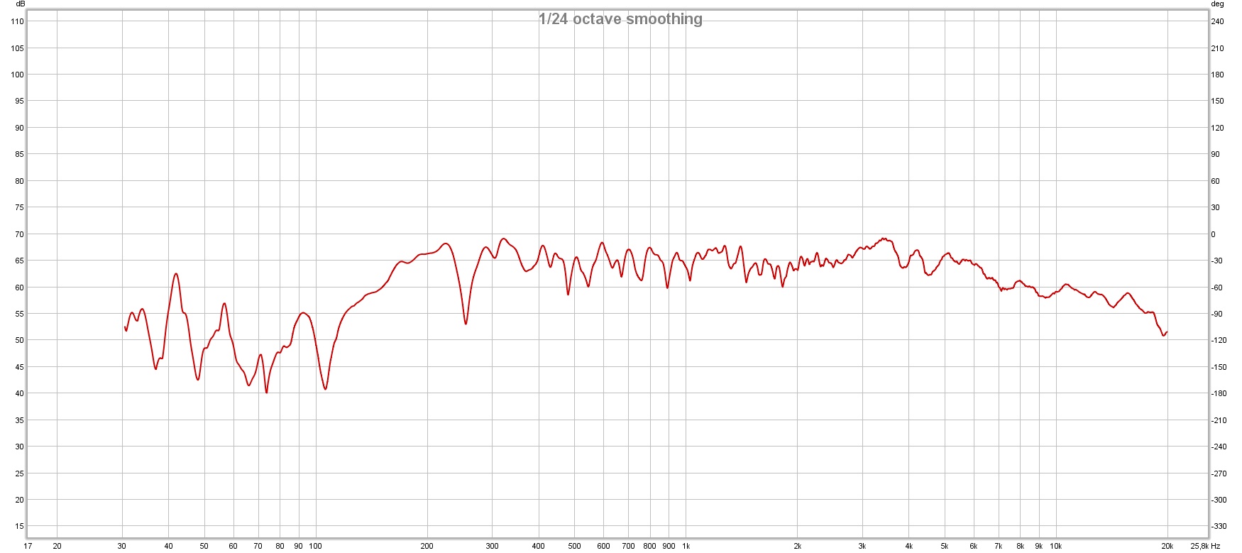

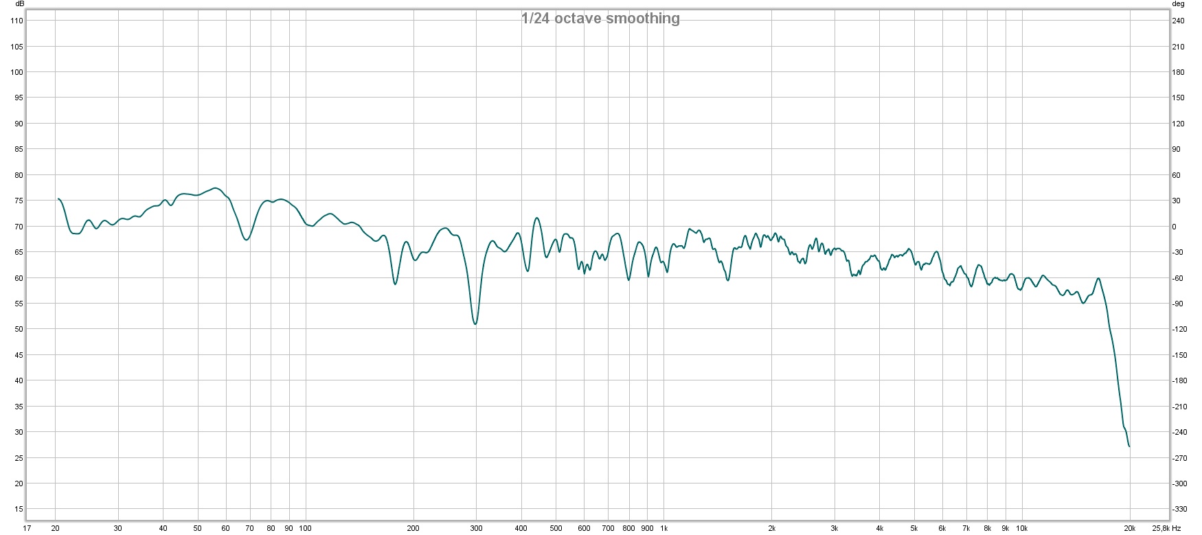

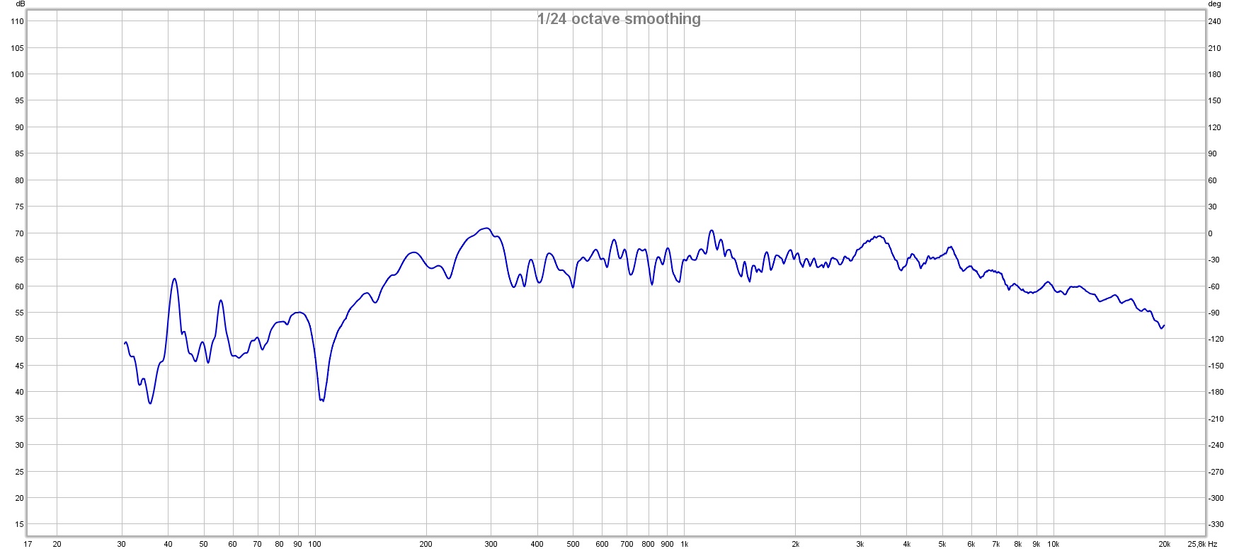

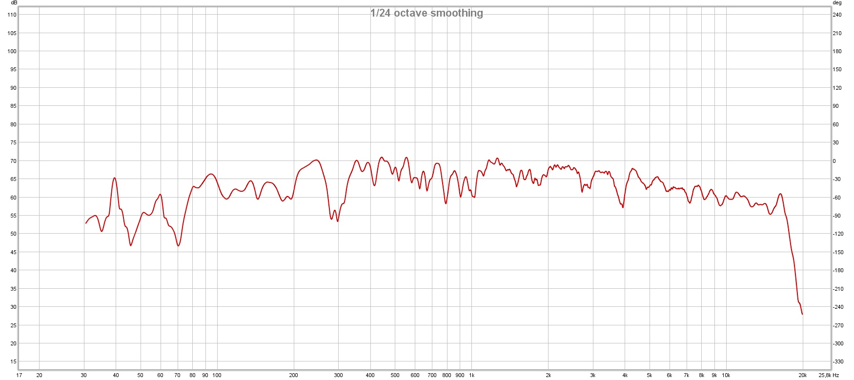

Not sure if this is from the same day, so speakers may have a slight different position, but should be quite similar.Thanks for that, that's a very good result between 100-200Hz indeed, if it was measured at the listening position. 🙂 Did you keep a before measurement as well ?
Here's another example which I'm working with presently. Same room but another pair of front speakers. They both have a dropped level below 200 Hz. Maybe a could lift it with EQ, haven't tried.
Adding the same midbasses measured both channels. Here I'm little stuck moving them due to a rack on the inside. So response isn't quite as good yet. And I'm uncertain if the midbasses will keep ut this response at a higher volume being bandpasses.
And then adding a third subwoofer in the rear of the room crossed over at 80 Hz and changed the phase to 180 degrees. A little flatter response. I need to work more at it. Earl will soon get an e-mail from me....

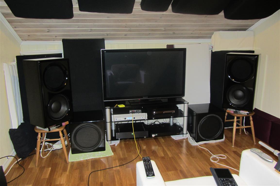

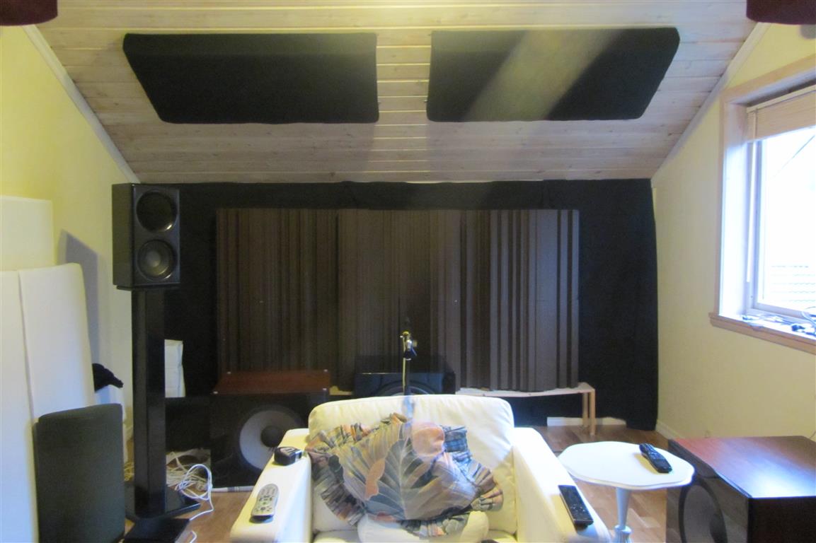

Pictures of the room and setup. Small room with a sloping ceiling is hard. Playing on the long side of the room in front of the windows has it's advantages, but gives me some serious standing waves. We'll see. I'm not a perfectionist when it comes to surround.
