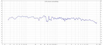

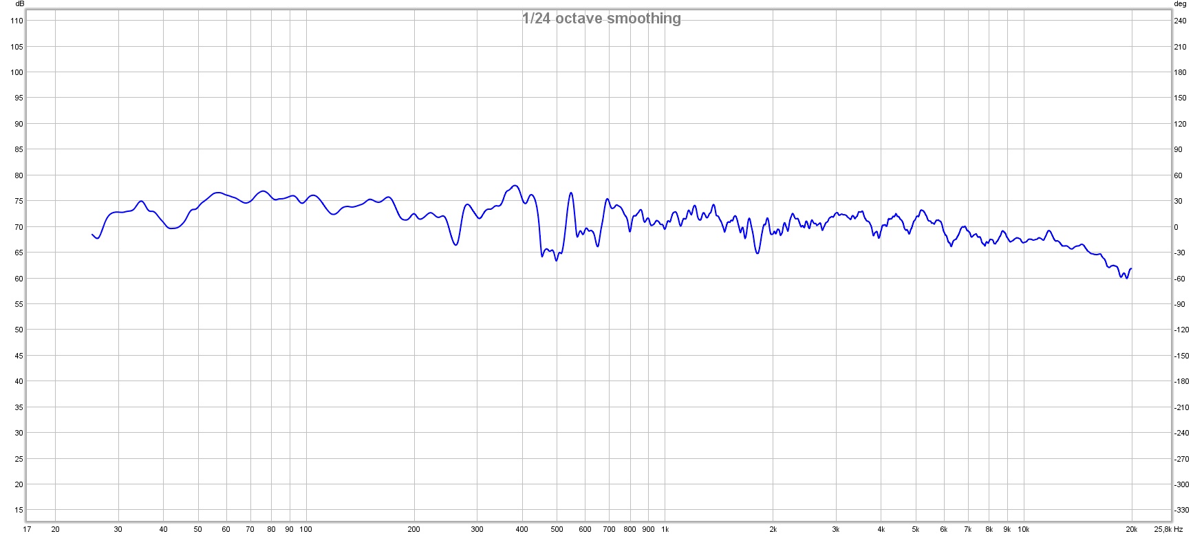

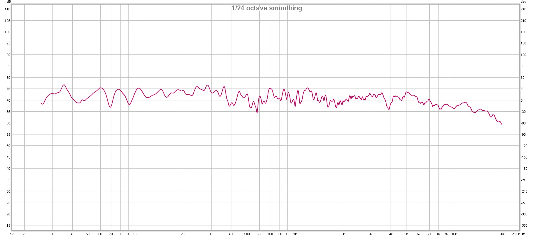

I had a room and a position where the fronts basically had no bass below 180-170 Hz. So I crossed two subs/midbasses over at 170 Hz, placed on the inside of the speakers, and that filled out the area nicely as can see below for each channel. These are midbasses and don't go very deep in frequency by the way. I'm now setting up something simliar, but with one or two extra subs crossed lower. Possibly placed in the rear of the room. We'll see what measurements show.
Thanks for that, that's a very good result between 100-200Hz indeed, if it was measured at the listening position. 🙂 Did you keep a before measurement as well ?
