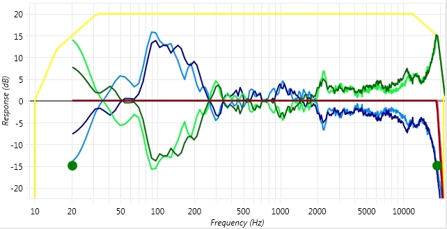

If it is so, then combined with Harman knowledge it may leave us with the following:
- 4 subs in 4 corners (or even better - in ceiling) connected as stereo;
- delay applied to rear subs to be phase coherent with front subs (1m distance is rougly 3ms delay), as it may be benefitial for flatter "terrain" in higher (near crossover) frequencies (have anyone tried this and investigated effects?);
- for same reason additional delay applied to main fronts in respect to aligned subs may be rewarding to play with, too.
IMO dipoles would be more than enough for a small room with 1-3 person listening area. I liked them more than 1/4 in-ceiling setup. Assembled within 4 hours and fed from 6-channel amp through 3-way 4-th order Linkwitz-Riley crossover and EQed down to 20Hz with FIR-based high-resolution room EQ software (still in beta). The bass was quite evenly aligned throughout the small room. This time bass wasn't leaking into the toilet and making 50Hz modal bump there (what a pity!). Also, neighbours confirmed that this time they didn't get much of the bass, so I assume that room modes were not excited very much (as expected from dipoles). No basstraps, no other treatment. Bass was crossed with symmetrical dipole mids at 190Hz and 2ms delay applied to the latter to flatten x-over area. See picture and L/R measurement and correction curves.
So it seems depending on the room size and layout a sub in each corner driven in stereo pairs is ideally suited for the above technique.
Add to this the benefits of modal smoothing - a sub in each of 4 corners is one of the known optimal modal smoothing placement solutions. (even if it uses one extra sub than the 3 sub approach)

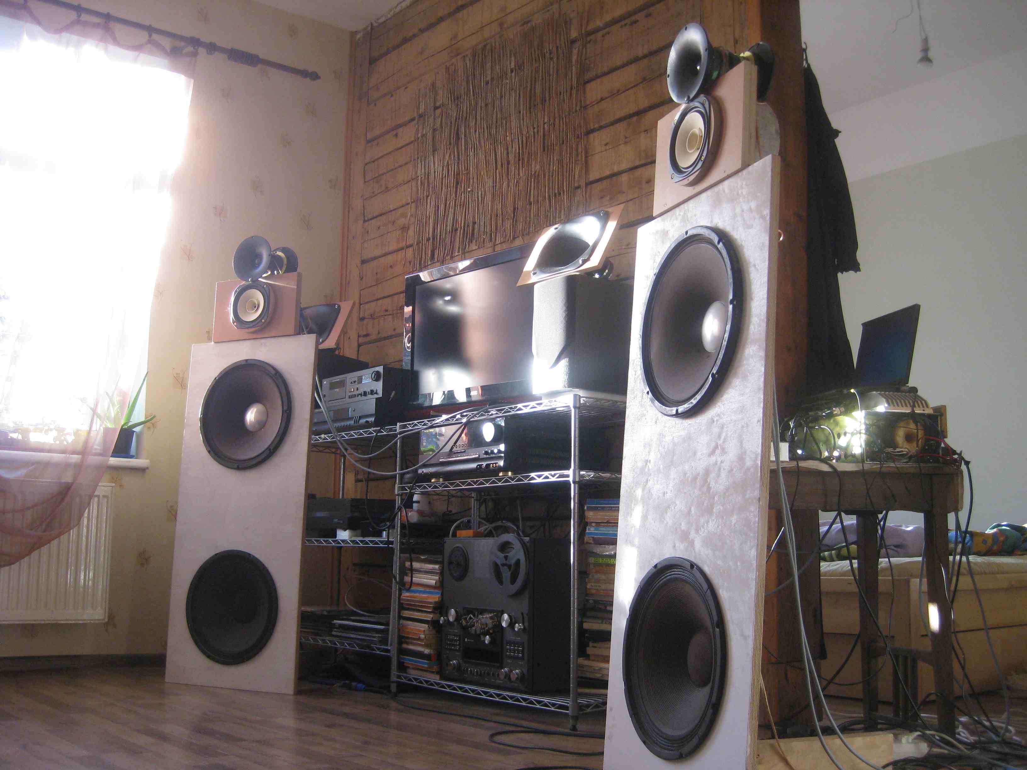

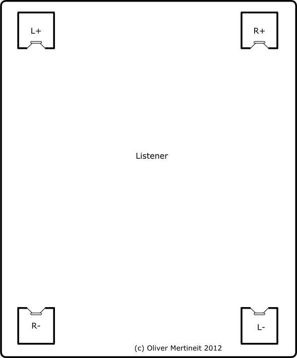

As i was re-reading the Griesinger paper in 2012, i was inspired
to a different (subwoofer) approach using "interchannel dipoles":
Picture1 shows a variant also allowing nearfield listening.
With both channels driven by the same signal, the setup
is like common dipole setups ...
Picture2 shows a variant with dipole saparation equal to
the room's longest axis ...
Kind Regards
I'm not sure that delaying the rear subs is the right thing to do. One of the reasons for having a rear set of subs is so that the lowest fundamental length (front/rear) mode of the room is actively cancelled out.
This happens when front and rear are driven in phase and are positioned half a wavelength apart - eg the length of the room apart. This fundamental mode is quite troublesome because it leads to very "bottom heavy" boomy low bass at the rear end of the room, but a lack of low bass half way along the room.
By adding the rear subs you actually reduce the SPL at the fundamental resonance at each end of the room without affecting the response at the middle - after EQ is applied you then get a much more uniform bottom end response along the length of the room that has good low frequency extension without booming at each end of the room.
If you delay the signal to the rear subwoofers you prevent this active mode cancellation from occurring, and if you delayed them enough to bring them into time alignment with the front subs you would end up with the same mode problem you started with but 6dB more output.
By the way I'm not sure where you get 3ms / 1 metre from - I don't know about you but my listening room isn't 1 metre long! 😀 To make the front and rear subs "phase coherent, you would need 18ms for a 6 metre long room...
When subwoofers regularly have over 20ms of group delay at low frequencies I'm not sure that correcting it by only 3ms would be a worthwhile or even audible endeavour ?
Another thing to consider is that if you have front corner and rear corner subs working together in phase, at frequencies where they're less than half a wavelength apart they create a virtual source in the middle of the room, thus the apparent location of the front subs is not behind the main speakers, the apparent location of ALL subs together is actually in front of the main speakers - but since the subs will have quite a bit of group delay of their own relative to the high frequencies from the main speakers this will push the apparent source location further away, at least from a time alignment perspective.
The net result is the 4 sub front/back arrangement may reduce the effective group delay increase at low frequencies for a listener at the back of the room. (Or am I way off the mark here ? Anyone ?)
