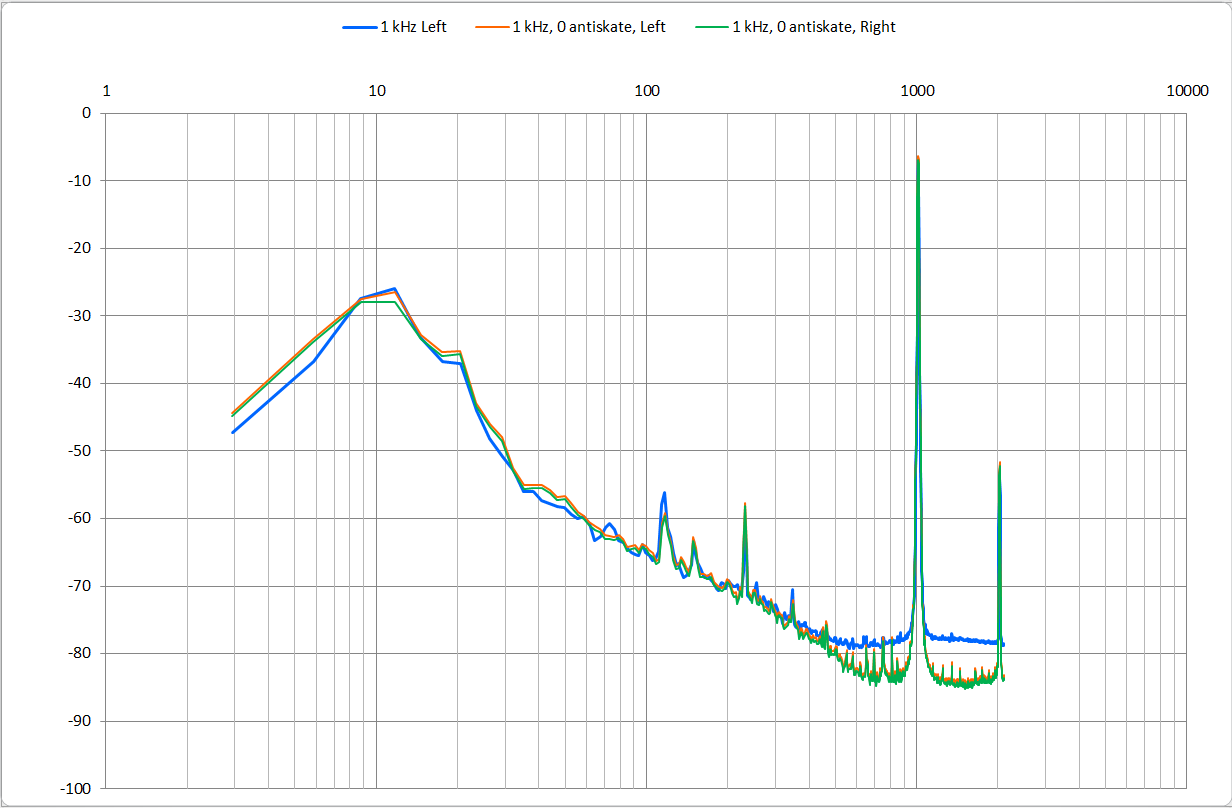

I was thinking about my previous measurements and wondering why the floor noise is not the same both sides of the 1 kHz signal.
I did the measurments again with maximum attention at each step.
And I look at both channels.
Blue graph : new measurement, left channel, anti-skate on; no change with former one
Orange : new measurement, left channel, anti-skate off
Green : new measurement, right channel, anti-skate off
Now, left and right are the same and have floor noise on both sides of the 1 kHz.
With no antiskate, the force of the sylus on the inner wall of the groove should be higher than on the outer wall when the disc is moving under the stylus, because of the geometry of the arm (offset angle ~26°, stylus overhang ~20 mm).

It's great that you could find the time to do this extra test.
It shows that the out of phase rumble noise can be manipulated, in this case by more than 2dB.
Of course one will need antiskating, so this is not the way to go. But by having induced more friction, you have added a bit of extra damping.
This seems to prove that for this type of rumble, even more arm/element damping is needed to reduce the rumble.
This is easier said than done, because how do you add damping to an existing set that doesn't provide this option?

I responded to your previous graph, but your last version seems to give cause for new questions.
Why does no antiskating give so much less noise around 1Khz ??

You mean with no anti-skating the noise floor is lower.
Jan
Yes and it surprises me
- why less noise
- and why on both channels ?
Jacques

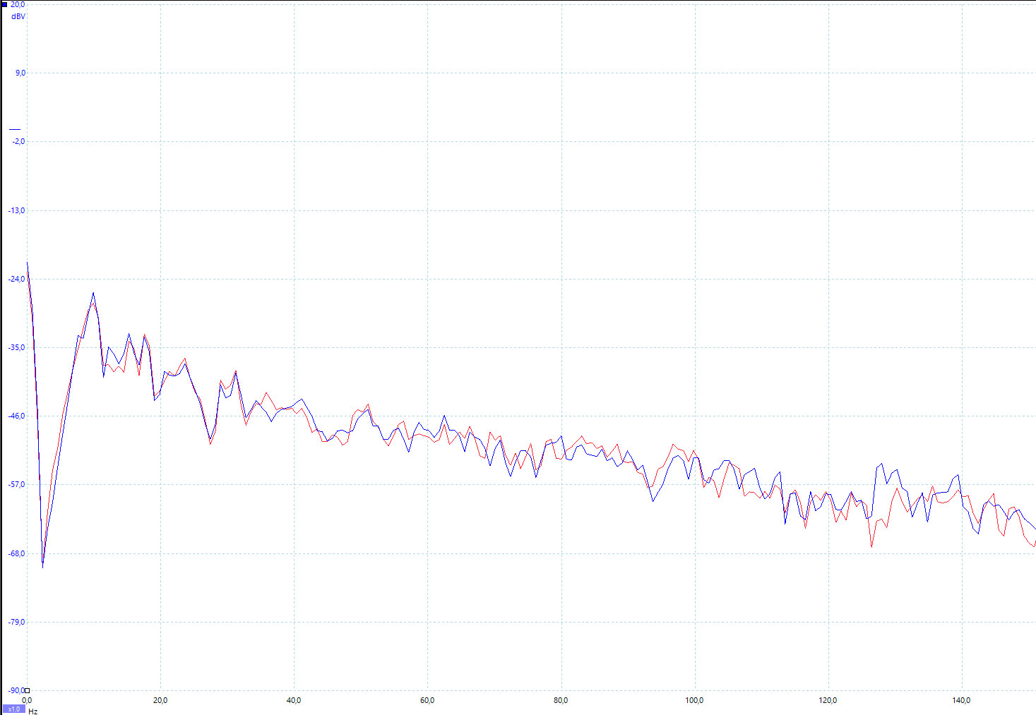

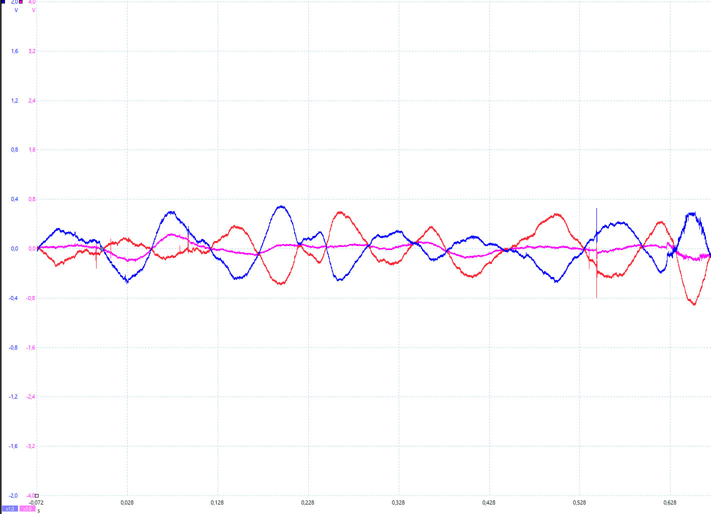

Here are the graphs taken from my pick up.
I noticed that the time signal from an unmodulated track, was not as what I saw before when using Adjust+.
The current measurements are made with my oscilloscope directly attached to the analog output signals.
The first image shows the time signals from both channels, with the sum of both in pink. They are clearly in antiphase.

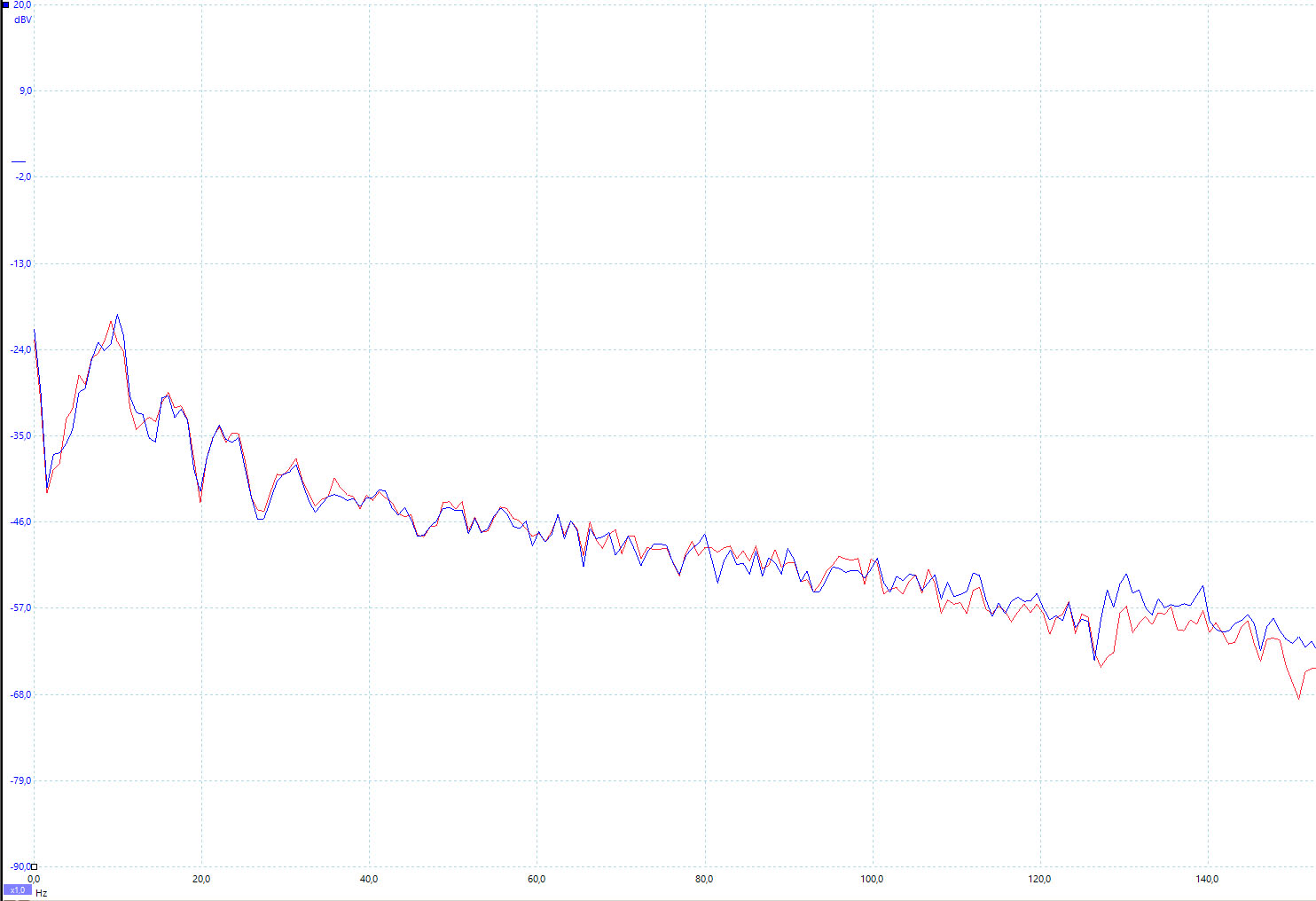

Then the same recording, but now with the 12db/oct rumble filter switched on.
Next is the spectral information.Both channels from 0-150Hz with the rumble filter off, unmodulated track.
Then the same but now with the rumble filter on.

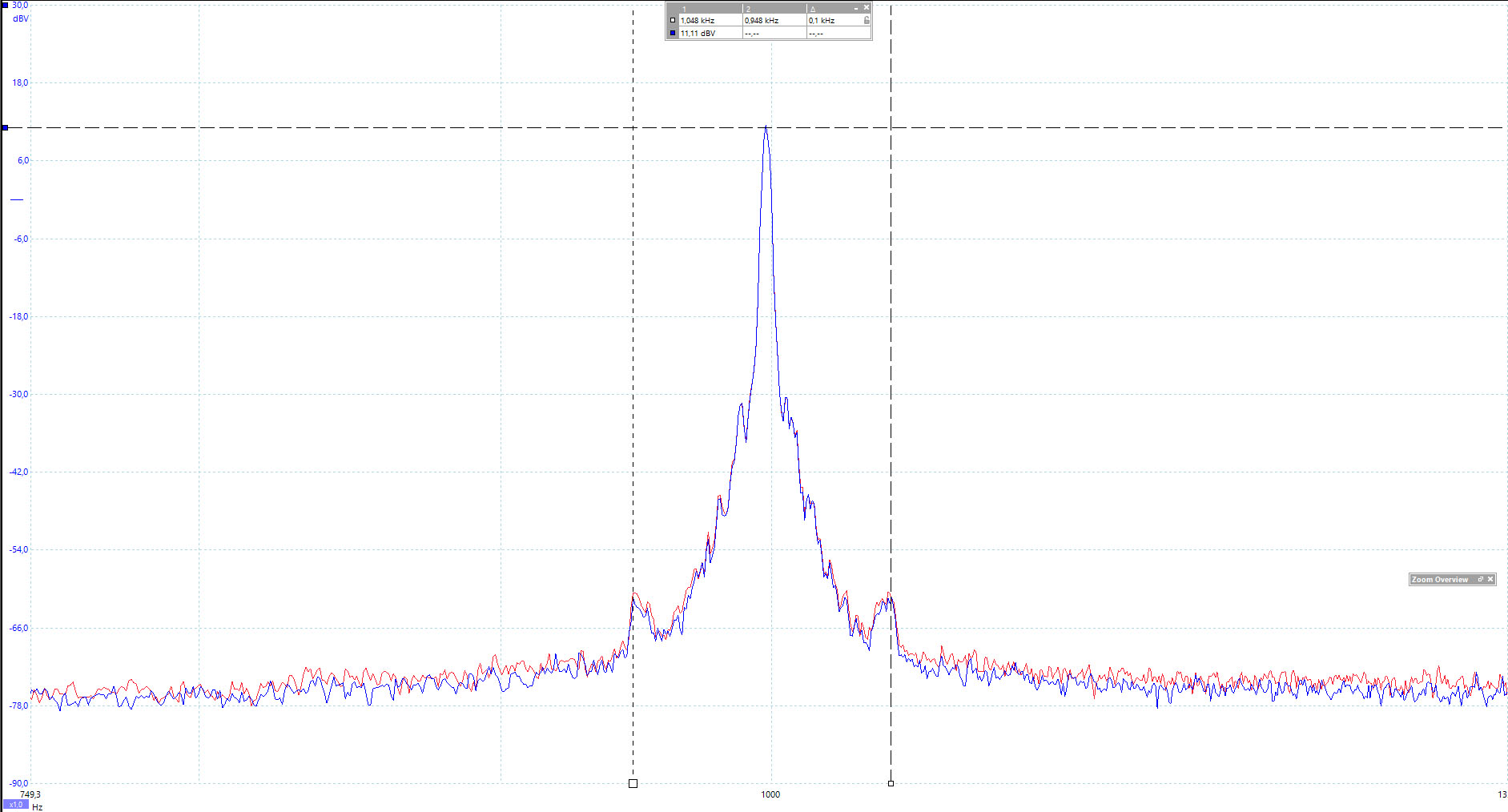

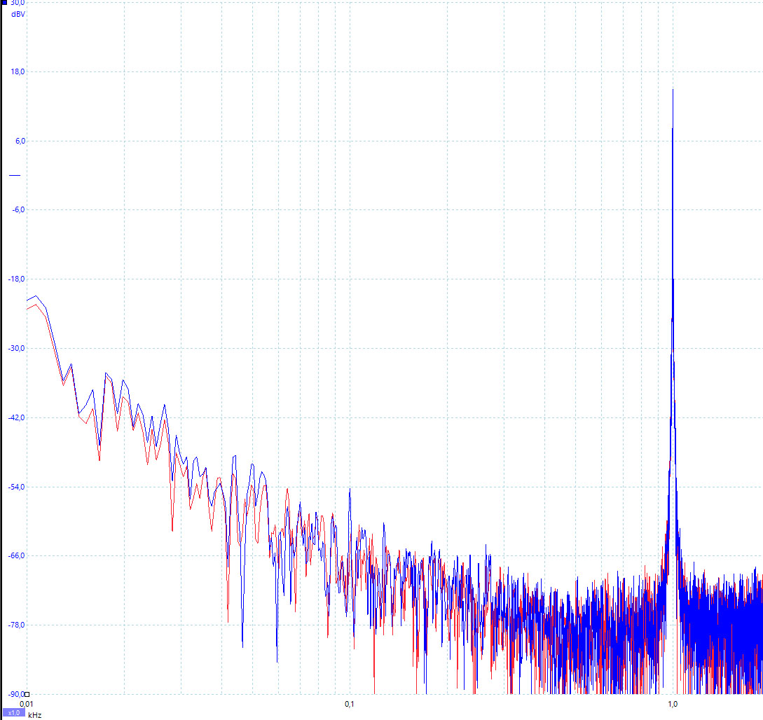

And the last picture shows the spectrum from 10Hz to 1Khz, no rumble filter and with a 1Khz test tone at 0dB.
Notice that when going from an unmodulated track to a 1Khz 0dB signal, the peak at 10Hz does not increase in amplitude.
However the noise further upwards in the spectrum is lower when playing the 1Khz tone compared to the unmodulated track, at 100Hz a difference of roughly 6 dB !
The 10Hz rumble lies ca 35dB below the 0dB 1Khz tone, almost 15dB better as Hyperman has recorded.

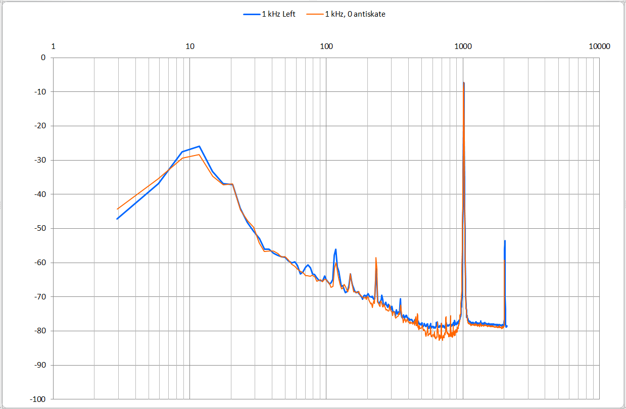

Again if anyone is interested there was a fifth order subsonic filter in Elektor issue of 7-8/96 that I can post. I have omitted the name in case someone has already seen this and is ready to belittle the author's design talents.
I have included a last image, showing IM distortion.
To make this visible in such detail, 32 frequency plots have been averaged with a filter bandwidth of 1 Hz.
What you see in the centre is again the 0dB 1Khz signal slightly polluted with IM products.
The most obvious ones are the +/- 50 Hz, at -72 dB below the main signal, picked up in some way from the 50 Hz mains.
The others, but more difficult to see, are sidebands at 9.5, 19 and 27,5 Hz at resp. -42 dB, -57 dB and -67 dB, all corresponding to the resonance frequency of my pick up arm.
So it is obvious that even with a rather well behaving arm, side bands are still taking their share. Extra damping could most likely help to reduce this IM distortion.
Hans
Hans
