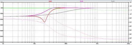

I may have found a reason why the world is hesitating to integrate a “Devinyliser” like feature.

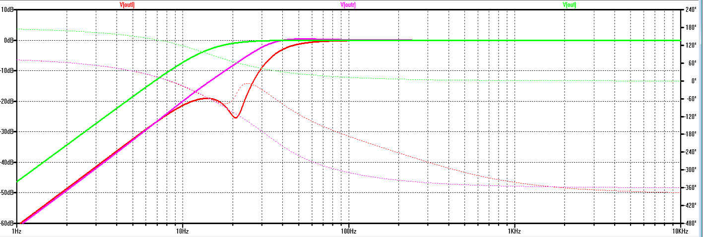

In your design you have assumed rumble with a perfect 180degrees out of phase.
For that you have perfectly constructed a Devinyliser.

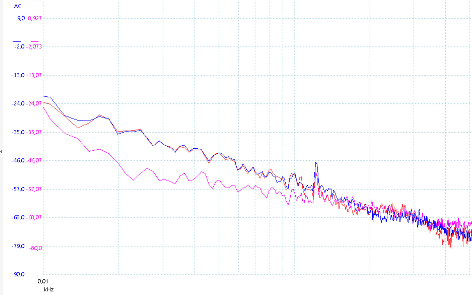

I have simulated the 3rd order version presented in Linear Audio Vol 11, giving results below.
The green line represents the In Phase transfer and the Pink + Red ones the Out of Phase for both channels.
I have also included a grey line representing (In L + In R) but in this case of 180 degrees out of phase, the grey line is at minus infinity and therefore not visible in this figure.
However when recording a real life turntable signal from either an unmodulated track or a modulated track with 1Kh@0dB, the result from 10Hz to 100Hz when adding both channels would also have to be –infinity, like the grey line in the graph above.
This happens not to be the case. On average the damping is some -10 dB.
See figure below. Both channels are resp. represented in blue and red, and the mathematical sum of both in pink. All on the same scale.
At least 32 spectra have been averaged using a filter bandwidth of 1.5Hz. The used sample frequency was 200Khz, to prevent anything unwanted to fold back in the region of interest.
The reason for this lesser damping, can only be because of a phase difference. The L and R Channel are thus not perfectly 180 degrees out of phase.
In fact, looking at the figure, you will notice that around 300Hz both channels and their sum are equal in magnitude, telling that L and R are now 90degrees out of phase, and going further up in the scale, at 1KHz the Pink noise line lies 3dB above both channels, so L and R are now in phase.
There is thus a gliding scale in a changing phase from 1Khz downwards to 10Hz, going from almost zero to somewhat less than -180 degrees.

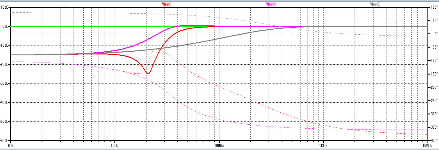

To see what happens with the Devinyliser, I have shifted the phase angle between both channels from 180 to 160 degrees. This produces the figure below.
Now the outputs of both channels with the devinyliser are no longer equal, but below 10Hz both channels converge to -15dB, just as the sum of both channels does represented in the grey line, the way my oscilloscope adds the two channels.
In fact this is a bit overoptimistic because instead of having a constant -160 degrees, there is a gliding scale going to -90 degrees at 300Hz.
With a gliding phase scale, the result will be like this:
Looking at the grey line, this looks quite similar to the damping that was realised with the scope recording.
Conclusion: This seems to be the maximum achievable damping of unwanted rumble with the Devinyliser.
In combination with a regular 2nd order Butterworth filter with -3dB at 14.5Hz, the transfer will look like the figure below, so at least a combination with a regular filter seems to be appropriate.

Hello Hans
I am very glad that someone has put the Devinyliser to work in a real situation.
As you say, it is designed to remove signals that are purely vertical, and it's not to clear how else you could go about it. Your figure of 10 dB surprises me, though.
It is not obvious to me how vertical stylus movement can show this sort of differential phase shift. Do you have a hypothesis?
I am sorry, I have read dozens of papers, patents etc on the subject, but I cannot retrieve the two earlier proposals from 1961 and 1967, published before Macaulay, Langvad and Oldfield.

Here I am afraid I have to disagree with you totally. If the symptom is a lack of bass, then I would turn up the bass control. It's cheaper than buying new speakers, which is what the hifi mags would tell you to do. You will have seen my approach to a decent tone-control in the Linear Audio preamp: http://www.diyaudio.com/forums/analog-line-level/280458-doug-self-preamp-linear-audio-5-a.html and it has bass and treble controls, each with variable frequencies. I think More is More here.
Likewise you might be able to do without a balance control if you had a totally symmetrical listening space and- significantly- perfectly matched loudspeakers, but how often is that the case?

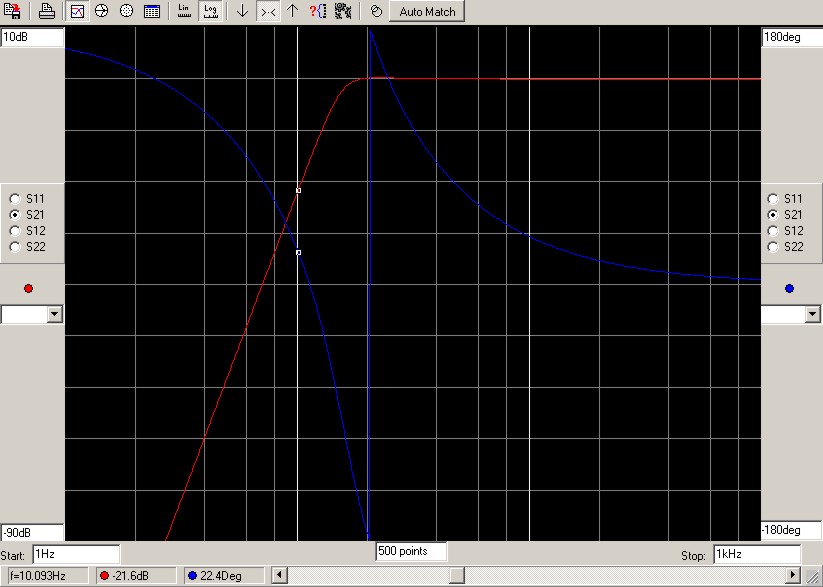

The Twin-T notch (band-stop) filter
I'm having real trouble trying to get any sense out of this.
Clutching at a recognisable concept, I will say that the twin-T circuit would be my last choice for a notch filter. More on that later.
Why would twin T not work ? In radio they did. Rumble usually is 23Hz + 100 Hz if a Garrard 401. In truth a rumble filter is a bit like curing the holes in cheese by killing the bacteria.The convetional filter as I said should worrk. Like Michael Gerzon who talked to me about filters. I favour passive twin T ( Michaels simplest solution I think ). Happy to be wrong. That why these pages exist. Even a bad I idea can cause the right debate. Michael proved the seemingly identical filter can sound different. Flutter echo I think was said. I might be mixing that with other things. KISS as is often said.
The twin-T is usually the last notch configuration you would use, because its notch depth depends critically on the matching of six components.

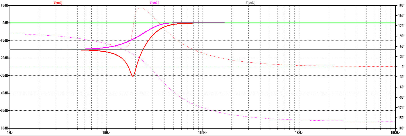

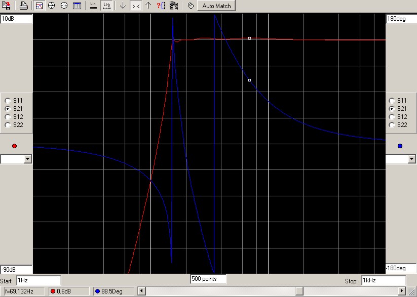

While we speak of notches:
Here is the simulated response of my 3rd-order elliptical filter. The notch is generated by a Bainter filter, which here gives a -65 dB with no adjustment or matching of parts. It is a truly beautiful circuit; the notch depth depends only on the opamp gain, which does not drift. The opamp models used were TL072, on the basis that whatever opamp was finally used it would have more gain than that.
Last night I built one, using 5532s. With no tweaking whatever the measured notch depth is greater than 95 dB. What about yer twin-T now, eh? The Bainter has another advantage in that it uses only two precision capacitors rather than three. It's also very good at making highpass notches, which is what you need for a highpass ellptical filter.
It is bitterly ironic that in this application a notch depth of more 50 dB is not really required.
You can see in the plot that there is massive attenuation at 10Hz, but compared with a 3rd-order Butterworth (red line) the -3dB point is higher and so the passband is less flat.
What is the answer? A 4th-order elliptical filter, perhaps. Building one now.

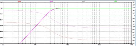

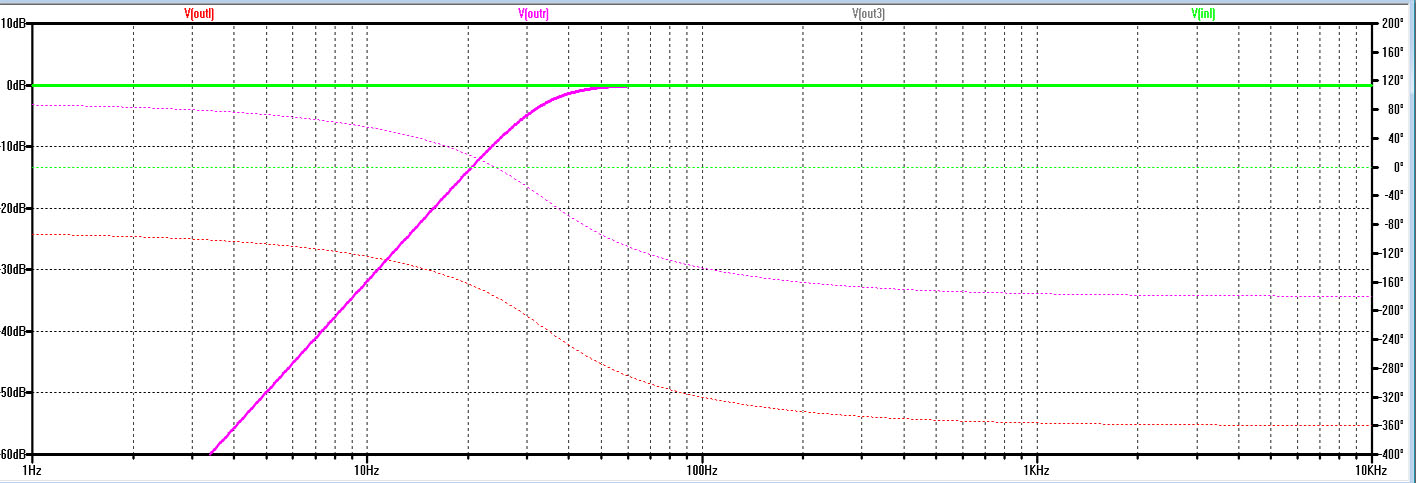

Why not use a higher order active HPF?
A 6th Order Sallen-Key 15Hz HPF with Butterworth response would be -21.6dB @ 10Hz and -.2dB @20Hz.
An 8th Order Sallen-Key 15Hz HPF with Butterworth response would be -27.5dB @ 10Hz and -.11dB @20Hz.
An 8th Order Sallen-Key 15Hz HPF with Elliptical response would be -53dB @ 10Hz and passband ripple of ±0.7dB from 20Hz to 100Hz.
The Red trace is amplitude response, the Blue trace is phase.
