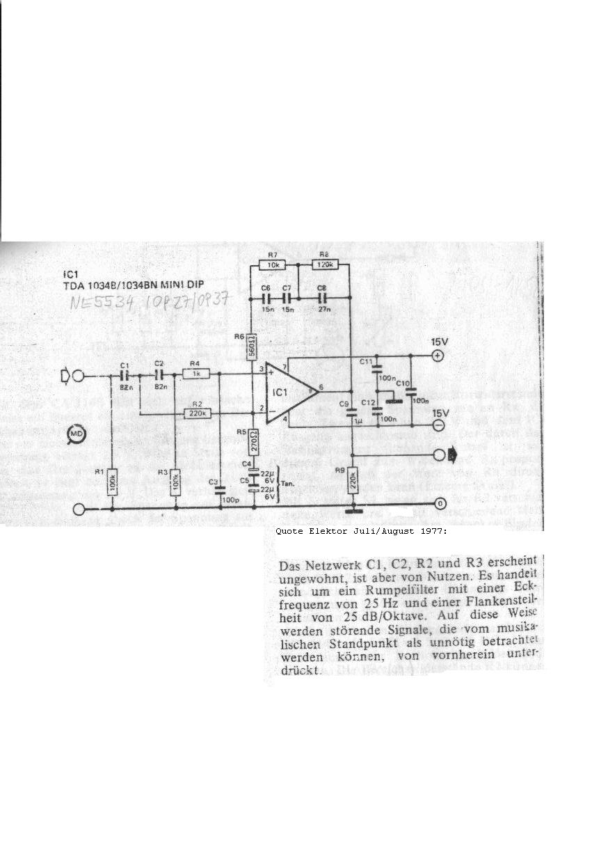

the only schematic i have with a rumble filter at the input.........but i have never built it.
This looks like an idea put forward by Tomlinson Holman in the 80's. I've never tried it either- I would be nervous that the noise performance would be impaired, and those relatively small caps at the input would make the circuitry after them very susceptible to capacitive pickup of hum etc.
'flankensteilheit' means 'edge steepness' which I assume is the rolloff slope, but I don't see how it could ever be 25 dB/octave. Could be a typo for 24dB/octave, of course, but the circuit looks like a second-order filter to me, which would give only 12dB/octave. There could be some subtle interactions with C4,C5 and C9 that yield 24dB/octave; a quick sim would answer that but for the reasons above this doesn't look like a promising path to explore.

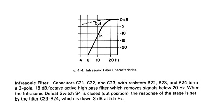

I'm quite ignorant of these things - are they also called infrasonic filters? That's what I found in a brief search of the Apt Holman service manual. If it's on topic, I can try to post the relevant sections.
Please do- post the lot!
You asked for the lot, here's the info dump 🙂
It's an RC filter, Butterworth. Sorry for the low res schematic, it's all I have. All this info comes from the Apt Holman preamp user and service manuals. In addition to the tech details, he mentions why it's needed. He applies it to all inputs, is that common?
From the manuals:
From the manuals:
The selected input passes through a 3-pole, minimum phase Butterworth infrasonic filter to remove signals below the audio frequency range. The filter's response is flat +/- 0.5 dB at 20 Hz and above, is 3 dB down at 15Hz, and rolls off at 18dB/octave so that its response is down more than 30 dB at 4Hz, where the strongest warp signals and tonearm/cartridge resonance commonly occure. The filter also eliminates the the powerful infrasonic thump which FM tuners can generate when rapidly tuned off station. A switch on the rear panel permits the filter to be defeated for special testing purposes.
Phono and line inputs are all processed through this filter to prevent infrasonic noise from adding distortion to tape recordings or the power amplifier and loudspeakers. The group delay of the filter is 4 milliseconds at 50 Hz, while the limit of perception is over 100 milliseconds at that frequency. With the filter defeated the -3 dB frequency is 8 Hz.

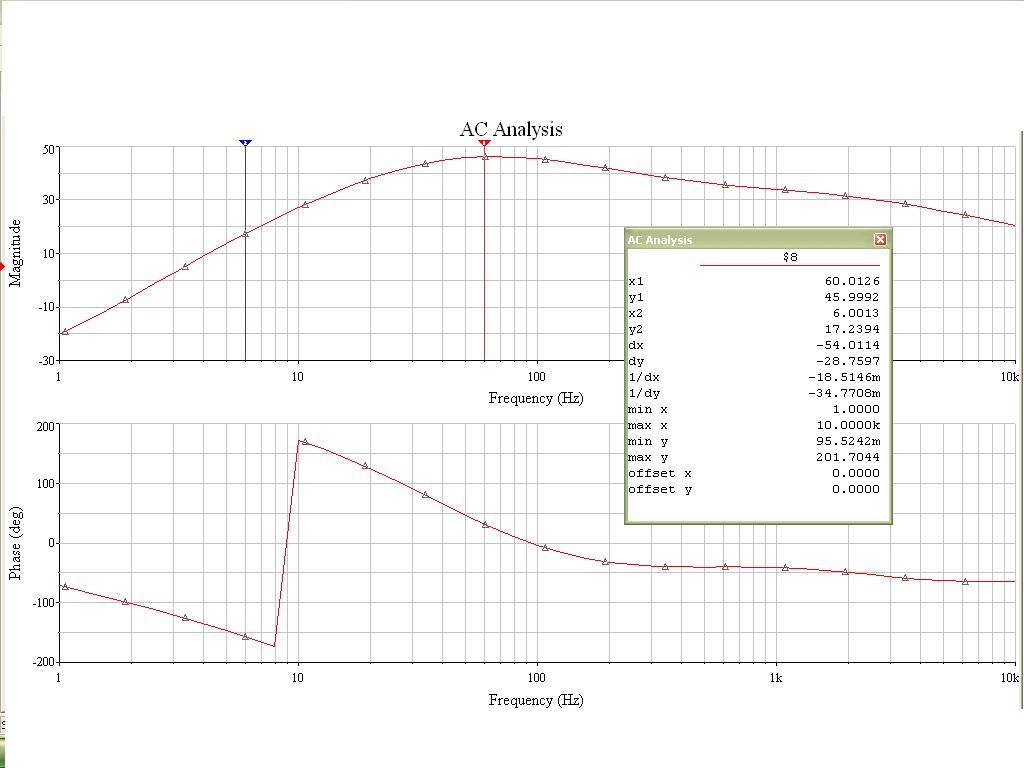

........made a sim
The response is shown as rolling off at -14dB/octave between 1 and 8 Hz.
That's weird.

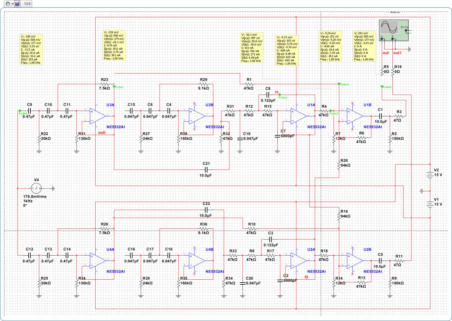

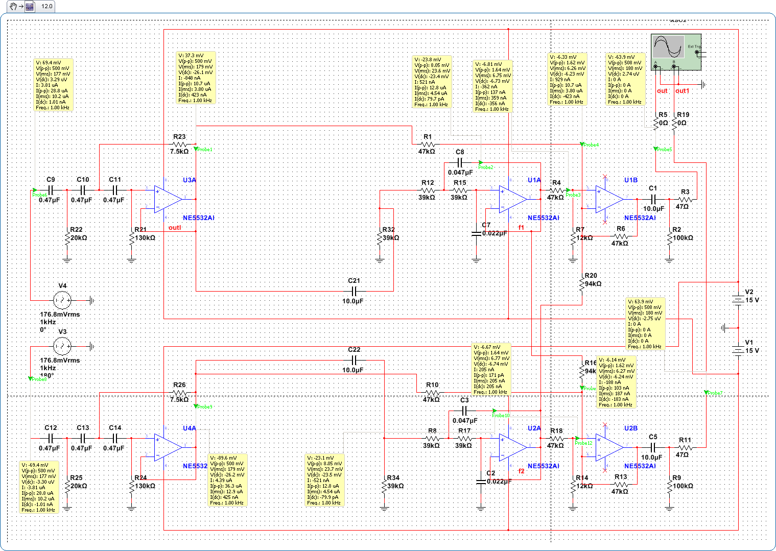

See circuit, attached PDF file
DA1, DA2 RIAA equalization with fully passive and separated filter left channel
DA3, DA4 RIAA equalization with fully passive and separated filter right channel
DA5.2 rumble filter left channel
DA5.1 rumble filter right channel
DA5.2, DA6 SUPER rumble filter left channel
DA5.1, DA7 SUPER rumble filter right channel
DA8, DA10.2, VT1, VT2 impulse noise blanker left channel
DA9, DA10.1, VT3, VT4 impulse noise blanker right channel
DA11, DD1, DD2 COMMON PART of circuit impulse noise blanker
DA12.2, DA13 stereo base enhancement left channel
DA12.1, DA14 stereo base enhancement right channel
DA15.2 output buffer left channel
DA15.1 output buffer right channel
Output level 500 milliVolts
Works with MM cartridge 5milliVolts and 1milliVolts
Works with MC cartridge 0.4milliVolts and 0.1milliVolts
