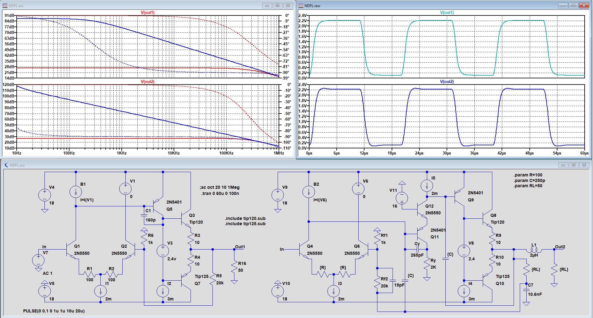

Out of curiosity I built this Cherry NDFL in LTSpice because I didn't get the advantages for such a complicated feedback system over a simple second order feedback system only costing an additional resistor and a cap in series with the dominant cap.
So I made the traditional amp as in his fig. 2, with a gain of 21 and a BW of 300Khz.
Then going to Cherry's circuit I had to solve the following parameters:
BW = 300Khz = 1/tau x
taux = 3,33e-6
Beta = Rf1/(Rf1+Rf1) = 1/21
RC = Beta*taux = 0.16e-6
R = 100 thus C = 1.6 nF
Ry*Cy = taux
Ry = 2k thus Cy = 1.7 nF
taul = (sqrt3-1)*taux = 2.44e-6
Rl = 50 this output C = taux/Rl = 67nF
Cap parallel to Rf2 is taul/Rf2 = 122pF
I could not read the value of the output coil, so I made this one a 2 uH.
All these cap values seem rather over the top, and they are as seen in the FR below.
At the left the "traditional" amp. In the upper plot you see Open loop gain, resp closed loop gain.
In the plot below the step response.
At the right the Cherry amp with all the feedback caps and the extra gain stage.
Open and closed loop are much worse and so is the step response.
I played with all cap cap values, and did not manage to improve Open loop while keeping the BW of 300kHz.
Hans

Your capacitance values are certainly high. The compensation capacitor C is dependent on the input degen. resistors. In Cherry's original he used 330 ohm, not 100, so I would expect to see a higher capcaitance than his original here (68p), but not 1.6nF
The 2nd stage was 470p not 1.7n. I'm not sure what you were aiming to achieve, here, because using only small signal transistors with a high bandwidth probably does not need Cheery's approach - in other words, unless you include power transistors of 2MHz you could make all the frequency components aim for a higher figure, I suspect.
I think that is it - your taux is too large by a factor 2 pi at least.
I would be more impressed if you had used the LTSpice file to prove your point.
The amplifier at the left works fine, and Cherry suggests to have created an open loop gain that goes much farther in frequency and then starts to go down with resp. 18, 12 and at last with 6dB/oct.
Nothing of that kind is visible here.
Conclusion can only be that either his formulas or the circuit diagram are wrong.
Hans

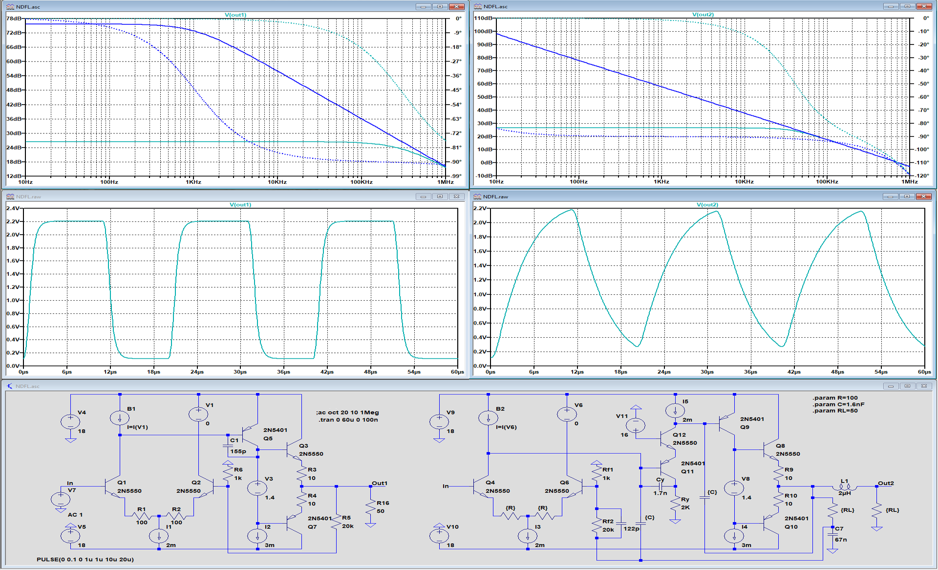

You were absolutely right about the taux.
Cherry was using radians.
So I changed all the caps, now being 6.28 times smaller.
I also changed the output transistors in Darlingtons, to cause less load on the stage driving them.
But as expected, it did not change anything to the fact that the open loop gain is still going down with 6dB/oct instead of the resp 18, 12dB/oct.
Only the BW has been shifted a factor 6.28.
See image below, showing both open loop and closed loop FR, where both versions now have the same -3dB closed loop BW of 300Khz.
Still no advantage whatsoever over the simple version.
Hans

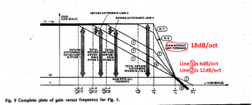

How are you calculating open loop gain? The second capacitor (C) is a "hidden" compensation (the one directly from the output rail to the base of the VAS) which needs to be "open circuited" to obtain the OLG, which probably causes you to see a 6dB/octave. Cherry showed a Bode plot without any feedback effects then adding one of the three at at time. I'm sure you will see the 12dB slope if you start from scratch.
Well, I don't use LT spice as I use another simulator. I don't know what point you are trying to make as I merely pointed out that your calculation of taux shoud have been 1/(2.pi.BW). That seemed to me to be why your capacitances seemed to be larger which is what I thought your concern was. I wasn't criticising your circuit as such other than to question why using only small signal transistors. I did not say it did not work!
And, Cherry's NDFL circuit was only a 2 stage which means only a 12dB/octave highest slope.
I find the supplied graph rather confusing.
I looks as if the Gain without feedback is 18dB/oct, changing into 12dB/oct at 1/taux
To get a stable amp, this means that the closed loop gain should intersect this with 6dB oct, which is obviously the function of the cap parallel to Rf2.
Maybe one should read the full article nr11 in the reference list, but I don't have that.
IMO something seems absolutely incorrect in this article.
Hans

That set of Bode plots referred to an illustrative (outline) circuit of at least 3 nested feedbacks. Which implies at least three separate gain stages, (giving 18dB/octave) that's all really. His NDFL design which was popularised in ETI (1983) used only 2.
