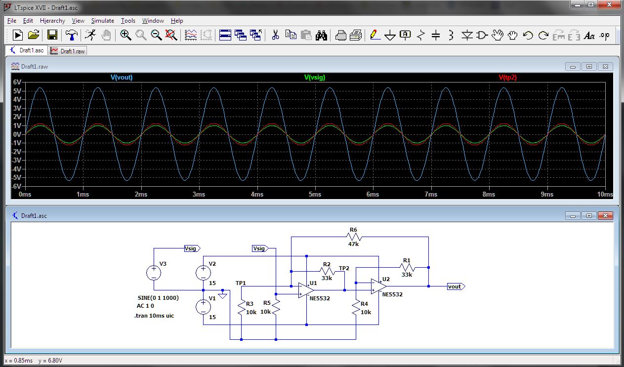

In the thumbnail is a simple example using a couple of op-amps. Each has their own local feedback resistor (R1, R2). R6 is feedback from the output of the second stage to the input of the first. So, nested feedback.
Each stage has a gain of about 4 so total gain == 16
Add R6 to give feedback from the output to the first stage now gain == 5

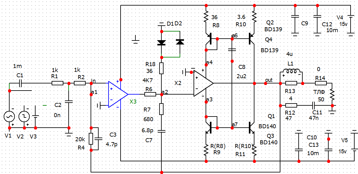

Nesting should of course not be a target in itself, but it has to serve a purpose.
Cherry's purpose after all was to get a reduction in distortion.
I was concentrating on an increased open loop gain, to give a higher feedback ratio through an increased loop gain.
But Cherry constructed something from several locally fedback parts, that overall gave a misleading unspectacular 6dB/oct open loop gain roll off.

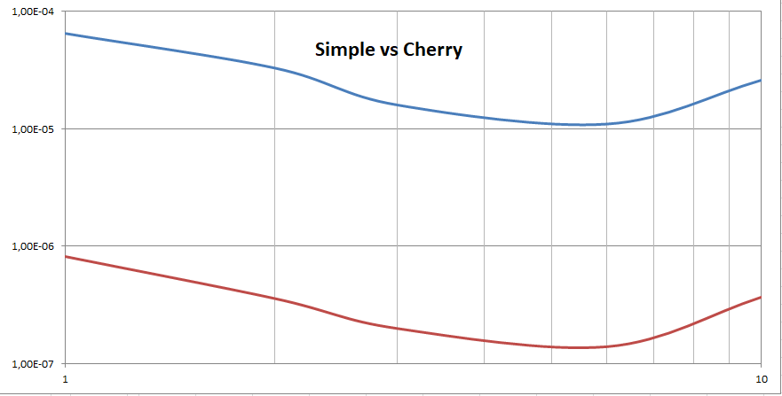

But when measuring distortion, the true benefits became clear, see image below showing 3rd harmonic from 1 to 10 Volt @ 1kHz, just as in the supplied article.
Against the simple version without nesting, Cherry's version reduced the distortion by a factor 100.

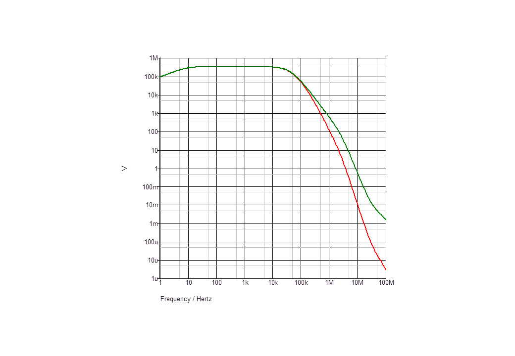

As Cherry showed, then, Hans.
But you still seem to have trouble with the 6dB/octave?
If I remove all the frequency controlling components (the input filter, both "C" capacitors and "Cy" the OLG falls at a rate of around 18 db/octave.
The two curves in the image are with and without the output inductor.
If I remove all the frequency controlling components (the input filter, both "C" capacitors and "Cy" the OLG falls at a rate of around 18 dB/octave.

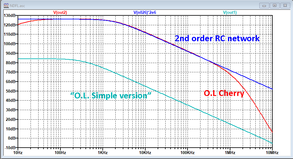

No, I have no problem whatsoever with a 6dB slope, but as I explained, reading the article I was almost pushed in another direction of thinking.
And also the text, choose your critical Frequency 1/taux caused me to make the 2Pi mistake.
About the open loop shape, this depends largely on the components used.
As an example I have added the OL response of my circuit drawn in red, after having removed all caps.
On top of that I have projected in blue a second order FR, showing that up to 400kHz, response is 6dB/oct. From thereon it continues with 18dB/oct.
In teal you can see the open loop of the "simple" circuit, showing that from 1Khz and upwards, the Cherry version has 50dB or more open loop gain.
So when distributed over several nested subsystems, a theoretical distortion reduction of 50dB can be achieved, but phase distortion reduces this in this case to an excellent 40dB.
So at the end after some frustration, everything was alright and it was a fruitful exercise.
In this sort of complex cases, it's always good to see a complete example being worked out with FR images to prevent misunderstandings.
But they are probably in his reference #11.
And thanks for making me aware of the 2Pi misunderstanding.
Hans

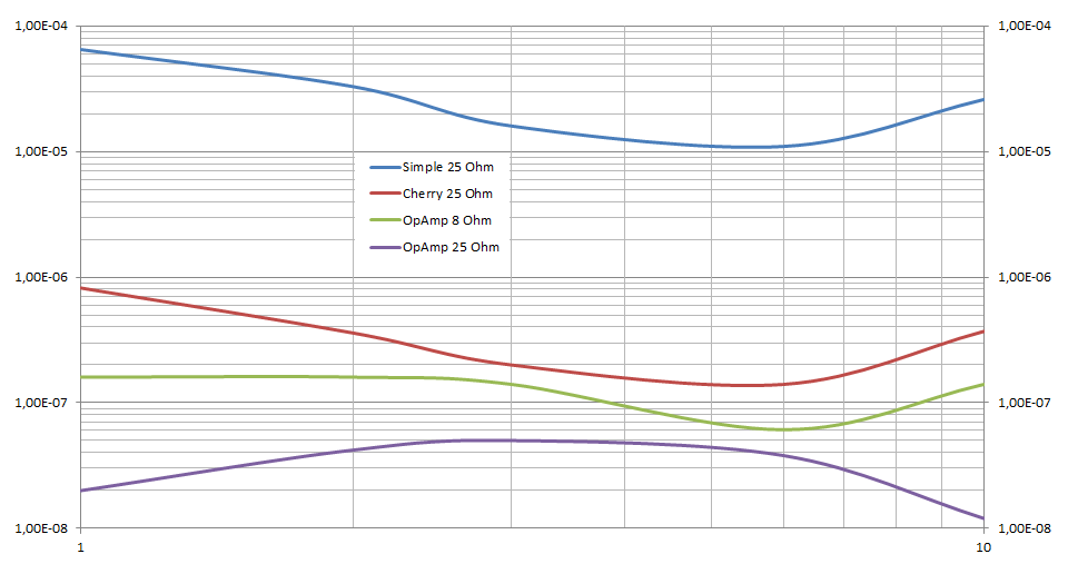

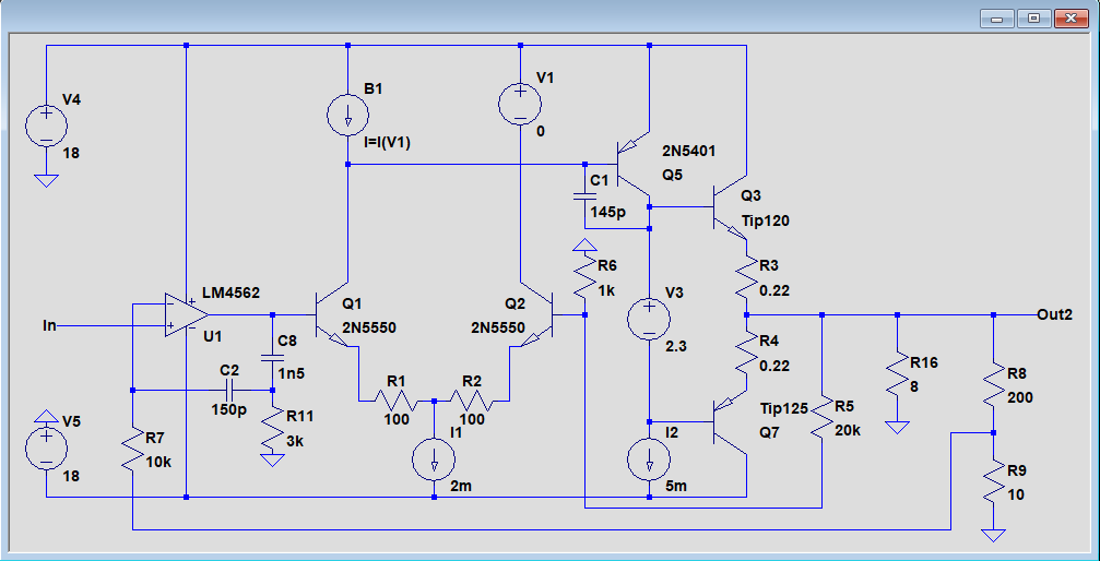

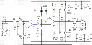

Still looking into nested solutions, I constructed this version with a single LM4562 Op Amp around the "simple" version as shown before.
The advantage of this design is that it can be applied to any existing amplifier without modification.
As a second function it will keep the Main Amp's output voltage at the same level as the OpAmps input level, removing the need for large Caps in the feedback path of the Main Amp.
As can be seen, the simple amp with this nested OpAmp design performs significantly better as the more complex Cherry design when both loaded with 25R.
Even when loading this version with 8R beats the Cherry loaded with 25R at arms length.
Hans
P.S. the distortion graph shows the 3rd harmonic while applying a 1khz signal from 1 to 10 Volt.

I think TPC (which I use a lot) and TMC ( which I used on my e-Amp) work very well at using the available loop gain to reduce distortion to low levels. It seems to me that nested feedback requires a lot of engineering effort for moderate improvements. TPC and TMC will get you a c. 14 dB or more improvement at 20 kHz for the cost of a resistor and a small good quality cap.
That said, there is a lot to be gained by just following the basic rules as set out by Self and Cordell in getting unwanted distortion to negligible levels before lowering it further with feedback.
You also can try OITPC (Output Inclusive TPC). 🙂 I use it now in all my power amps.
OITPC - Output inclusive TPC (not TMC)
