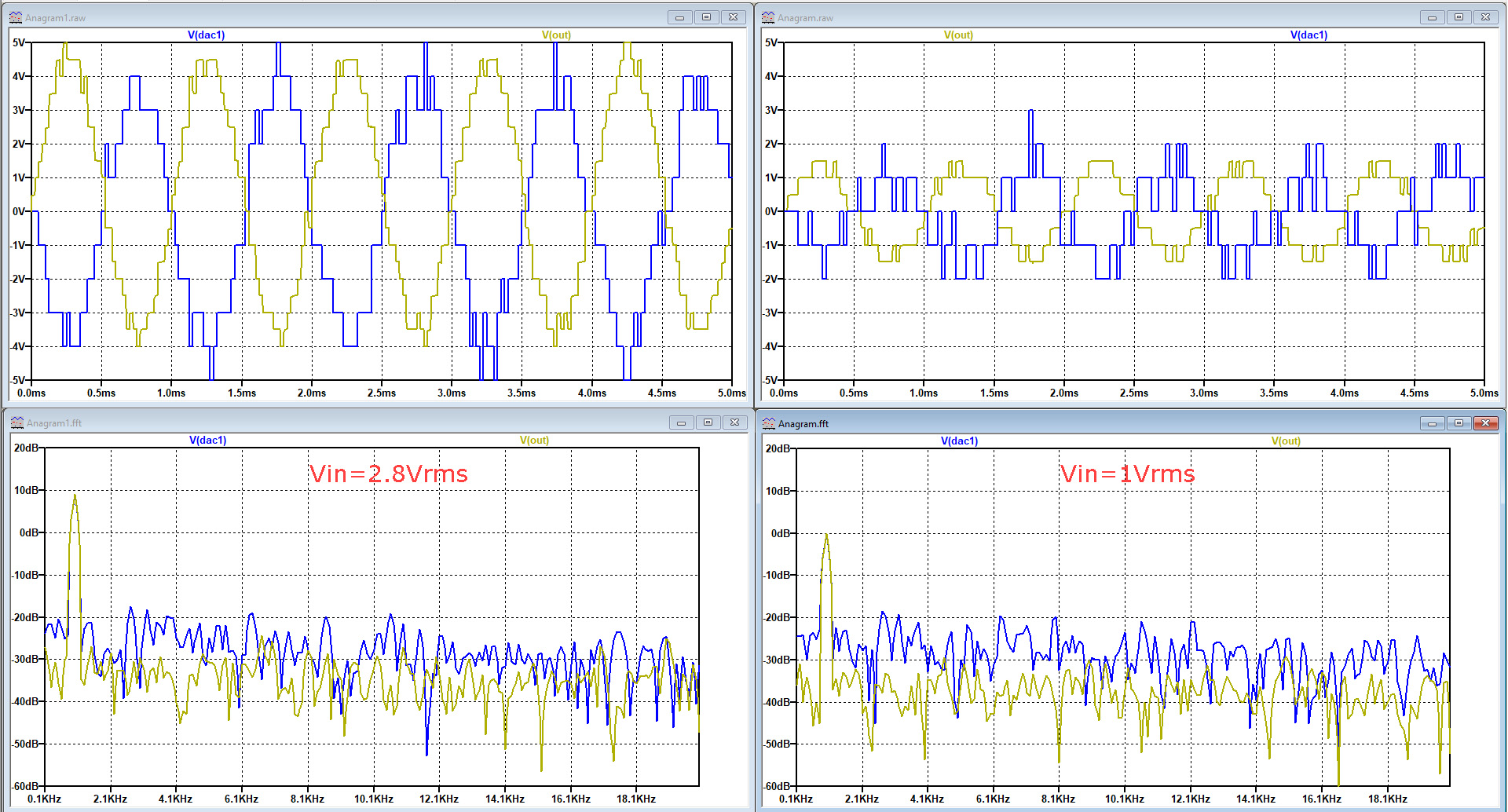

I've put the Anagram technique in a LTSpice sim, where I constructed Tri dither from two independent square dither sources each having +/-0.5 LSB amplitude, in the diagram Tri+ and Tri-.
Both where offered to DAC's running at 40Khz.
If I understand the schematic correctly, your dither has a probability density function consisting of four Dirac impulses rather than a triangle (only four possible values instead of a continuous distribution). That probably explains the distortion in your later simulation.
Marcel,
What I did was generating two uncorrelated white noise sources, each quantized to +/- 0.5 LSB, Vrms=0.5 LSB
The sum of both noise sources that were used, was regarded to be Tri dither, having a rms value of 0.71 LSB.
If this is not good enough, please tell me what to change.
Hans
P.S. Should I use the un-quantized dither instead ?

Yes, the unquantized uniform noise with the levels adjusted such that each is 1 LSB peak-peak (although 1/2 LSB may also work in this specific case, see my appendix A).

Problem solved, you are amazing.
I used continuous dither instead of quantized dither with a an rms value of 0.5 LSB.

This is what I get when using non quantized dither with an rms value of 0.5LSB.
What a huge difference this makes with quantized noise !
Again with resp. 1Vrms and 2.8Vrms input signal.
To my surprise noise level now only drops by ca 10db compared to a single Dac.

So, the simulation predicts the Anagram technique reduces DAC harmonics to the same degree as does non-subtractive dither, but additionally restores about 10dB of SNR which is otherwise scarified via non-subtractive dither?
Hi Ken,
So it seems.
With no input signal, the difference between the two is still the same 100dB as shown before, but the moment it detects a signal, difference goes to -10dB.

Okay, I think that I see.
However, let me ask my question a bit differently. Does the 10dB difference essentially represent the full contribution of the dither noise? In other words, is essentially all of the added dither noise being subtracted by the process?
Why 0.5 LSB RMS? Normally it should be the sum of two uniformly distributed random signals of 1 LSB peak-peak, 1/2 LSB peak, 1/sqrt(12) LSB RMS each, so the sum is 2 LSB peak-peak, 1 LSB peak, 1/sqrt(6) LSB RMS.
In this specific case you can use half those values if the rounding of the sum of the signal and dither is done as in the appendix of my document. You can also use some integer multiple of the normal dither levels, if you want to randomize the errors due to DAC dynamic non-linearity.
Hi Marcel,
The noise that I used was only slightly higher with 0.5 LSB rms instead of the 0.4 LSB rms that you mention [= sqrt(2)*sqrt(1/12) LSB rms].
So I reduced the noise to this level, but was unable to see a relative difference between the two noise spectra, but the absolute level went down by 1.9 dB for both.

Something I only realized a few minutes ago, after thinking about Hans's -100 dB:
Noise modulation is inevitable with this scheme. When the input signal is constant at 0 or any other integer number, the signal+dither will always be rounded in the same direction for the positive and negative DAC, so the noise will disappear with integer input. That also means there is no point in using triangular dither, you might as well use rectangular. (Mind you, the dither level is critical for rectangular dither.)
Maybe one can come up with some mixed scheme, large common mode dither to get rid of quantization distortion and to randomize DNL-related errors and small differential dither to reduce or get rid of noise modulation?
I think 1/2 LSB peak-peak of uniformly distributed differential dither can take care of the noise modulation, see the bottom of page 7 and top of page 8 of the attachment.
