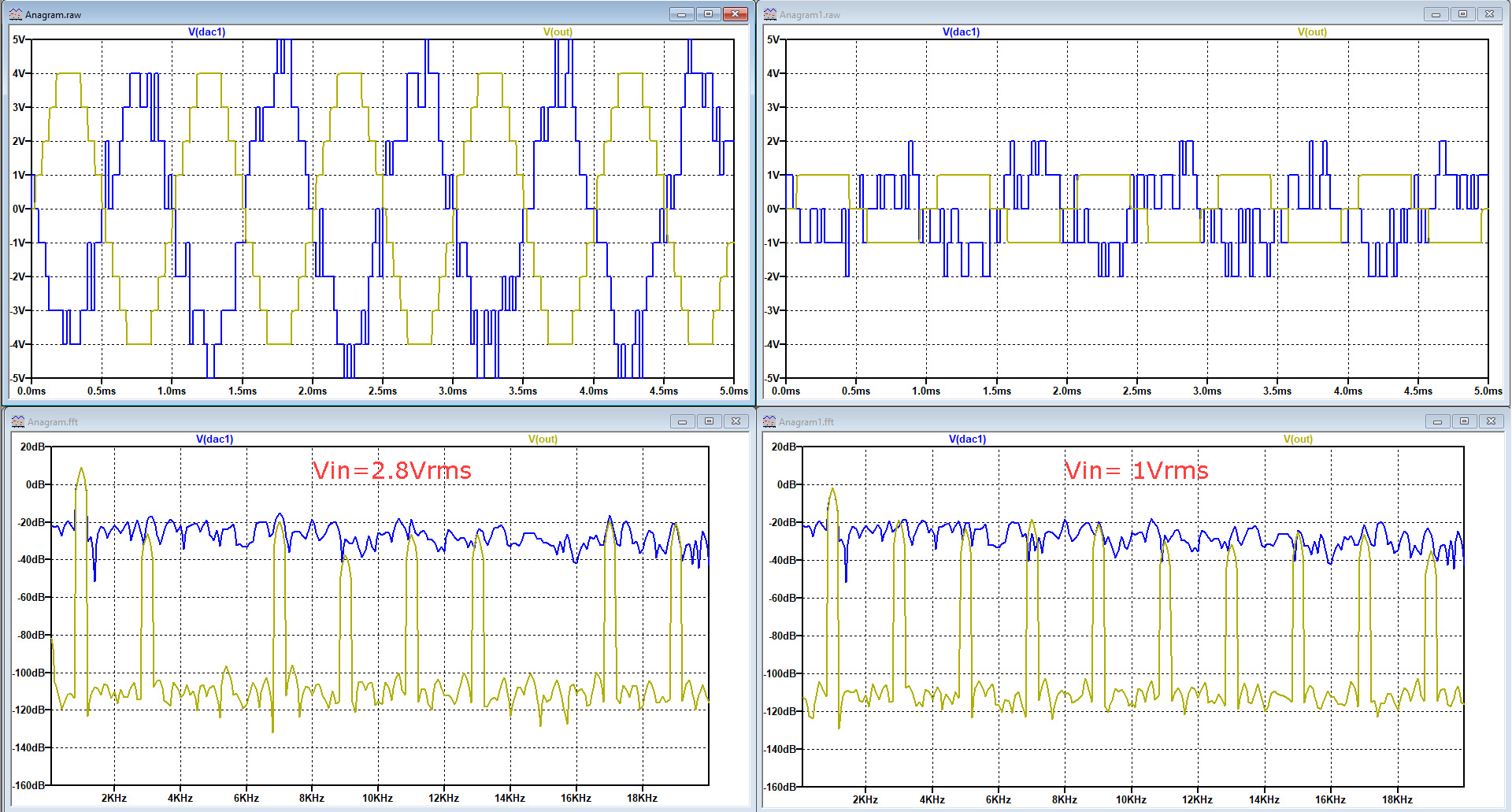

Here's the result of the Anagram simulation with an 1Vrms and a 2.8Vrms signal, mixed with Tri dither. Used step size for the LSB in this sim is 1Volt
What you see is the output of one of the two Dac's in blue and the Anagram result in green after subtracting the common mode dither from both Dac's.
Harmonics do not go down when removing the common mode signal, but the noise drops by almost by 100dB in this case.
Also interesting to see between the two different levels is that the harmonics are staying at the same level, while the main lobe increases proportional to signal input.
The point however is that an LSB, instead of having the 1V step size as used here, has a much lower level like 85uV for a 16 bits Dac with an output of 2Vrms max.
But added to this comes the uncorrelated noise from the several Dac's, the noise from the op-amp removing the common mode signal and the accuracy of the four resistors surrounding the op-amp.
So in a practical situation, the 100dB will be hard to achieve, but for 16 bit Dac's it must be possible to get 40 to 50dB noise reduction with 0.1% resistors which is already significant.
Looking from a different side, I don't know what is to be preferred, a signal just visible above the white noise instead of the many harmonics without noise.
Hans
