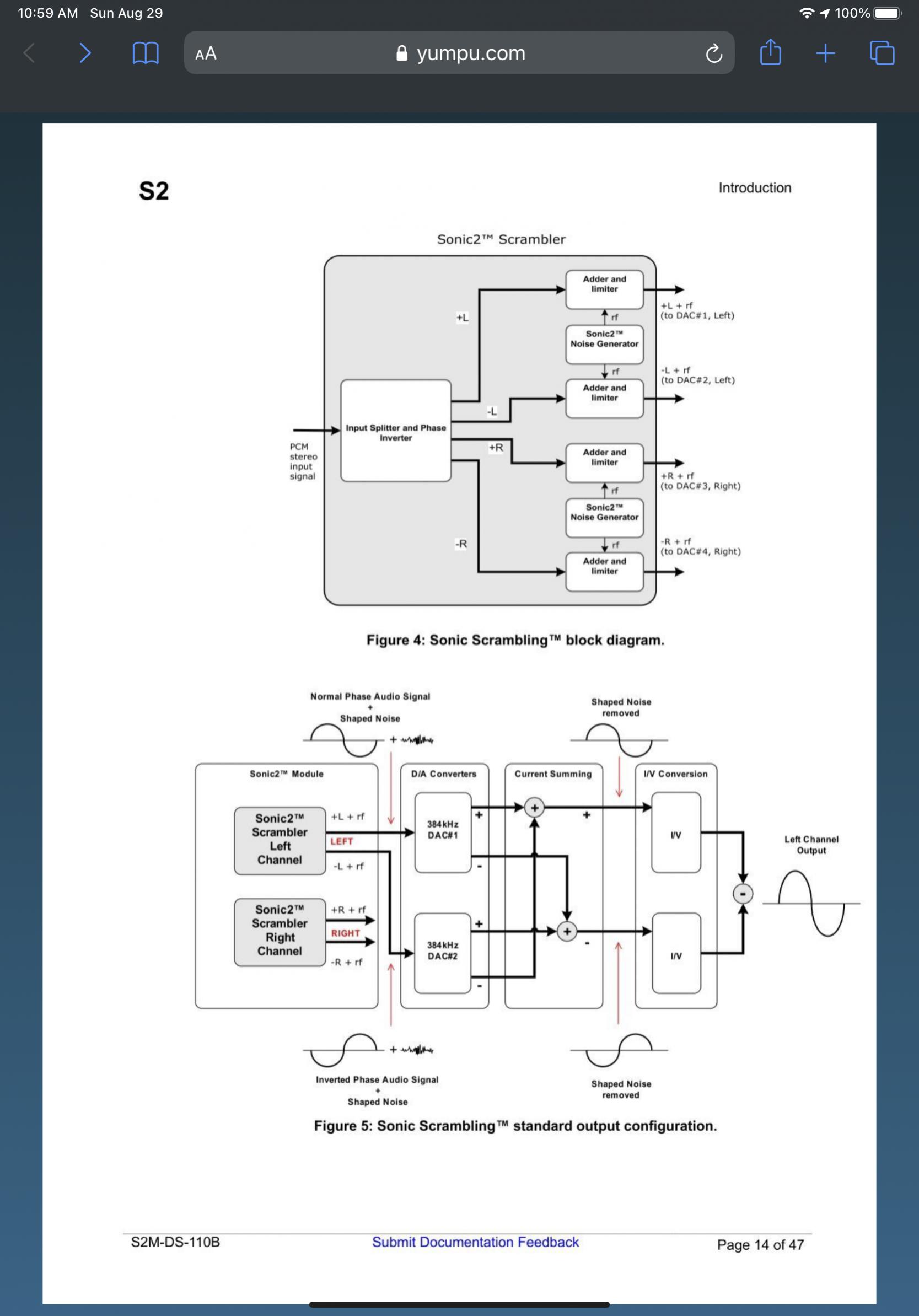

You can easily remove dither by truncating word lenght, no DSP required. However what would be a reason for? I think you confuse dither removal with error randomisation.

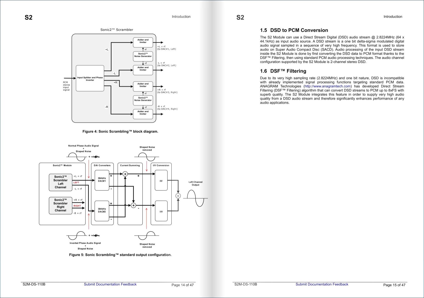

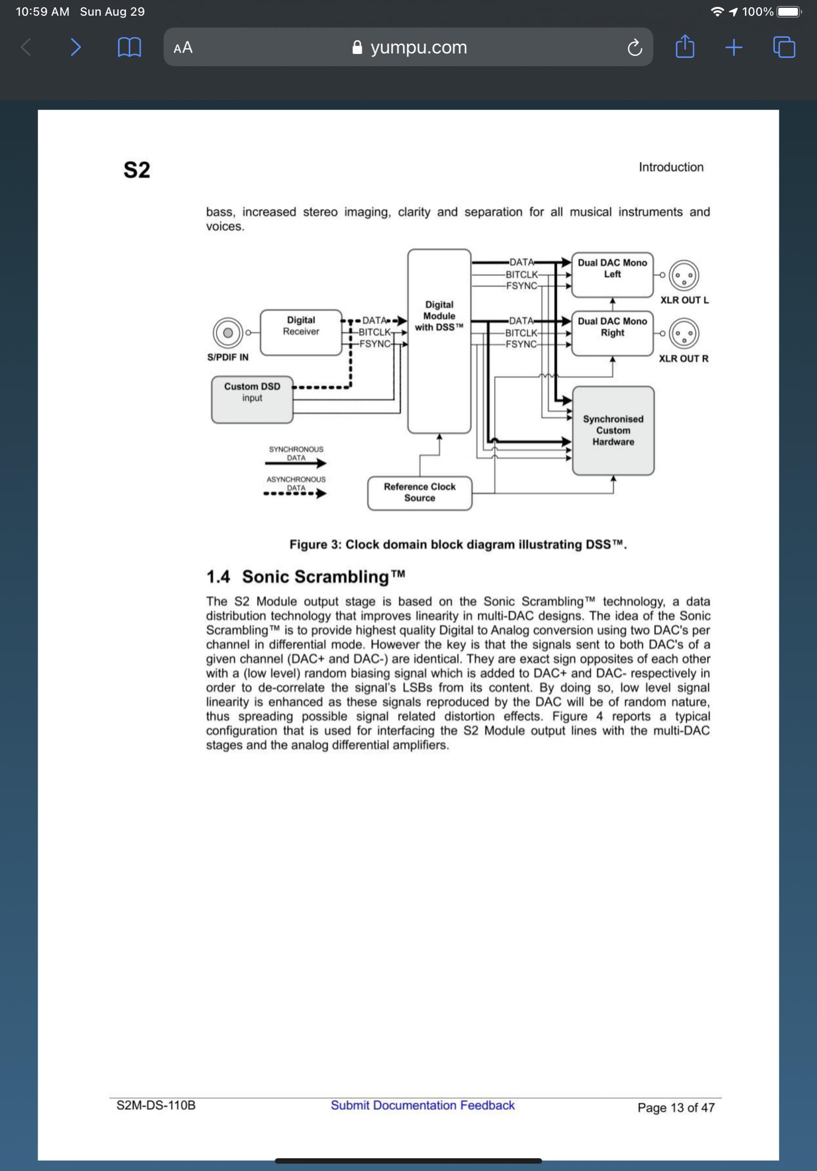

That is not how Sonic Scrambling works (as shown on page 14)... i.e according to the diagram, the dither noise is removed by relying on CMRR principles.
from page 14..

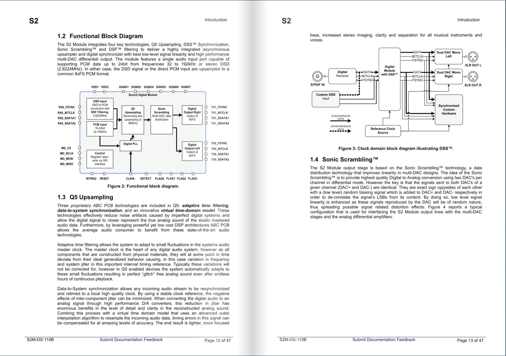

Can that D/A Converters section remove the dither in the digital domain..?? Or, the dither removal happens at the I/V Conversion stage?
I think it's the latter. If I'm right, the amount of dither removal will depend on the CMRR capability of I/V Converter...(OP amp) which will vary widely; in other words, that dither will never be removed to a satisfactory degree, which may explain why added dither actually sounds bad.
If I'm wrong, how can two DAC's (independent DAC's within the same die) ever be able to remove common-mode dither??
On the first thought, this is right.
On the second thought, an added dither may be exceeding linearity errors. Such large amount will be sefl-canceled after conversion, leaving (I expect) linearity errors randomized. Clever. It can be sea weaves heard in the result.

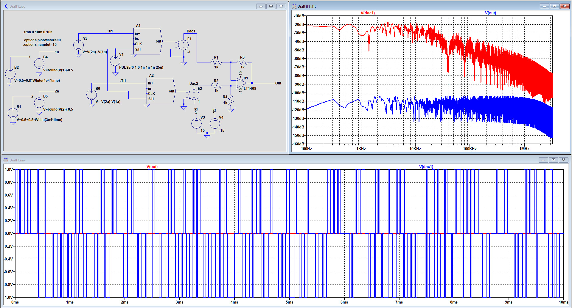

Hans, you've identify the exact question which I'm hoping that Marcel can answer. When dither reduces a DAC's distortion, does such reduction manifest within the DAC, or only externally by error averaging within a spectrum analyzer, or a listener's ears? Sort of like the old Zen question of; If a tree falls in the woods, does it make a sound if there is no one to hear it? If dither randomizes the non-linearity of a DAC, is the distortion actually reduced if there is no one to hear it?
If the Anagram technique were to actually work, it seems that the distortion of any given DAC could be removed by the application of however much dither amplitude is required, then have the original SNR restored by the their dither noise subtraction technique. Which makes me suspect that it may not actually work.
Hi Ken,
I've put the Anagram technique in a LTSpice sim, where I constructed Tri dither from two independent square dither sources each having +/-0.5 LSB amplitude, in the diagram Tri+ and Tri-.
Both where offered to DAC's running at 40Khz.
The common mode signals from both Dac's where processed by an op amp to remove the common mode voltage.
In the image below, you see the spectrum of one Dac output in red , versus the spectrum of the opamp's output in blue.
In the lower part you see the same signals in the time domain.
The added noise in the digital domain is indeed effectively removed in the analogue domain, so to me it seems almost as if nothing was added at all.
Hans
