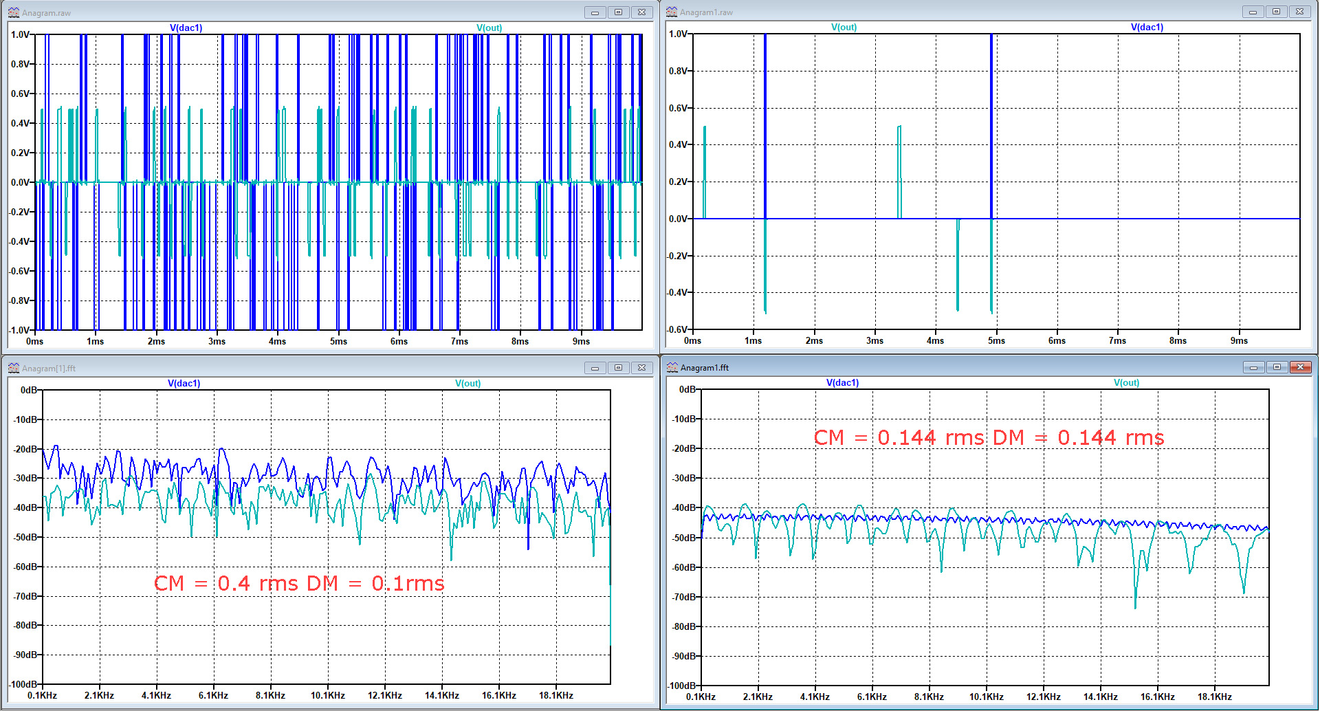

Knowing that LTSpice is not perfect and that {White} is not exactly uniform, that's why I have used {1.13*White} from the beginning to get the same 0.288 rms value as an RPDF.
So, to get some feeling of what your proposal would bring despite the above restrictions, I took in one case what I used before: TPDF CM noise of 0.4 LSB rms and RPDF DM noise of 0.1 LSB rms. All three noise sources uncorrelated.
The second case was CM and DM both 0.144 LSB rms RPDF and both uncorrelated.
See image below to illustrate what happens when offering a DC signal.
From the corrupted Dac signal of the second case at the right, the diff amp could not repair what was intended to get as in case 1 at the left.

The common-mode dither in my calculation has an expected value of 1/4 LSB. Does adding 1/4 LSB of DC to your common-mode dither help?
If not, I'll see if I can get it to work in Free Pascal.
Do I have to shift the DM noise also ?
Hans
P.S. With the 0.25 LSB shift, it's quite a lot better, almost the same as with 0.4 rms Tri.

No, just the common mode dither.
The idea is to shift the points where the two quantizers switch as a function of the input signal in opposite directions, so they work staggered.
o.k., I’ll show you the result later this afternoon.
Compared to the other sim with DM band noise around 10Khz, the spectrum is slightly raised below 1Kz, but that may be a LTSpice artefact.

Marcel,
Here you are with the LTSpice results for your proposed noise setting.
DM 0.144 rms RPDF+0,25 offset and DM 0.144 rms RPDF.
As you can see it works, although showing a slightly raised spectrum below 10Khz for DC input.
As mentioned I have used 10Khz 0.1rms BPF RPDF DM noise.
Question is, although mathematically correct, why sitting on the very edge of what's still possible, while this topology is completely insensitive to the CM noise level.
Even 2.0 rms CM noise still gives the same output spectrum, so there's no need at all in trying to be economical.

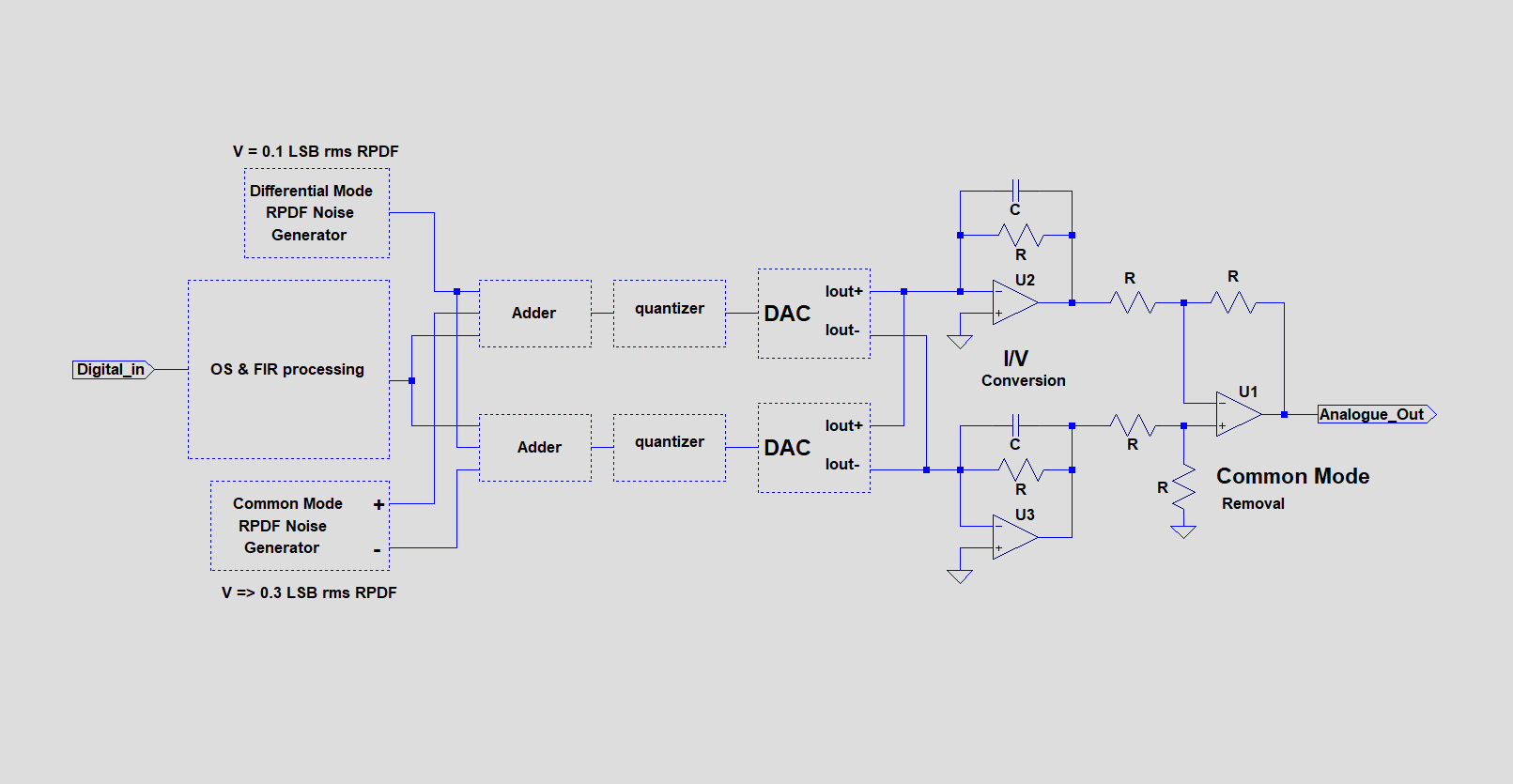

Can you live with this diagram ?
Hans

That's perfect, Hans.
Exactly what I was hoping for.

What function are the quantizer blocks, located in between the adder and the DAC blocks, performing? I normally associate quantizers as being inside the DAC unit, which these aren't.
When doing the FIR filter computations, a much longer word length is used to avoid excessive noise addition.
PGGB is using 64 bit, but it could also be 32 bit.
The same applies to the noise generators, they will have to produce much longer word lengths.
When going to the D/A converter, the used extra long word length has to be reduced to 24bit for most Dac's.
This step is what happens in the quantizer, rounding and truncation.
