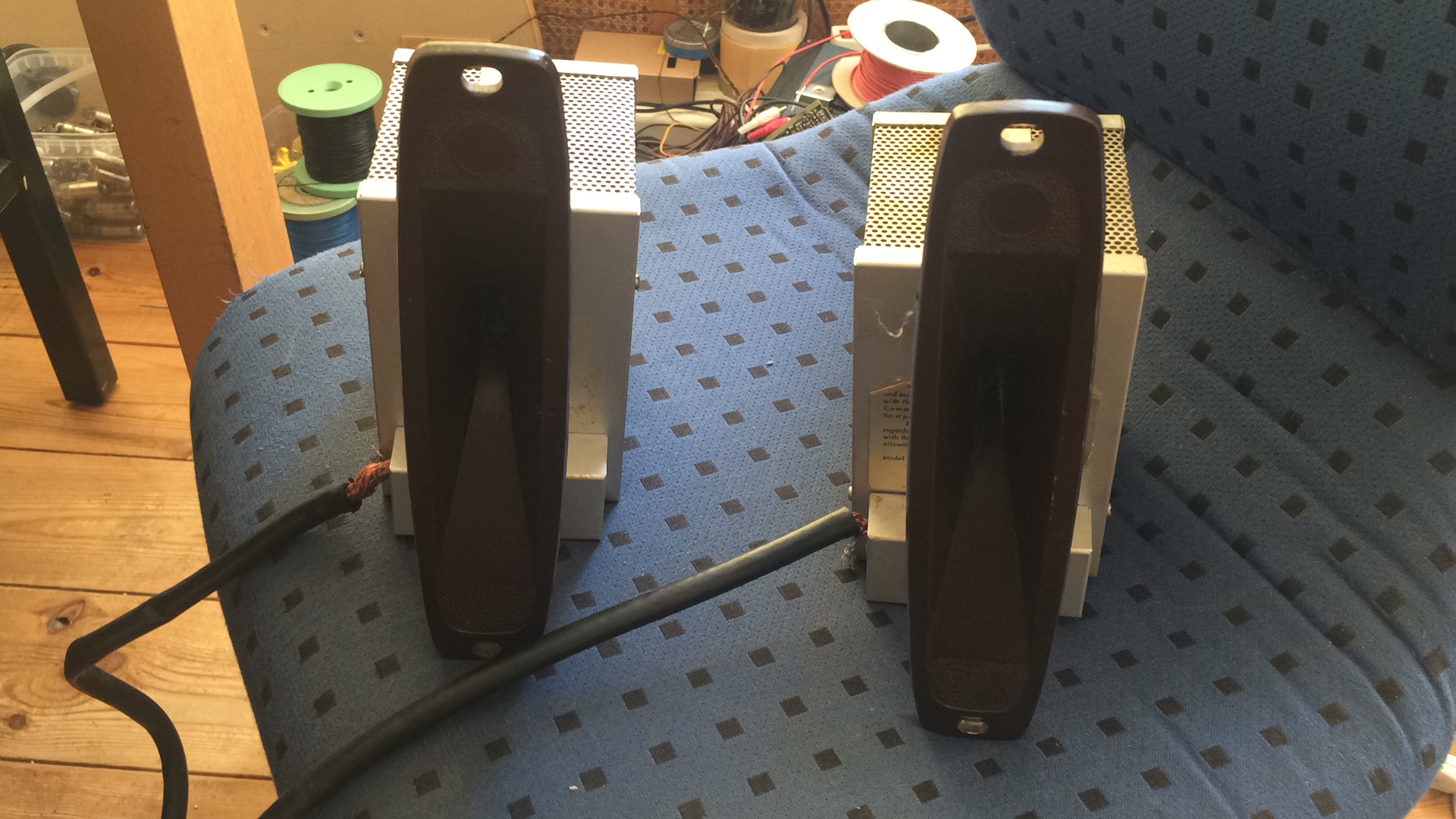

MagicBus' Disconnected Tweeter Experiment
For anyone conducting the disconnected tweeters experiment suggested by MagicBus, I would expect that you will obtain one of the following five results:
1) There is no difference in character between the two, but both modes now sound like OS.
2) There is no difference in character between the two, but both modes now sound like NOS.
3) The classic character difference between OS and NOS remains apparent, just without much treble.
4) There is a difference in character between the modes, but now NOS mode sounds like the best of OS and NOS combined.
5) There is a difference in character, but neither mode sounds like OS or like NOS. Which could easily be a deceptive subjective result, as the treble has been removed from playback, leaving the system tonally imbalanced.
Of those five results, the one I would most expect is #3. The most intriguing would be #4. Which is probably the most unlikely. Result #3 or #4 point directly to the next logical area of suspicion. Which is, the means whereby image-band suppression is being implemented, especially with regards to digital interpolation-filters.
