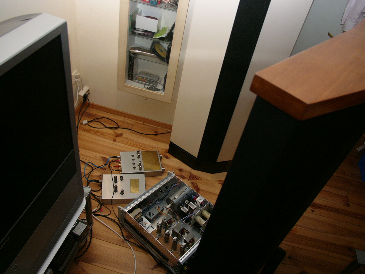

Bring it on !
I have the speakers to test it with (no XO, from subsonics up...)
In the top end i have added some super tweeters but these can be "switched off"

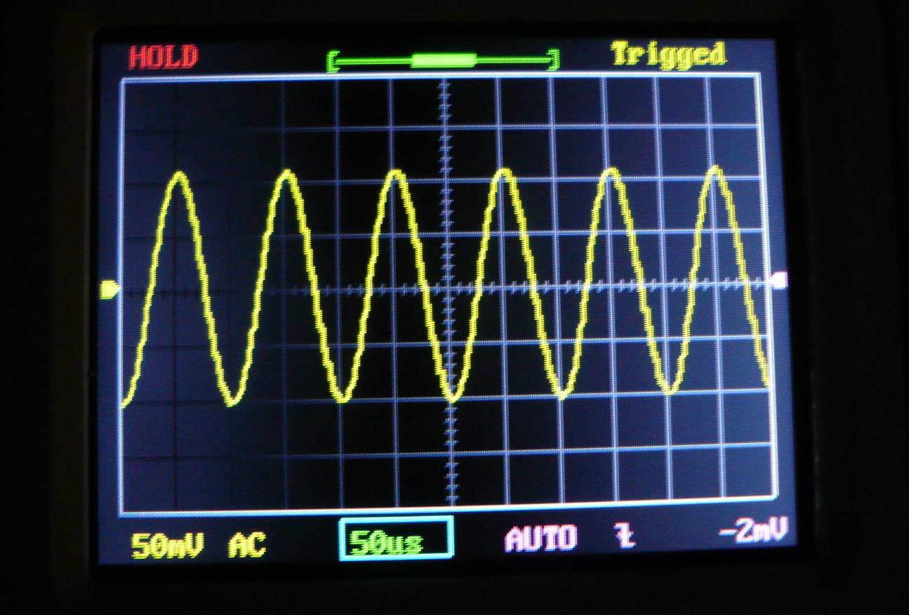

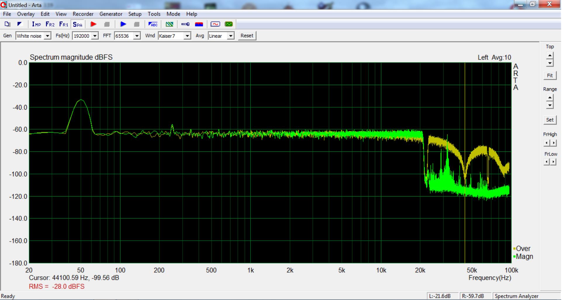

Time to report! First of all, my DAC was rebuilt and this resulted to a general upgrade that could easily fool me if it wasn't the setup mentioned above... Before anything, I took some basic measurements not calibrated, just for comparison. Frequency response and 10kHz sine NOS vs OS. No, they do not make big difference soundwise, at least in my system... Especially with tweeters disconnected mostly you can tell that the output switched by the relays' "click". My system - the "magic bus"- is fully DIY and it is built to satisfy my preference for a big, articulated sound stage. I'm so familiarized with this that I can detect any change, yet switching from NOS to OS I can't see anything happening. Maybe a subtle difference for content around 1kHz, not for more lower or higher frequencies, which becomes just a bit easier to follow with the tweeters on again. More easier with headphones. But then another problem comes in: there is not much music above 10kHz and I would dare to say even 8kHz. So I thought to use a test CD -Alan Parsons and Stephen Court-Sound Check. With a sine, the real threshold of audible droop is at 12kHz and the even more real limit of my 50 years old ears is around 16kHz... What works better to spot the difference is complex signal, white noise and square wave but only around 1kHz!

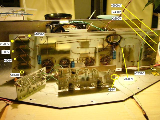

Actually i have never measured the speakers on the "range". Beware that i do not use any transformers so the frequency limit is not as you could expect from a "regular" ESL.
