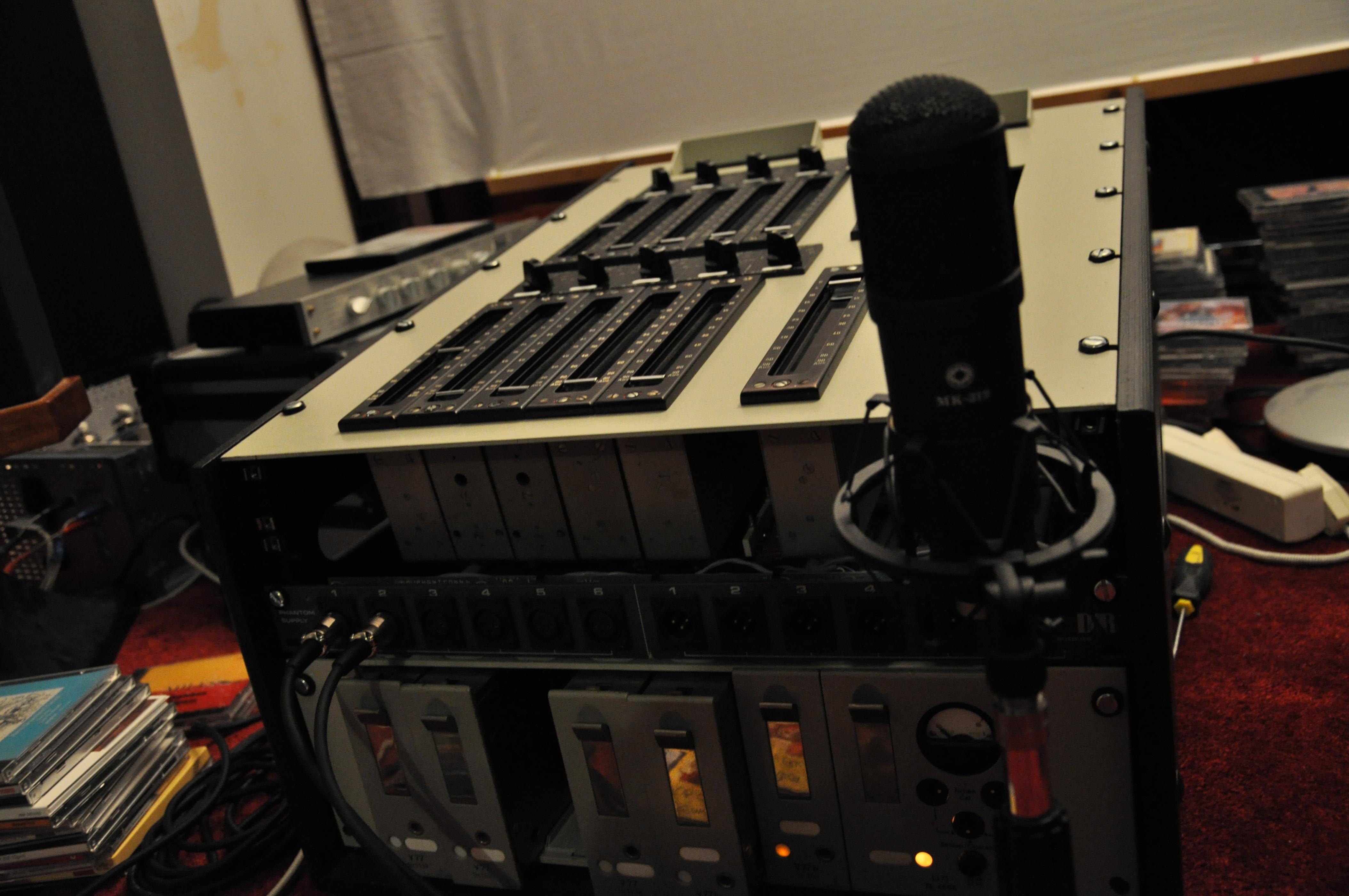

Then make you own recordings and compare (as i do ) !
I use a HD recorder with a separate PCM A/D converter (customized). Revox G36 2 Track tape recorder etc. Tube pro mixing console (top of the bill) and different mic's to play with.
Even the lowly portable Mini Disc recorder will do a better job then any analog tape !
For playback i use electrostatic loudspeakers driven with dedicated high voltage amplifiers (OTL) for outstanding dynamics and control.
The entire set is balanced from source to speakers (the nature of ESL).
