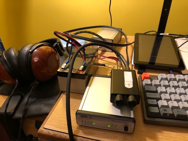

Right now, it's this beautiful, elegant, lifestyle system.
Kindle Fire (came free with broadband subscription) running VLC / FLAC files or Tidal, out to TDA1543 NOS DAC, out to a nice little head amp with an adjustable tone control.
Once the DAC has warmed up it all sounds lovely - what I imagine a decent vintage analogue system might be like.
