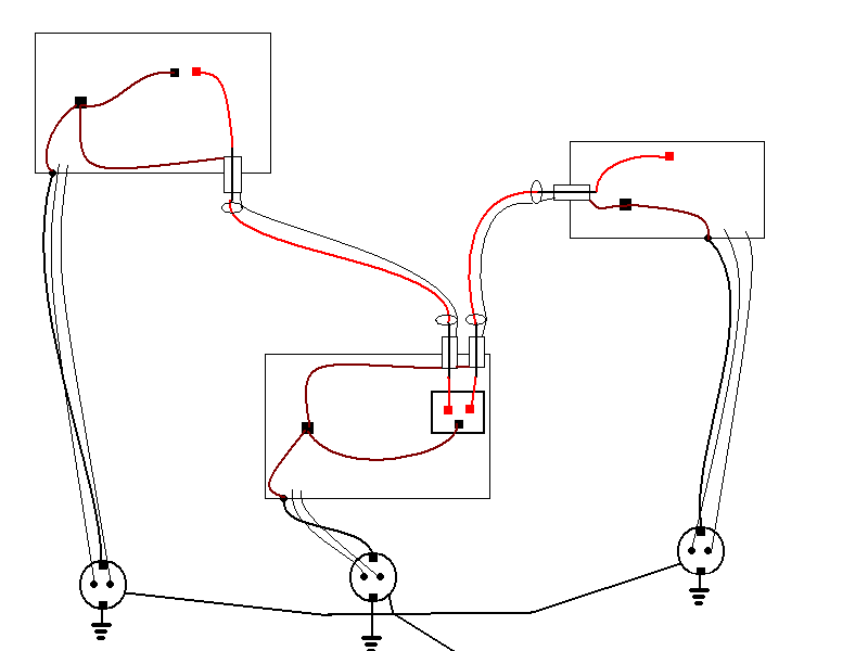

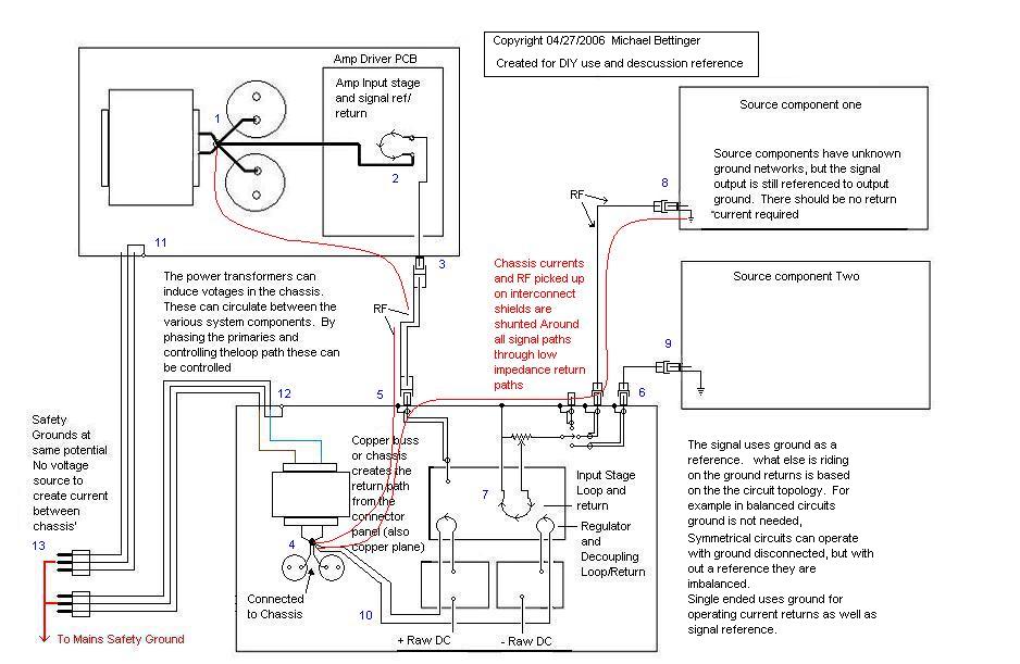

Cortez said:Hi Mike !
Obviously you didnt noticed my Q to you while I was OFFing, sorry! 🙂
Hopefully this image is readable and will answers some questions. Please give it some thought and suspend reality for a bit and assume it might work. I'll try to answer any questions to help clarify what I'm up too.
You might notice I try to route any returns from regulation and decoupling apart from the gain stages through their own low-Z path. This you can see in the previous images I posted.
Mike.
Well, I'm getting confused... 🙂 Unfortunetly I really dont get this.
- every wire is now just ground wire, or there is no ground wire from the source components ?
- are the sources safety earthed too ?
- in every component, the ground is earthed too ?
- what wires are shielded and what aren't and where to the shields are connected ?
Really sorry Mike, I'm trying to understand it, but isnt easy.
Cortez said:Well, I'm getting confused... 🙂 Unfortunetly I really dont get this.
1 ) every wire is now just ground wire, or there is no ground wire from the source components ?
2 ) are the sources safety earthed too ?
3 ) in every component, the ground is earthed too ?
4 )what wires are shielded and what aren't and where to the shields are connected ?
Really sorry Mike, I'm trying to understand it, but isnt easy.![]()
I'm trying here as well, thanks for the patience.
1 ) I just tried to depict mostly the signals and the grounds; focusing on the loops.
The circuitry (Amp driver PCB, Lineamp, line amp PS regulators) are basically blocks showing the input and it's ground, the output (which doesn't need a ground from the board).
The regulators, which show a raw dc in, an out to the line amp and a path through any on card regulation, bypass caps etc. back to the ground in to complete the loop.
The safety grounds, just between the amp and preamp to indicate there is no voltage potential if they are hooked to the same voltage source.
2 ) No, the sources are connected into the preamp safety ground by their interconnects. The red lines show the path of any noise currents picked up by the shield or chassis currents, which bypasses the signal loops
3 ) I'm not sure I understand your question here. I don't see a ground and an earth. I see every component having aground, or zero volt reference at one point at the transformer. Every ground ends connected to it through controlled paths.
4 ) I forgot the shields on the source components (sorry), but they would be the same as on the between the amp and preamp. The connectors are all bonded to either the chassis or a copper ground plane which takes a low-Z path back to the PS central ground. The interconnects inside the preamp show the shields which are bonded to the chassis at the jack only.
Amplifier layout and grounding is all about knowing where the power is flowing and where it returns and the path of the signal.
Hopefully this is getting clearer. I might get a chance to take a pic of my preamp to show a real world implementation. Time is at a minimum
But could have difference at the chassises already, due to interferences, couldnt ? Like an antenna, or capacitively.
But if a noise is travelling through the signal GND wire, why wont we hear it ?

Hi Cortez,
your diagram I can understand.
I have now lost count of the number of earth loops I can see in there.
I suspect it would suffer badly from mains hum.

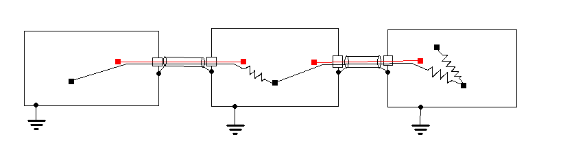

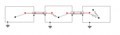

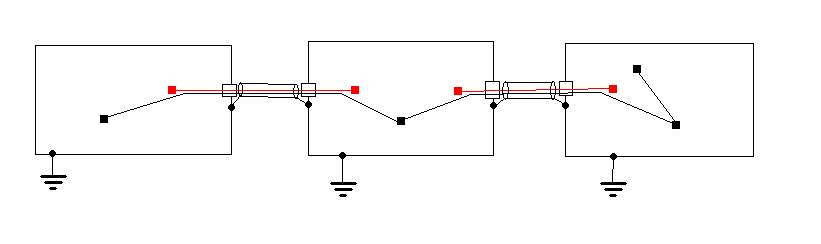

And what about a layout like this ?
- every chassis is earthed
- every cable is shielded, but the shields are only connected to the chassis, both side
- the signal grounds arent connected to the shields
- the gnds arent connected to the earth
- every signal ground goes firstly to the main GND, and not directly to the circuit
So the earth from the mains is a whole different and separate line from
our grounds, even so our chassises are earthed, and our signal cables are shielded...

Hi Cortez,
post88 appears to work IF you keep the safety grounds SEPARATE from all the other audio grounds.
Are we right?
Mikeb.
do this in the UK
IT MUST BE SAFE, no other choices.
Are we right?
Mikeb.
do this in the UK
and you will be breaking the law if the case has any exposed conductive parts that are not earthed. or it is designed/tested to meet the double insulated standard.In an earlier post I said that the only place that a safety ground should be connected is at the preamp, and I implied I did not feel the need for one at all. I'll leave it out of my next attempt.
Yes, thats important. I wouldnt mix safety earth, chassis and the shieldings with the signal, if its possible.
> Are we right?
I hope so... 🙂

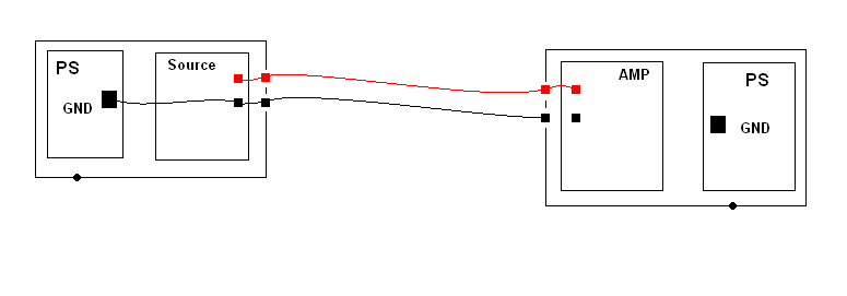

An even better solution would be this layout with a "ground-independent" symetrical signal-wiring... 😉
Otherwise I never use shielding anywhere, and have no problems
with noise, even with asymetrical wires, what I'm mainly using.
> Are we right?
I hope so... 🙂

Cortez said:[B
Otherwise what is your opinion on my last figure / idea ? [/B]
Your figure shows all of the grounds daisy chained from one gain block to the next. If you add the effect of the wiring and you have essentually the modified version of your figure that I've attached. All of the circuit support return currents, the garbage shunted around your circuit by bypass and decoupling caps, any RFI, etc. creates a voltage drop across the resistors I've inserted. The ground is no longer ground but ground plus whatever voltage is present (which is a form of unintended feedback). Think of it real terms. It means the reference used by both the input and feedback is comprized of zero volts at the transformer plus whatever voltage is developed along the way. This is way over simplified because we are not taking into effect frequency, phase, magnetic or electrical coupling and their impedance, the frequency related effects of the components, etc.
Not to mention that each stage in the chain is affected by the demands of the stages before and after it. Better stock up on decoupling caps...

Mike:
Please, draw me a very simplified figure like mine, to help me understand your statements.
I think 2 stage would be way enough, no need for a preamp yet, it just confuses me.
And you dont have to draw the mains, the whole PS, the rails, just the main star ground point, the
chassis, all the signal wires, grounds, shieldings and the connections between these.
Then we could discuss everything precisely. This should be max 4-5 minutes with paint.
For example I still dont know, what layout do you use modeled with this figure:
http://www.diyaudio.com/forums/attachment.php?s=&postid=900011&stamp=1145856645
#3 + #2 without #1 ?
Not exactly, every stage's chassis and shields are earthed individualy.
What resistors do you mean, where are they ? For example now, it would be
great to have a good figure to define exactly what we are talking about.
Otherwise the same doesnt appears in your design ?
