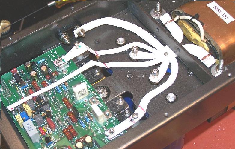

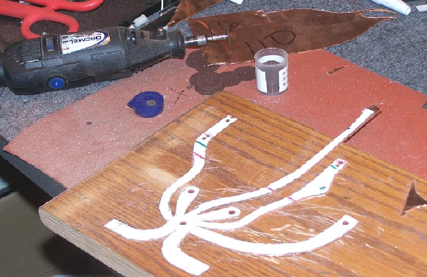

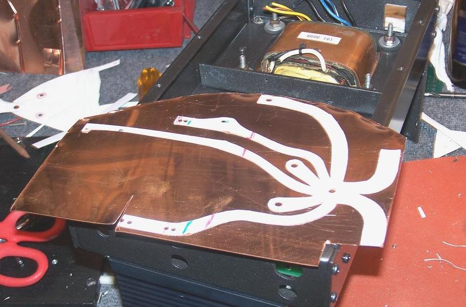

Actually what I use these days, but in an attempt to keep the concept simple didn't suggest, is copper sheeting cut to shape with a 409 cutting blade and a dremel. I'll see if I have a picture to attach. I make a template from thin cardboard to interconnect my various ground points then transfer it to the copper sheet.
I normally use .5mm thick copper and produce traces approximately 10mm wide for signal and supply returns and approximately 13mm for speaker return. It's all done freehand so it varies. I calculated it once and, if my memory serves me, the 13mm is approximately equivelent to an 8 gauge round wire.
I'll send a picture when I get home.
Mike.
Actually the sheet copper is approximately 1mm thick, the conversion from inches in my head didn't process properly.

First, there is no reason (sonically) you cannot use a safety ground. But, if you go back 25 years very few audio components used a three wire power cord, most designers relied on the power transformer for isolation from the AC mains. But that's just an observation not a suggestion. From my perspective the saftey ground can go to the preamp and the rest of a single ended system can rely on it to provide a that functionality. This is a whole other discussion on minimizing leakage currents between components and proper grounding.
Second, as you can see in the pictures I am using a star type ground but I'm using it to control return currents from functional circuit blocks, etc. not every stage.
I notice that both you and Cortez are not using metal chassis'. Is this a current approach? I've recently tripped across this and other forums. Obviously there is a very active group of audio experimenters. It's good to see this. I've been doing my own thing for my own amusement over the years.
The simple suggestion in my first post will improve any good design. The pictures show a extended version that works with my designs, I'm not sure how it will work with what I call capacitor farms or poor circuit layouts (circuits requiring complicated compensation) . No reason it should not, but experimenting should only be done by the strong of heart.
Enjoy, Mike.

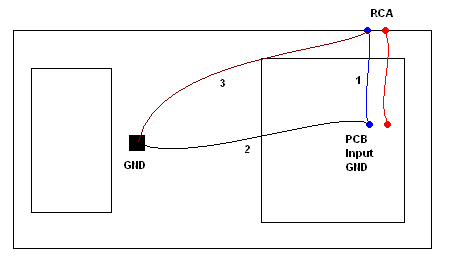

Hi Mike !
I guess your design has 2 specialites, so lets separate them:
1) Using flat cables, improves high frequency behaviour based on the skin effect.
Well, that sounds true, cause we have a much greater area to conduct at high freqs.
2) grounding the input directly from the RCA to the main GND
I attach a picture to ease the explanations.
Now lets forget the a cables have limits in freq, resistance, etc,
lets pretend they are ideal, so we can concentrate on their funcionality.
There is 3 GND points on this model:
- RCA GND
- Main GND (trafo, filter caps...)
- PCB Input GND
Based on this figure we could get all of the possible combinations.
So I think the conventional layout, what Mike wanted to improve
is when there are only the wires #1 and #2, because then noise
currents would create voltage on the resistance of wire #2.
And what Mike is using: #3 to route everything, noise and interference
from the interconnect cable's ground wire to our main GND reference
point with a low impedance path, and to the PCB we are using wire #1 (wire #2 isnt there).
Am I right ?
