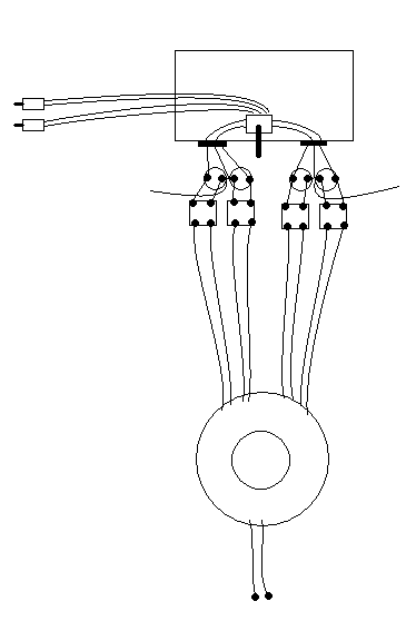

Hi Mikeb,
is that last diagram in post100 what you having been trying (unsuccessfully) to describe?
If so, then it shows the safety ground (earth) completely separate from the audio ground.
Diagram in post 100 - Mike reproduced Cortez's diagram but included resistors to illustrate problems with it.

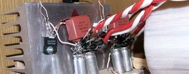

Here is my current GC layout. Its basicly everything OK, but
if I touch the heatsink on the top, a little humm appears.
Who knows how this works? Maybe in a capacitive way starting from the trafo,
and going all along the hole circuit, and then to me and back to the earth ?
(Otherwise nothing is shielded and earthed in this layout)

Andrew,
I've been thinking about this safety ground thing. It seems to me that a safety ground and system ground should be able to coexist without too much interference. I'm wondering if you (or someone) can post an example of how a basic
source/amp/preamp system might be hooked up in Europe. Nothing elaborate. Primarilly the connection of the SG relative to the signal/power supply grounds. I sort of know how it would be but then I don't want to assume... I'd like to experiment with this and see what happens.

Cortez said:Here is my current GC layout. Its basicly everything OK, but
and going all along the whole circuit, and then to me and back to the earth ?
Cortez,
I assume that GC refers to the Gain Clone amplifier I've read reference to in a few threads? Is there a schematic posted that is similar to the execution of your amp that I can look at? It's hard to comment without seeing what's happening in the input stage and the implementation of bypass/decoupling caps etc.
I see that you are using two bridge rectifiers in your supply. I've seen this a number of times and am wondering why one would use this instead of one bridge. I'm using it in one of my preamps, but then I was just copying another supply design that used it. Is there a reason that has been discussed that you are aware of?
Regards, Mike.
A safety earth has a long wire in the walls paralell to
a high voltage line, so its a great antenna, isnt it ?
If yes, why should we connect it, to our clean signal ground ?
Dont wonder, try it ! 😉 Its simple, it sounded better to me.
I have a very sensitive fostex speaker, it shows everything, but
of course the difference wasnt so huge... You really should try it.

re Cortez ground layout in Post108.
If one should decide to add a Thiel or Zobel network to the amp output , the return leg of the network should connect to the speaker return or direct to the power ground(P).
The short wire between P and S can be made co-incident.
A third ground either remote from P & S and nearby is for the Safety ground. The Safety ground can connect to P via a disconnecting network. NO PART of the AUDIO ground system, including the RCA input grounds should connect to the safety ground.

It's all becoming clear... There is no connection between the safety ground on the chassis and the signal ground! In my experience with audio equipment using a third wire safety ground, it was always taken to the chassis and connected to the power supply ground, sometimes directly or sometimes through a low value resistor. I'm not sure about today's audio equipment since I'm no longer in the business and it really doesn't matter to me. But you can now understand why I was getting confused.
I do have a question as to how shielding is accomplished since in order for a shield to be effective it must be referenced to the signal ground, but I'll assume it's accomplished separately and the chassis is not used.
I'll take a bit of time later to study the drawing and the picture. one question though, is the heatsink grounded and if so where relative to the chip. I'm also curious about the chip mounting plate and if it's grounded internally. to the chip ground. I have a data sheet at home.
Regards, Mike.
There can only be 3 possibilities for the 'sink and I'm not so sure it matters relative to noise pickup (except as mentioned at the end).
- Uninsulated chipamp (chip) where the 'sink tab is not at ground. For example LM3886 has it's tab at V- rail as does LM3875. Cortez' post 109 shows the LM3875TF though, the insulated package. I suspect though, if you took a drill and drilled through the epoxy/plastic/whatever, you'd hit the tab and find it's still at V- rail. So the 'sink sits at V- unless an insulator pad and screw are used.
- Insulated chipamp package, tab, where the 'sink makes electrical contact with nothing significant, fully insulated.
- Insulated chipamp package where the 'sink makes contact with the chassis... which is then at earth or signal ground (if not both as being discussed previously).
So it may not matter about the 'sink? That is, except it can be handy to ground it to provide the shielding if/when rest of chassis is, too and it's located such that it might be of benefit to do it.
Here on this pic:
http://www.diyaudio.com/forums/attachment.php?s=&postid=902542&stamp=1146155001
The signal ground is directly connected to the safety earth through the chassis, inst it ?
No, it isnt, thats what I will try next time.

The tab has capacitance related to the surface it is mounted to, this can couple the hum pickup from his body through to the chips internal ground. It's the same mechinism behind touching an open connecting cable and hearing a hum through the system. I believe I read that a TO-247 package has 10 -20 pf when mounted, I'd have to dig through my files for an exact number. To test this he could ground himself to say an input ground and then touch the heatsink. If it diminishes then the noise is definitely a grounding issue.
I'd put a voltmeter between the two points and make sure their at zero before trying this, although they should be if the tab is insulated.

Cortez said:> There is no connection between the safety ground on the chassis and the signal ground!
Here on this pic:
#1 is is connected to the chassis (although I now realize I didn't spell it out) and the SG is connected at #11. Also in the preamp #4 is connected to the chassis and #12 is the SG connected as well.
In your image there is no connection, or am I confused again?
Mike.

MikeBettinger said:The tab has capacitance related to the surface it is mounted to, this can couple the hum pickup from his body through to the chips internal ground. It's the same mechinism behind touching an open connecting cable and hearing a hum through the system. I believe I read that a TO-247 package has 10 -20 pf when mounted, I'd have to dig through my files for an exact number. To test this he could ground himself to say an input ground and then touch the heatsink. If it diminishes then the noise is definitely a grounding issue.
It could be important to consider what specific parts and mounting were used to achieve 10-20 pf.
His being the TF package, may have a bit thicker than a mica insulator. I find it hard to believe that there could be `10-20pf through a silicone mat type though, being quite a bit thicker.

Mike:
But its so obvious that the 50Hz mains can go through the whole "trafo,
diodes, caps, GC, heatsink, me"-chain, and cause an audible humm ?
I just dont get, where this "humm circuit" is exactly created.
Nope, on my there isnt any connection between any ground and
the safety earth, its completely separated, but we talked about
your layout, and there is a connection, namely 0R, the chassis.
Or I am confused now ? 😀
Andy:
Thank you for your tipping, will try these !
> Why do we care though if it picks up hum if he's touching it?
I am just interested in this phenomenon, thats all 🙂
Andy:
