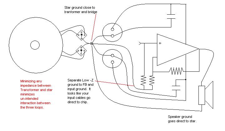

Hi Mikeb,
re diagram in post126.
I would take the smoothing cap commons to the rectifier commons and then connect the plus and minus commons to a charging point ground (power ground) to help avoid mixing the charging pulses and attendant voltage spikes from contaminating the star ground. Then connect the power ground to the star ground.
There is absolutely no case for taking the charging pulses through the finite resistance/impedance of the star ground.
My problem is in advising where the decoupling should go. Do the two decoupling returns follow the smoothing caps to the +&- commons or to the power ground or leave them connected to the star ground. What do you think best meets your philosophy?
Any other views?
Any other views?

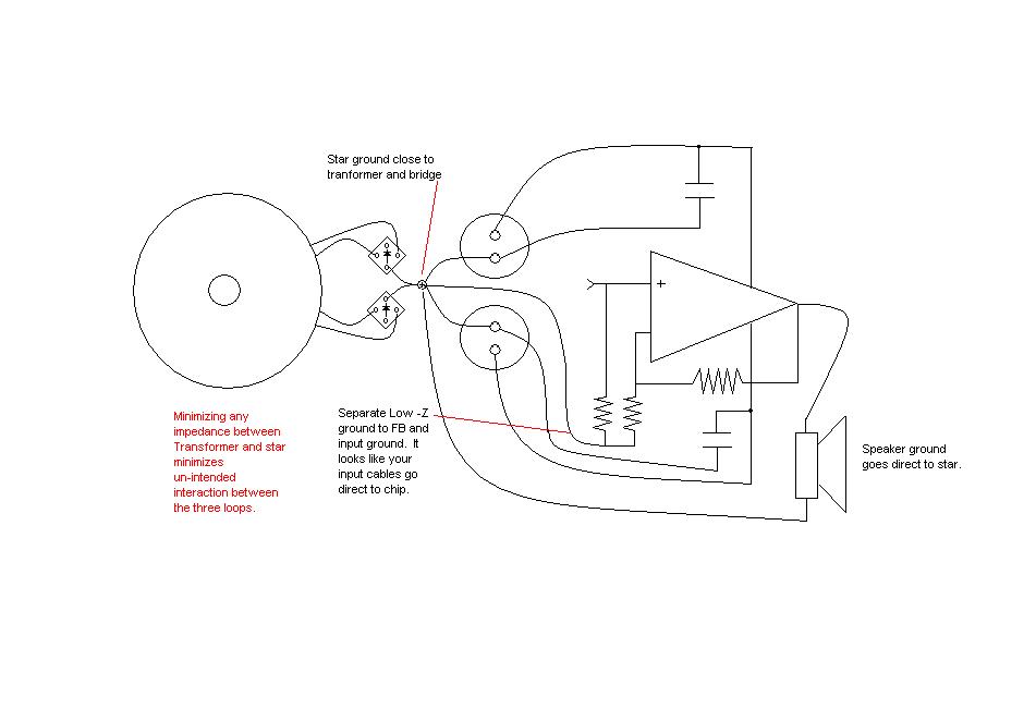

AndrewT said:Hi Mikeb,
Any other views?
Hi Andrew,
I would disagree, primarily because I have found that there is only one ground and that it has to be as close to the transformer and as low an impedance as possible. I you think in terms of a power loop that leaves the positive (or negative) side of the transformer, it eventually ends up back at the opposite end of that winding. There is no separate reference for the signal returns, charging currents or noise filtering. If there are separate ground islands (as I'm interperting your suggestion) there has to be a connection that brings it all back to the transformer and this would be the weak point.
I create a star point and then return the individual loops back to that point. If it's beefy enough (I believe that's a technical term somewhere) there will be little drop or variation or interference between the various demands of the amp.
If you examine the images I've posted early on you will see the way that I've implemented this. You can note that I take my copper buss right to the windings coming out of the transformer directly to the star which is also bonded to the chassis. from there there are separate loops as required.
The power rails are handled in a similar manner as well as the board layout. It's the loop that matters.
As for the decoupling caps, they are part of the power supply loop and should go back to the filters. I don't need or have any. The heatsink is grounded at on point to the chassis, which is also visable. The mounting screws are isolated, which also allows the sink to float as it expands and contracts.
Just a suggestion, something at little different to tryout.
Mike.

AndrewT said:Hi Cortez,
here's my slightly modified grounding showing the smoothing caps connected straight to the rectifier. Then the rectifiers connected to the new Power Ground and finally the Power Ground to the Central Star Ground (clean ground).
Hi AndrewT,
I'm not disagreeing here to be a jerk, more because I have found this to work differently.
Firsts I don't see the reason in connecting the filters together because there should be no currents between them.
Second, your logic concerning the charging currents is sound if that is all that is happening. What these traces also have to deal with is the output stage sinking power reflected back from the load, essentually backwards through the supply filters , once again , to ground. These can be substantual at high power levels. The wires between the filter/bridge combo that you have added now reflects these currents and adds them to the ground reference to the input and feedback.
I don't have time to modify the drawing now, but can discuss more later.
Mike.

AndrewT:
> I have never recommended tying a star ground into that common plate arrangement.
I know, I recommended it. 🙂
> Do not mix the order by putting some clean returns in between dirty returns (Zobel, decoupling, etc.).
I would put the speaker GND near ro the rectifiers, and the signal GND near to the the main caps.
I think with a layout like this, we have a good grounding in both cases:
when the power is provided by the caps:
the signal gnd is near to the caps, so the high speaker current doesnt affect it much
when the power is provided by the trafo:
the signal gnd has a very low impedance path to the rectifier too through the plane,
so they 2 havent a common path just as its unavoidable, in opposite
with a conventional arrangement, when the main ground is in the
middle of the caps, cause in case the caps are charged, the ground
is rather at the rectifier, and the ground path is common for:
- charging current
- speaker ground current
- signal ground current
Or maybe we just should to use a lug in the exact middle of that plane,
and connect both ground to this point ?
But the voltage level can maybe swing on that point.
> output stage sinking power reflected back from the load essentually
I guess this is a very interesting thought !!
Imagine that the speaker stored some energy in a capacitive way, and after a while
it radiates this energy back to our system, and of course in the ground too.
But if the PS cant receive this completely, this means a finite but existing impedance
at the caps, so this current will appear in the signal ground.
Whats your opinion ?
> By touching the heatsink there appears to be a path back through the chip
Ok, but along the whole chain either through the trafo ?
Or if I had a PS with battery, touching the heatsink would cause humm as well ?
> This is why I wondered what would happen if you touched the
> main ground with one hand and the heatsink with the other.
I will try !
> Grounding the heatsink would most likely fix it
Also...!
AndrewT:
- charging current
