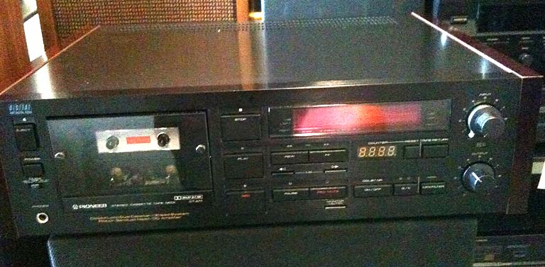

I repaired a smaller wattage variant of that Tandberg a few years ago.
I think it was a 25 or 30 watt/channel version, I forget the actual model number.
It didn't sound bad, for what it was, and the customer (an optometrist) was so thrilled with it that he offered me (after paying my hefty fee of course) a discount on eyeglasses, should I need a new pair someday.
He then purchased a "for sale" Pioneer upper model cassette deck that I had on display in the shop.
It had an "auto load" cassette door - you drop the cassette in, and the motor closes the door.
What a pleased customer he was!

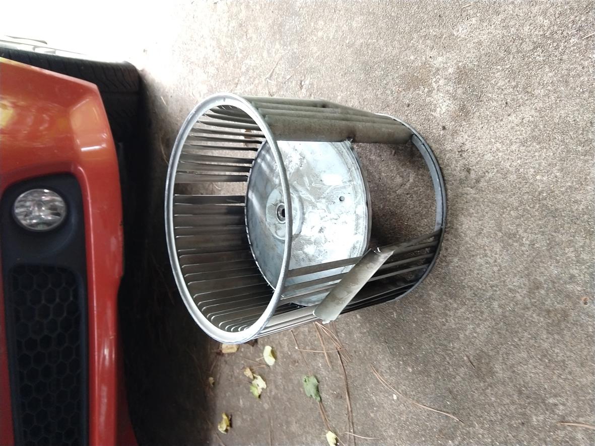

I've not seen one of these come apart before, but you can just imagine the racket it creates when it happens while running at full tilt.
Disintegrated Friday evening; I had it out Saturday morning in time to make the rounds of the supply houses where I have commercial accounts. None of them stocked anything this big.
Had to order it in, replacement should be here today or tomorrow. Surprisingly expensive for a bunch of cheap stampings pressed together. Last week of August, first week or two of September are the hottest time of the year here, so everyone went to the lake but me - I have business here every day this week.
edit: interestingly, the sole remaining U.S. factory for Rheem air conditioners is right here in town - but I can't get the parts here, I have to order them in!

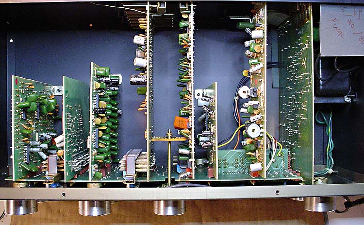

Chris, did that Carver have the "Sonic Hologram" stereo expander thing? That was certainly a mixed bag.Rebuilt a Carver C4000 preamplifier. Many bad solder joints, and those damned 4136 quad op amps. Now it sounds nice as long as you don't use any of those special functions.
-Chris
Jim - the C4000 had a shitton of features which the stereo sales guys at the time made a game of trying to remember and creatively rename.
Sonic Hologram
Autocorrelator (Noise elimination)
Peak Unlimiter ( dynamic range expansion)
The time delay function we never could quite grasp or demonstrate the effectiveness of/need for.
Remember, this was all done in the analog domain. Lotsa clever circuitry for sure, and controls/switches - definitely not a less is more design.
Sonic Hologram
Hi Chris,
Yes, exactly. The feature names drove me nuts as customers would always ask the tech (me) what it all meant. I guess it was good marketing, but more annoying to me than anything.
More op amps used per square inch than any other piece of home audio gear. Why they chose to use the class B output 4136 with it's stupid pin-out is anybodies guess. It pretty much killed any improvements. I was making my own adapter PCBs, then later we saw the Brown Dog adapters. Beats making my own.
