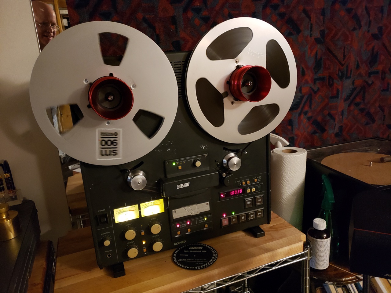

One of these (Otari MX-50N) purchased from a fellow in NJ that had rather extensive but random (salt) water damage. Fortunately it did not get to critical components.
Every single electrolytic replaced, a bunch of bearings, reel tables, and holders. Lots of cleaning with IPA and trouble shooting. I have a really pretty one, and a couple of others but this is the one I seem to use. It does sound pretty good actually, and gets a lot of use. (A few hiccups with the capstan motor deciding to run at 30 ips, now resolved.)
