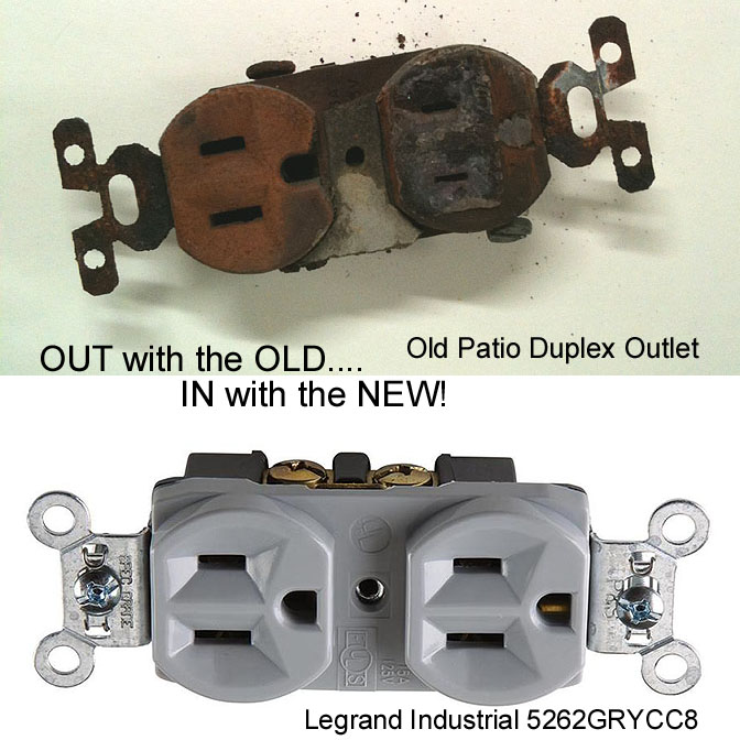

The electrical outlet on my patio had issues.
Plugs wouldn't stay in properly - making the job of mowing the lawn a big job.
A normal 20 minute job, turned into TWO HOURS... because the retaining screws were rusted, and one snapped off in the housing.
Had to drill it out and re-tap for a new 6/32 screw.
I chose the Legrand Industrial outlet because of its durability.
Installed a new water-seal gasket, caulked with some permatex, it's DONE!
Whew!
That old outlet sure looks beat. Hope the new one lasts awhile!
Yeah, the old outlet was likely put in in the 1970's, not sure, I've only been the homeowner for 15 years now.
It's seen its use, plenty, mainly for the lawn/garden equipment.
The new one is supposed to be designed for "heavy shop useage", such as in busy machine/auto repair shops and such.

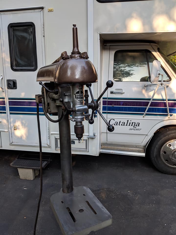

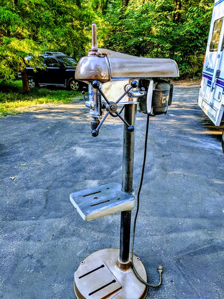

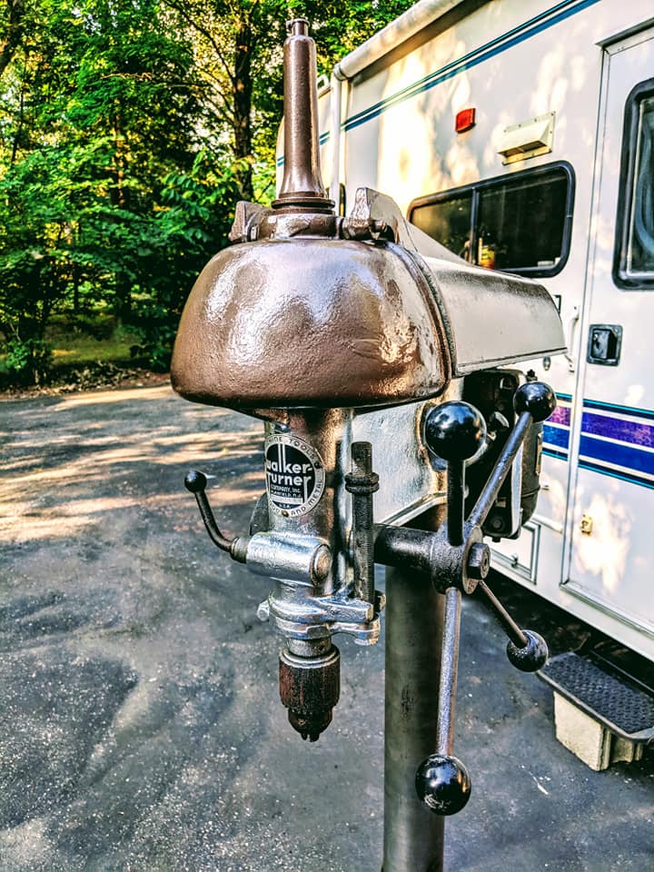

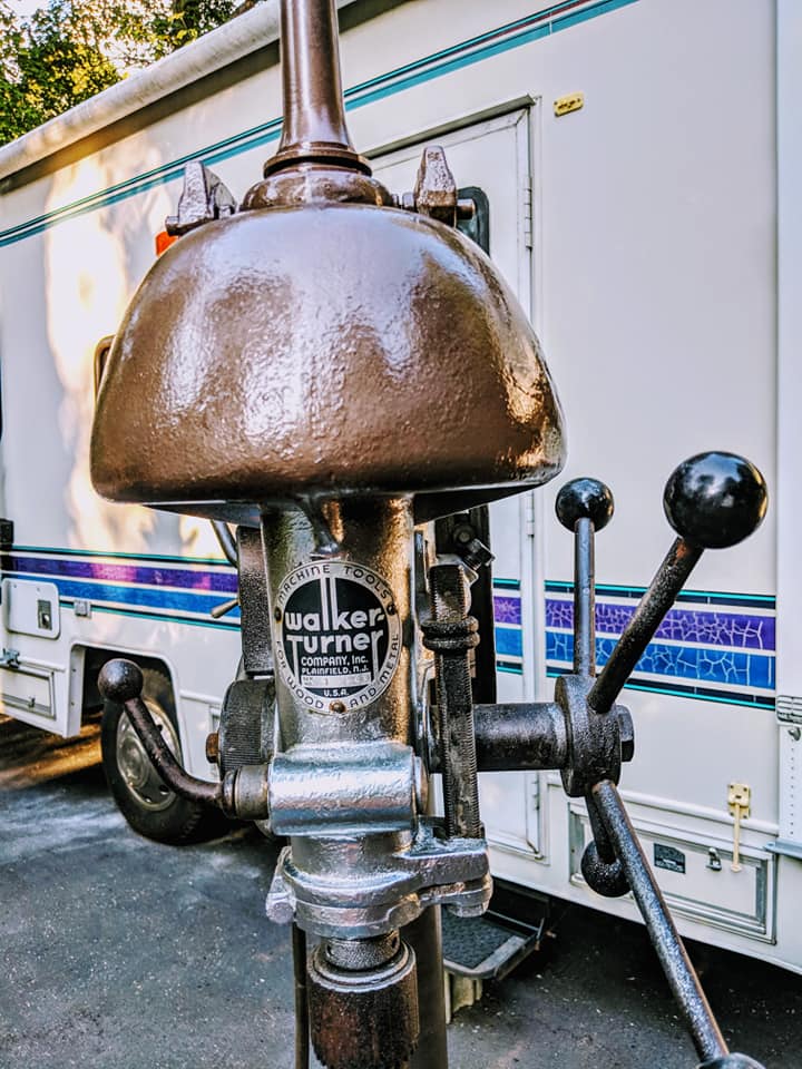

80 year old drill press
Walker Turner drill press... was covered with rust and grime, bearings seized, etc... rebuilt from scratch... looks like an alien and runs great. Heavy as hell!
