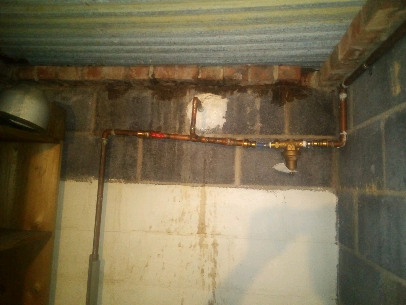

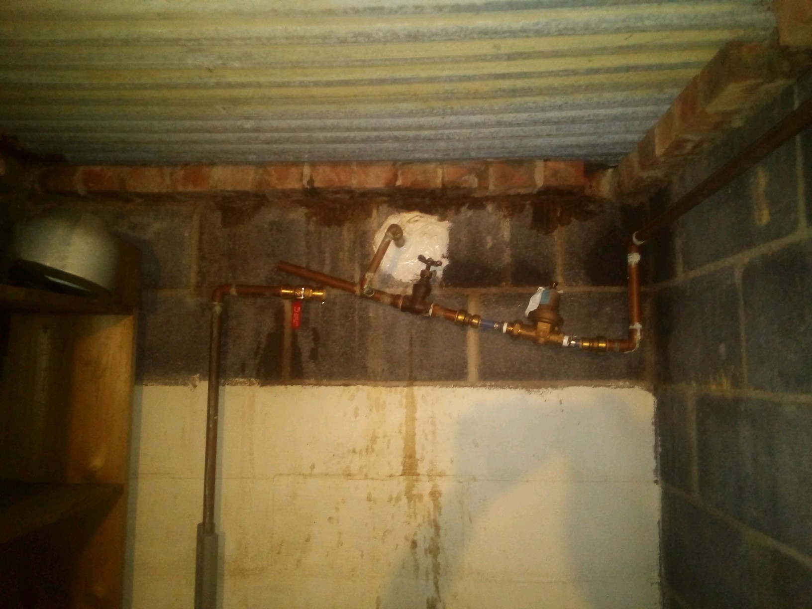

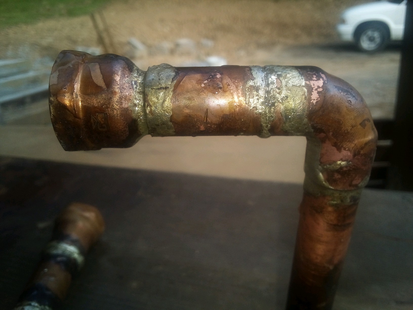

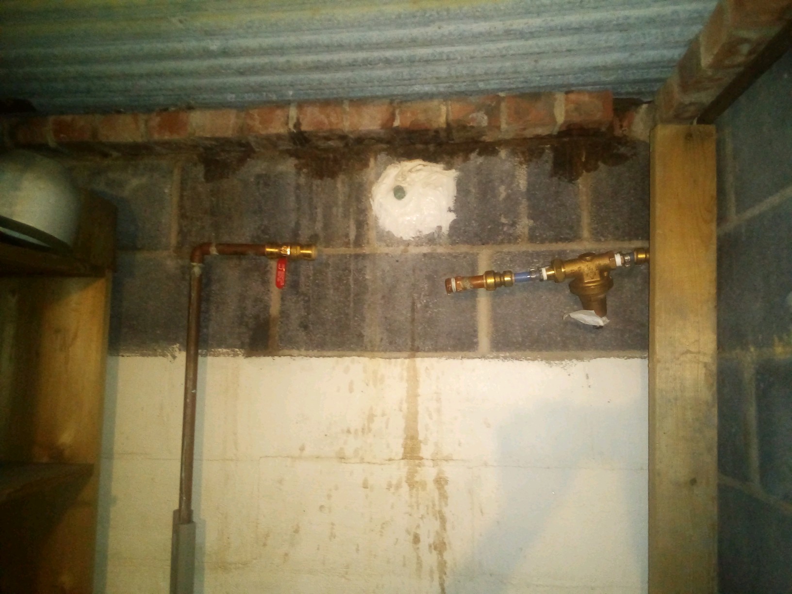

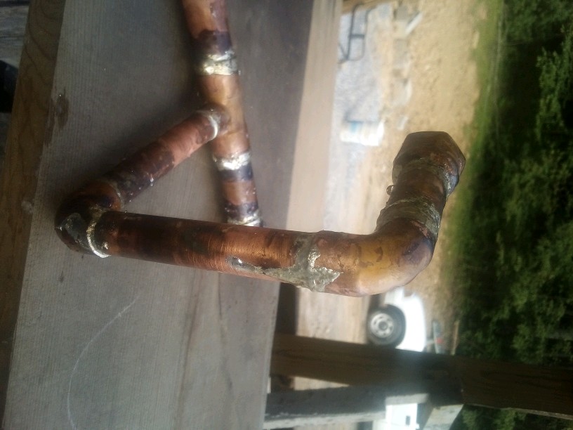

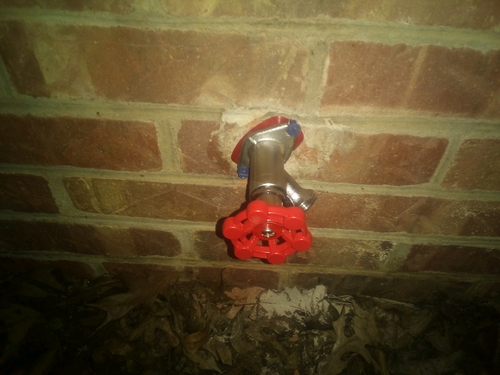

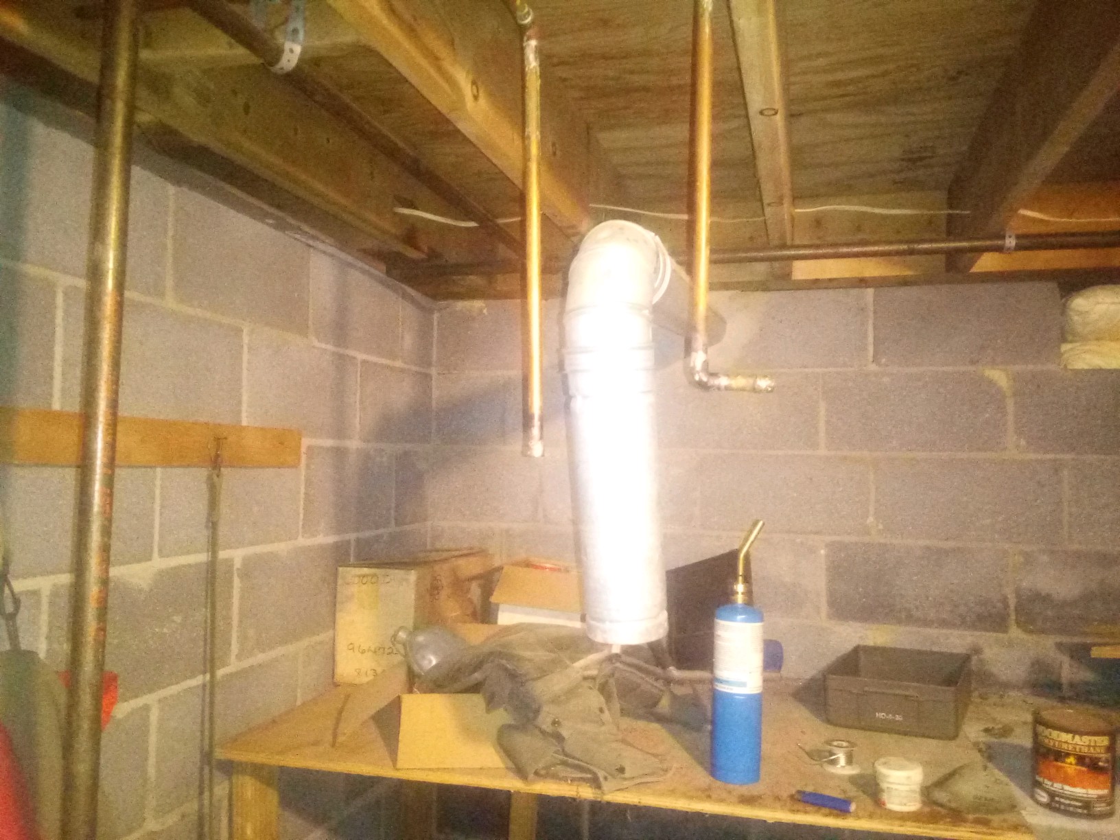

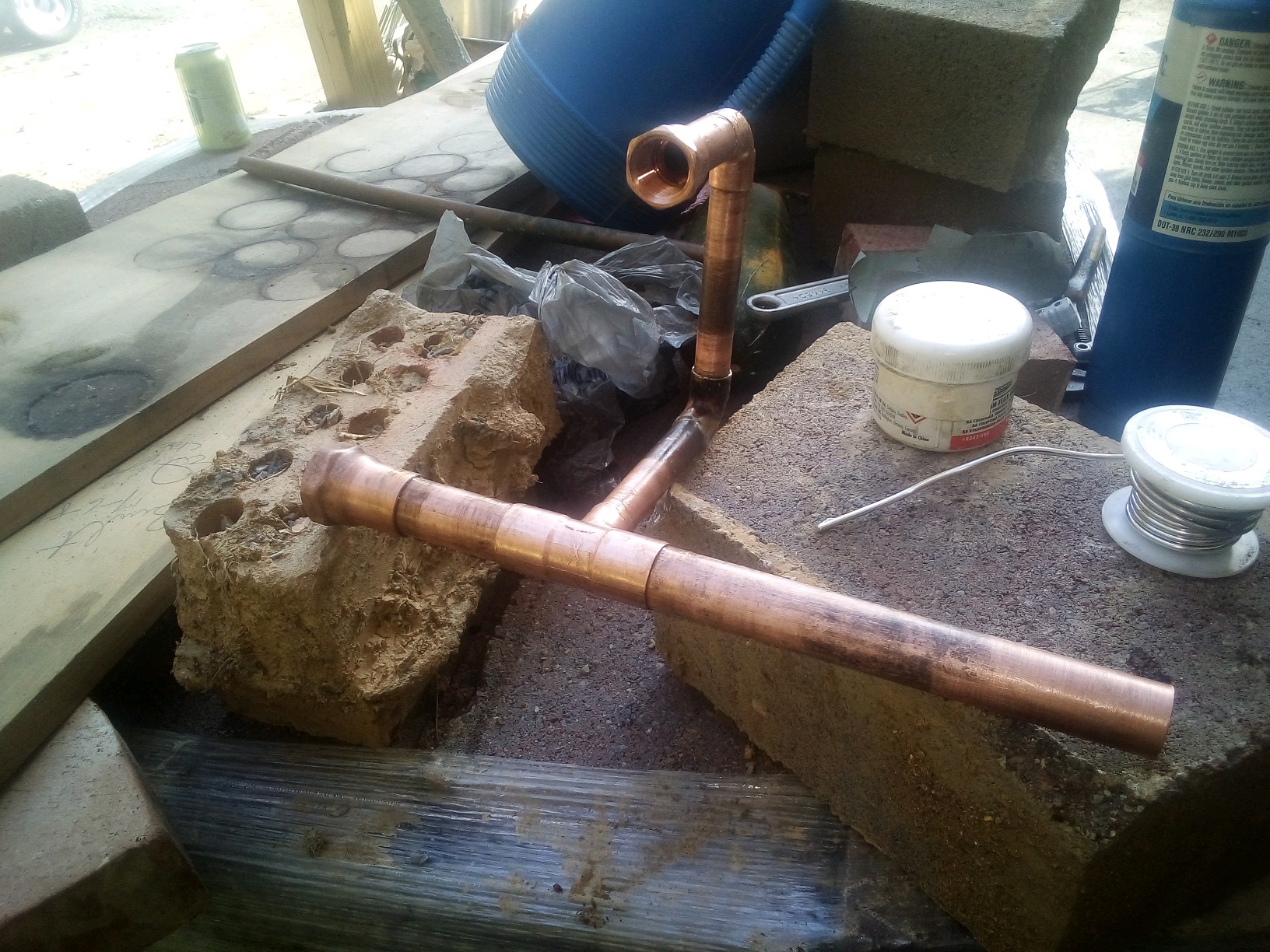

Replaced the main shut off valve, broken spicket, and capped leaky lines from old water heater. .

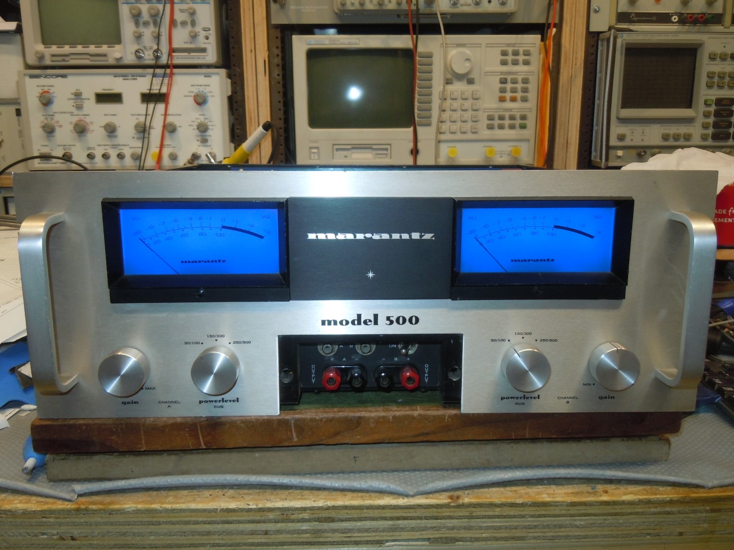

A Marantz 500

Pictures, Chris?
If I recall, this is on your short list of top vintage amps - did you ever get one for yourself? You have gotten me interested in these now.

A Marantz 500
-Chris
A beast to move, init? Back in the day, it was the "magical" piece in the showroom that made the Ohm F's and EPI 1000 towers sing - the Crown DC300A or BGW750, not so much.
No, I can't afford one. Here it is.
-Chris
Yeah, wow. They are fetching a lot. And it doesn't look like fun getting to those vertical boards. They really packed it tight.

Hi Chris,
They weight about 80 pounds. No joke when it comes to moving them, but they aren't that bad. The Crown DC300 is an offense to clean music everywhere, the BGW sounds a lot better I'll rebuild a BGW750 for improved performance. Not a DC300, there's no point in that.
Hi Greg,
I actually really like rebuilding these along with massive upgrades in performance. The amplifier breaks into three sections. It's true that working on one is not trivial, and I see more damage from people trying than anything else. With a little care and attention these amplifiers sound amazing. Lot's of detail work and things that a camera won't show.
Workmanship is so bad out there that you should only buy one that is untouched. Then have a tech who really knows what these are all about rebuild it. I know of one tech that is proud of working for Superscope (the Canadian distributor for a time) and says he is an expert on these. I've had to rebuild amps that he has fiddled with. That means you need a tech with a long record of working on these and other equipment and has an excellent reputation.
It always breaks my heart seeing one that an idiot has been into. One came in for work and parts were literally falling off the PCB. I didn't repair that one, the customer was freaked out and left (he didn't like the lead time either). That amp really needed new driver cards, and he didn't like the sounds of that! Work done by hacks is so sad to see.
-Chris
Hi Greg,

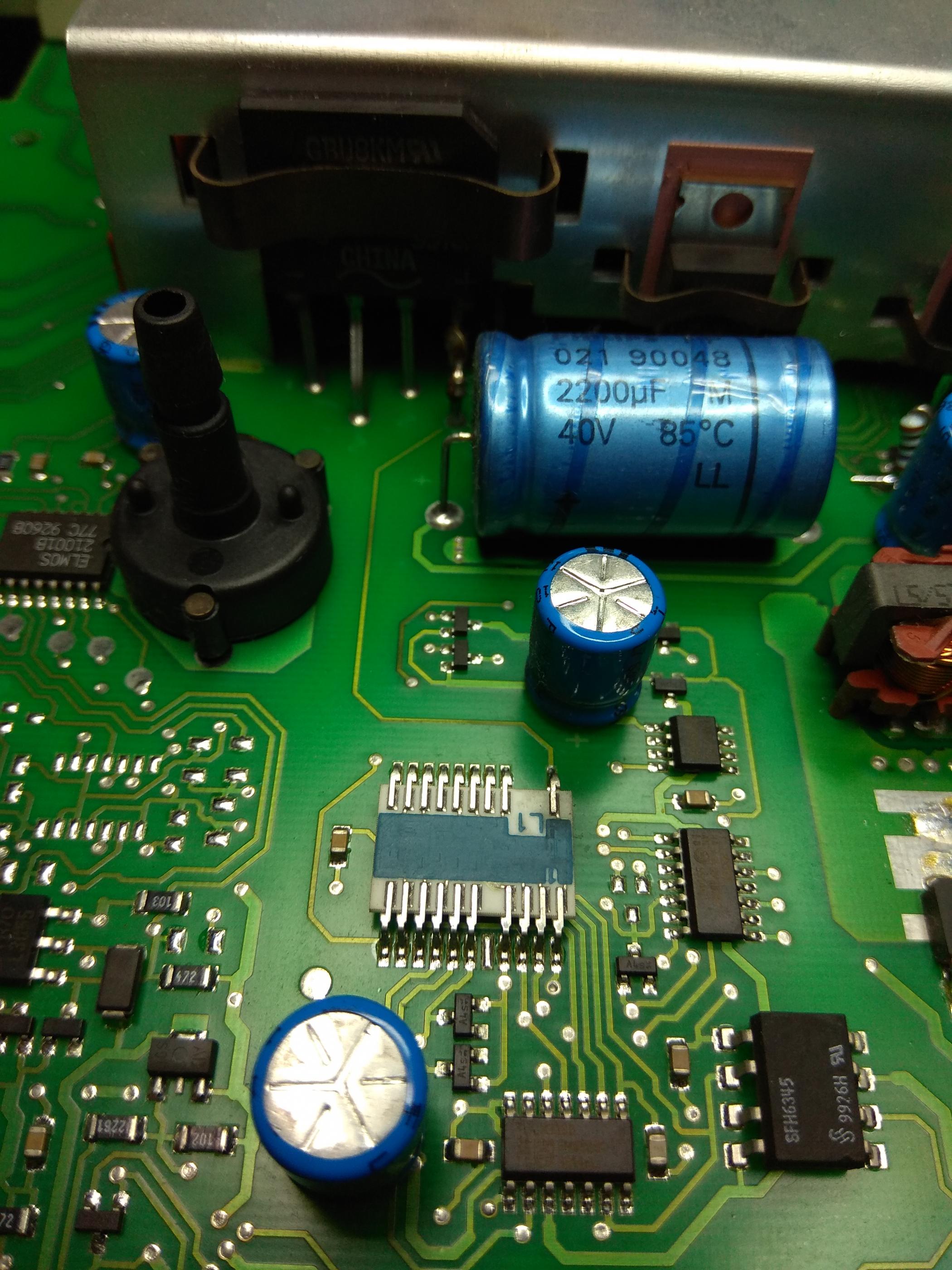

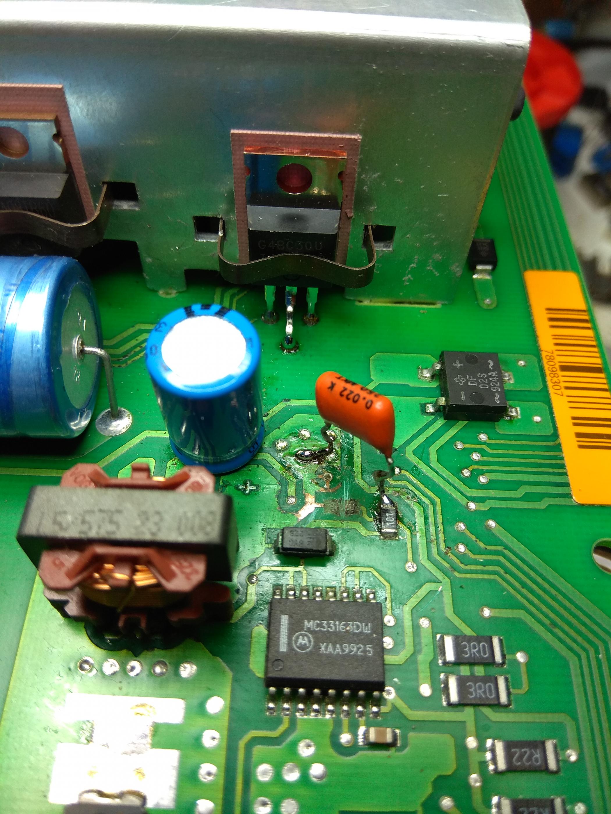

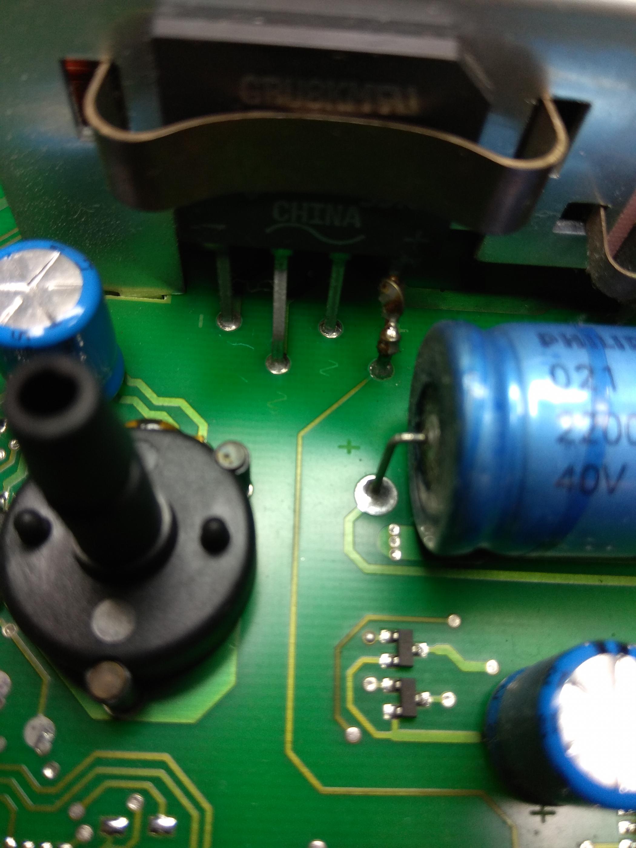

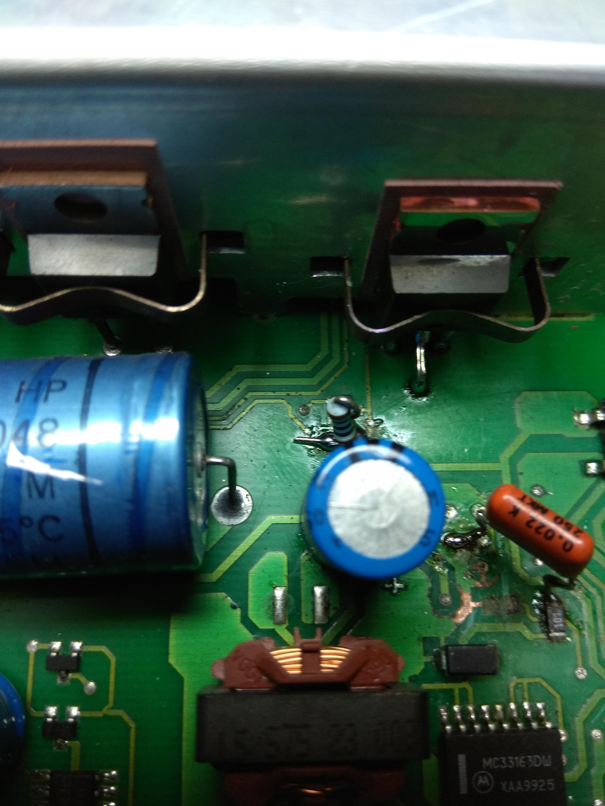

My washing machine.
A Miele Novotronic W 149.
The motor driver IGBT was blown and an smd capacitor oxidozed.
Miele is about the best brand of home equipment we have ever owned! Great choice!
-Chris
Yes Chris, agree!
This is a 25 years old machine!
