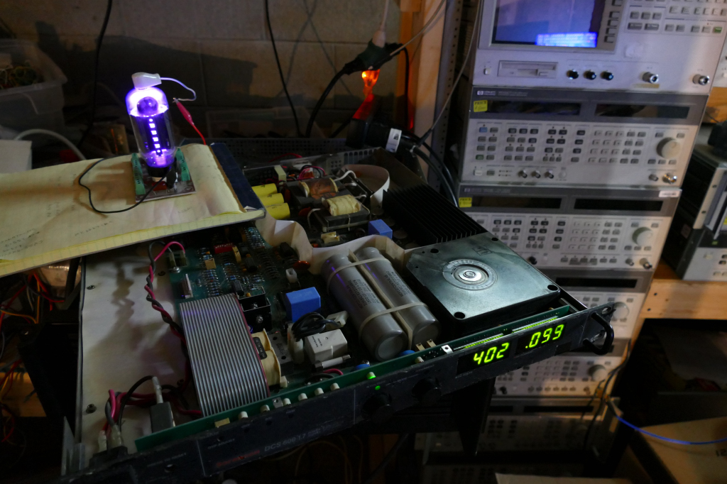

I have been slowly outfitting my lab with dead test equipment purchased at rock bottom prices on Ebay. I buy dead stuff, fix it, then sell enough to pay for it all. That way I can build a nice lab for zero money. Some of my RF test stuff can be seen in the background. All of it is fully functional.
So this time I snagged a Sorensen DCS 600-1.7 power supply for $139 in "AS IS for parts" condition. The pictures on Ebay show more dust than power supply, so there were no bids. I spy two things that will make the power supply appear non functional, so I buy it.
Sorensen DCS 600-1.7 600V Programmable Power Supply Powers on - AS IS for Parts | eBay
It arrives, and I have it running within an hour, and most of that time was spent with a shop vac.
Step 1....serious clean up.
Step 2....consult the manual. I already have it since I already have 3 Sorensen DCS series supplies. I made up a jumper plug according to the picture in the manual since the original is missing.
Step 3.....again, set the internal DIP switches to match the picture in the manual.
Step 4....plug it in and turn it on......It's alive.
Step 5 ........With 600 volts at 1.7 amps......time to blow something up....I connect a dead vacuum tube with only two leads, plate and cathode. I don't even bother to light the heater (filament) it's that dead!
Step 6....put the covers on and add it to my lab collection. I'm going to see if I can steal the GPIB / IEE488 interface from one of my other Sorensens and transplant it into this one......later after I beat on this one for a while to see if it's trustworthy.
