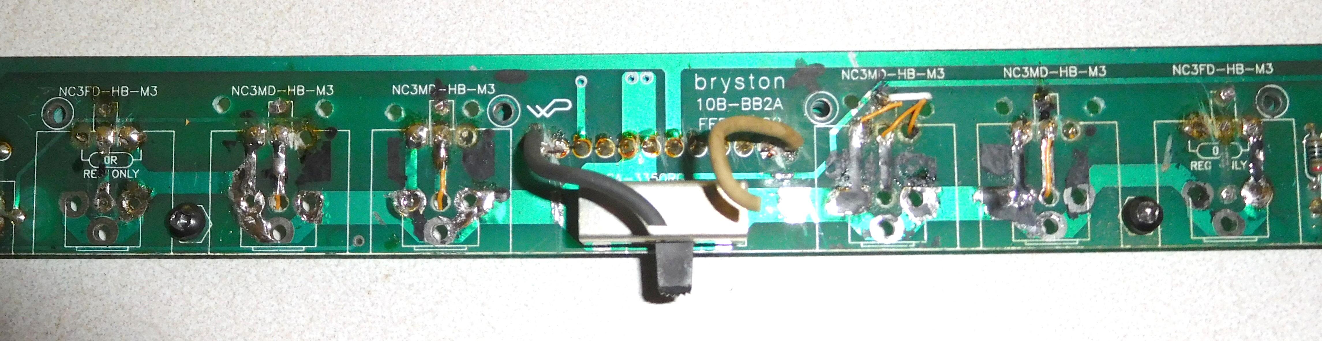

Well, almost done repairing:
An otherwise excellent condition Bryston 10B electronic crossover that the previous owner had hacked up the rear connector board, presumably to "improve" the XLR jacks. He tore up a bunch of traces, damaged the sockets he ended up putting right back in, created a ground loop with his bodged wiring. He even drilled new holes in the board for the rear XLR ground pins that didn't connect to anything. Just had solder blobs on the pins. He drilled other holes that appeared to have no purpose. He then clipped out the sockets, permanently destroying them. Amazing.
I didn't really want to reconstruct the traces, and got lucky; Bryston had an old stock board, mostly complete. I'll have to do a little parts swapping and mill down the taller standoffs, but no biggie.
The power supply needed new caps, as the original 31-year old caps were bulging and way out of spec, but now it's quiet and works as designed. Cleaned up the rotary switches, tested the boards, and now just waiting for the new back board to complete the project. Total parts cost will be about $110 - much better than a new one for $5,300 or a used one for about half that.

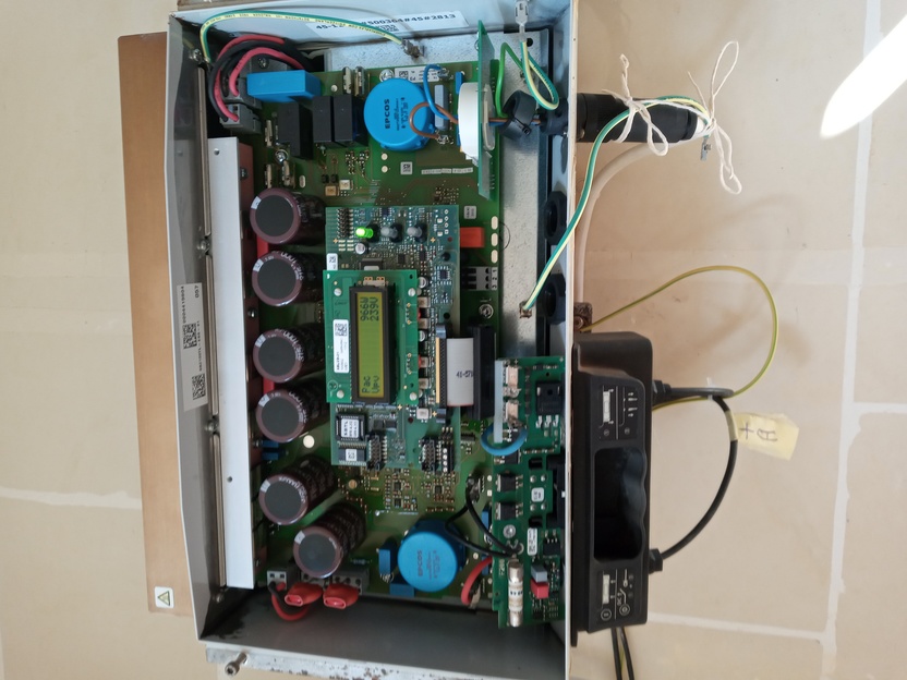

The attachement is a photograph of the opened functioning inverter which now is installed in my garage. The problem that was preventing it from converting power was a bad DC terminal connector that was leaking to earth.
