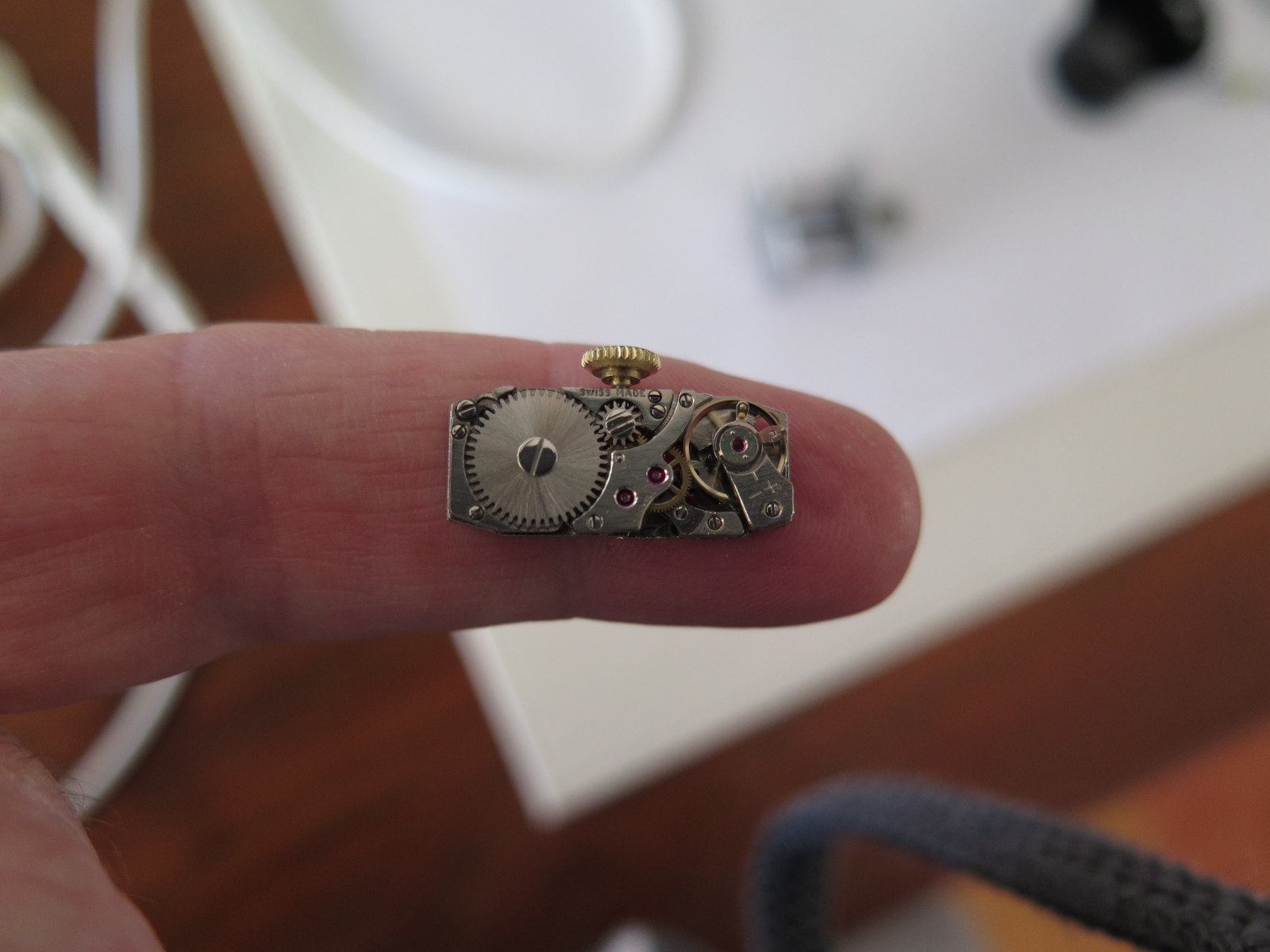

Unfortunately I do not have your engineering experience and love of past technologies. By the way, in a clock train there are wheels and pinions not gears, they both have completely different profiles yet all produce minimum friction.
I love old mechanical stuff. This is a 1970's watch I recently brought back to life for a relative; a 21st birthday present back then...a rather nerve wracking experience being one of the smallest movements made. Manipulating the hairspring coils to concentricity was the most difficult manual task I've ever undertaken. The watch is running in that photo - you can see the blur. That's my index finger.
