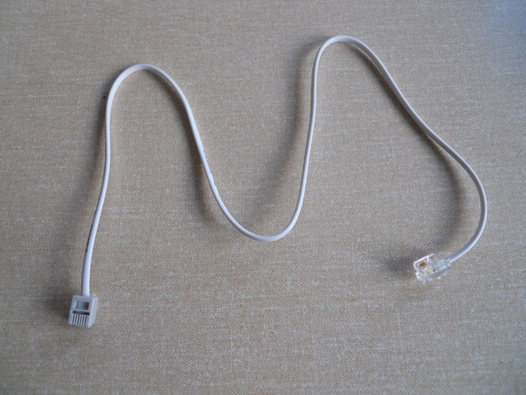

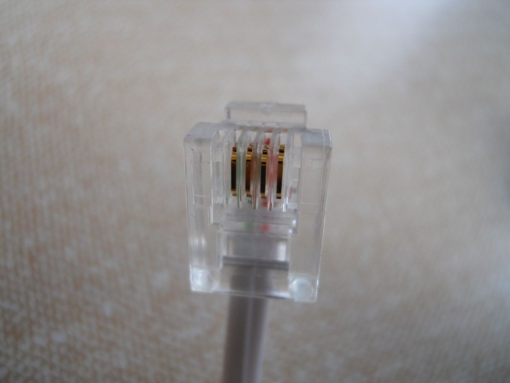

Not strictly a repair but I wanted to shorten a router cable that used RJ11 plugs... and never having attempted such a thing and not wanting to fork out for a crimping tool...
I think it turned out pretty well tbh using a thin bit of metal as a press. A piece of paper between the metal and the gold pins protected them from getting marked.

Cool! I have the proper tools for this, so I winced when you said you did it without the crimper. Did you know that they are two types of plugs? One for solid wire, and one for stranded cable.

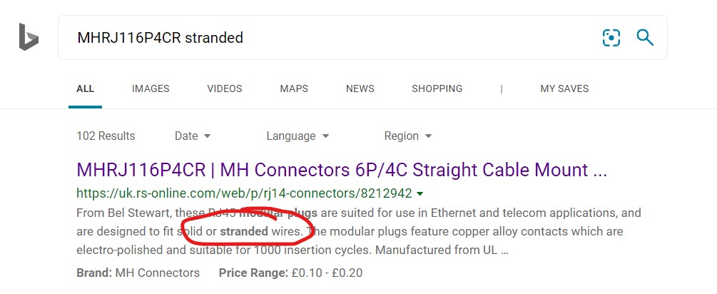

Erm... nope, I didn't know that
So I'm looking up what I actually used and the only bit of info I can find is from a generic search of the manufacturer part number.
The data sheet makes no mention of solid/stranded that I can see.

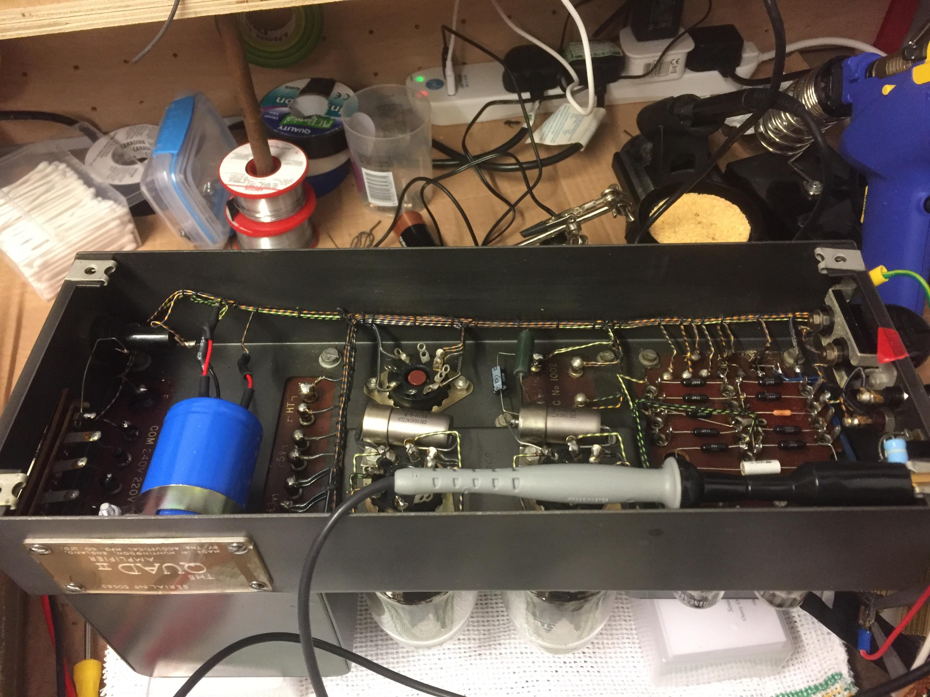

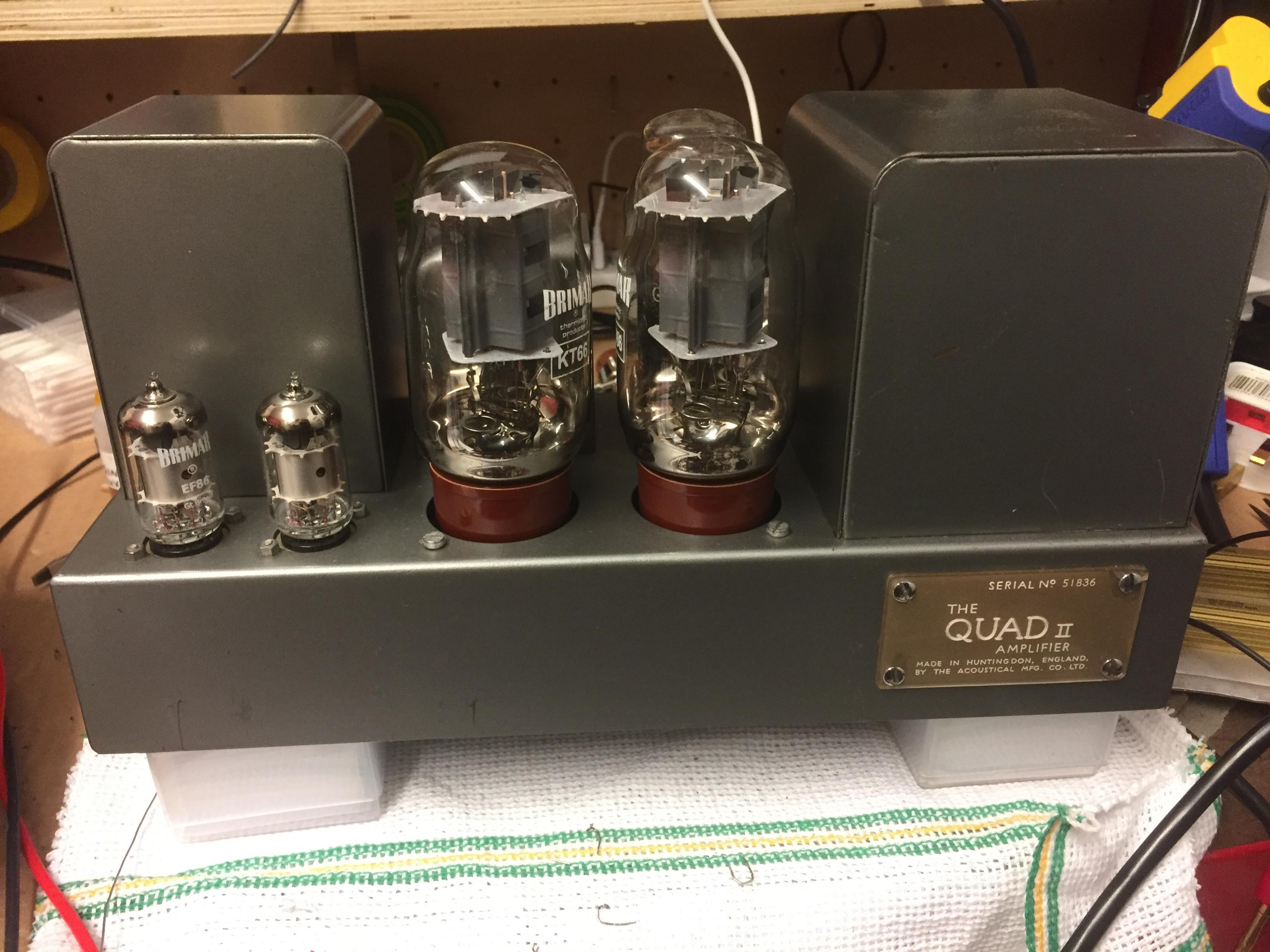

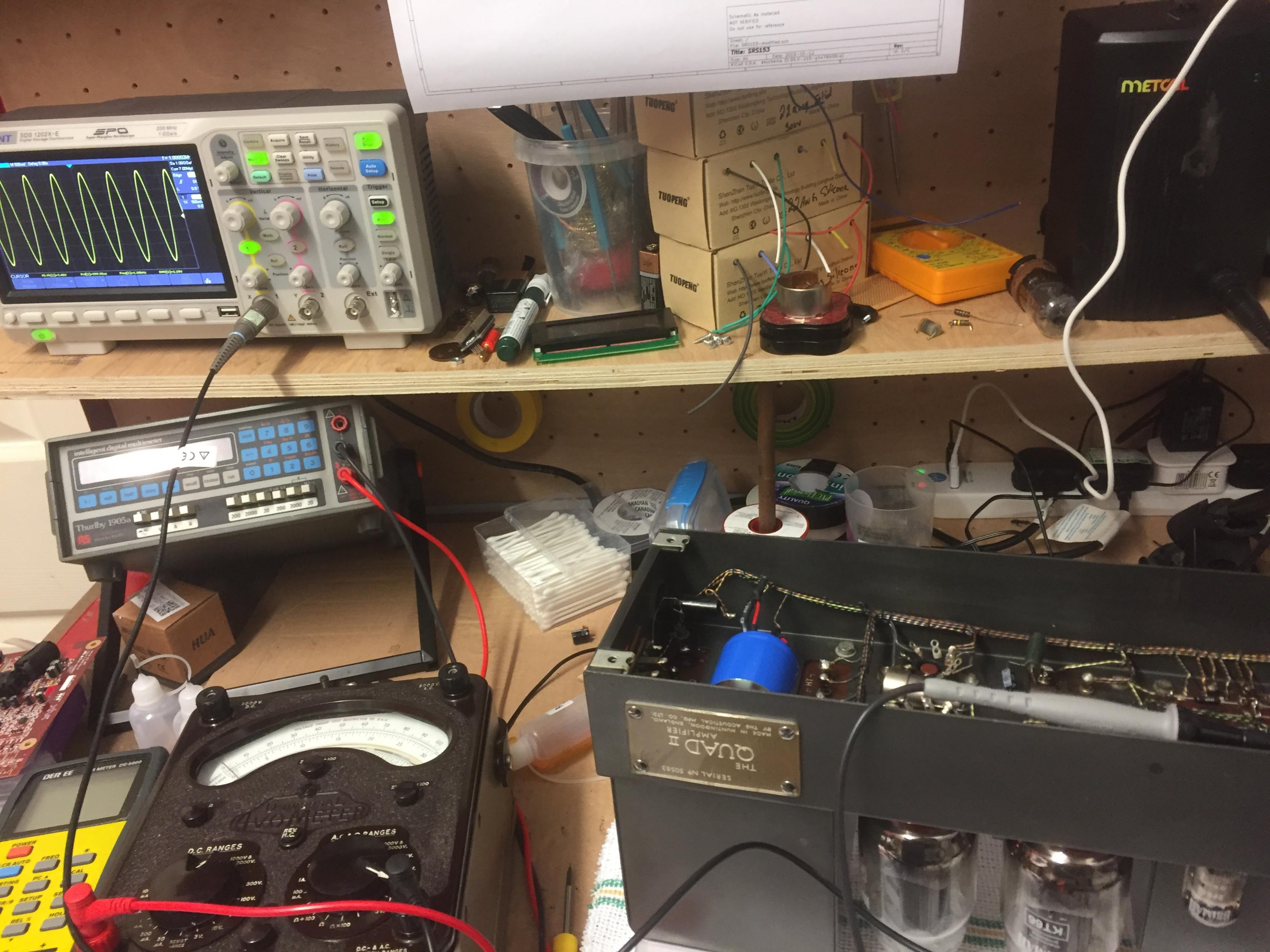

Finally got up the nerve to put my Quad IIs under power. They had come to me from a friend who had found them abandoned in a basement. One of the KT66s was smashed, and there were some dodgy homemade connection wires, so I considered them as being in an unknown state. Most of the resistors tested high, and one of the can caps was way out. So I did a full restore; nothing fancy except the Russian KY caps. Resistors are now 1% metal films. I’m planning on keeping these so I was mostly concerned with giving them a new lease on life.
Today I powered them both up on the variac and a dummy load. Pure sine wave goodness came through on the oscilloscope. So it looks like all the iron is in good shape. Haven’t yet put them on real speakers though.
Edit: Oh, and a new set of matched valves that I bought from the new Brimar folks. I know they’re just rebadged but I really like what they’re trying to do. Again, nothing exotic — just good quality stuff.
Looks good with the Brimar valves installed. Neat job.
With modern resistors, you must check the voltage rating! Don't be surprised to see some rated at 100V. The old carbon composition resistors in a 1/2W were rated for 500 or 600 volts (I can't remember which). All I know is that when I rebuild tube equipment the voltage rating of the resistor is very important.
If you exceed the rating, they may not fail right away. They will arc inside and you may not even see this under the coating.
-Chris
-Chris
Thanks for the reminder, Chris. I used TE/Holsworthy H4P 1 watt throughout which have a 500V rating, except for R4 where I used a Dale 1W CPF. This only has a 250V rating, but it sits on the cathodes of the EF86s where the schematic gives 2.2V. R12 is a Welwyn 7W W22 rated at 200V, but should only see 26V as far as I can tell.

Hi ahankinson,
Isn't it amazing how much you can remember, all those small details?
I normally use the higher power resistors in tube gear to get the longer body so the leads reach, that and the higher voltage ratings. I'm constantly making certain the resistors will stand up to even fault voltages (except in the cathode circuit where the current will burn them out in a failure).
Nice job overall.
