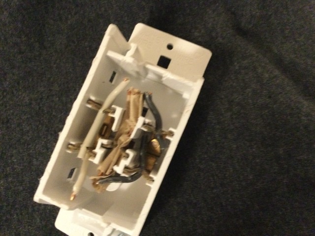

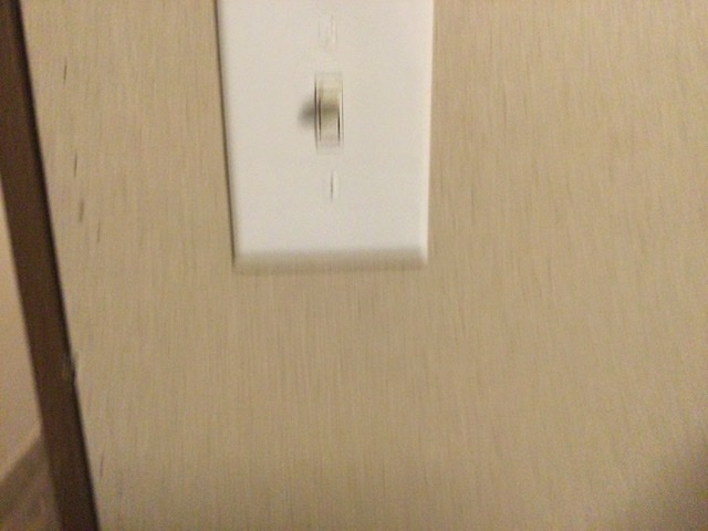

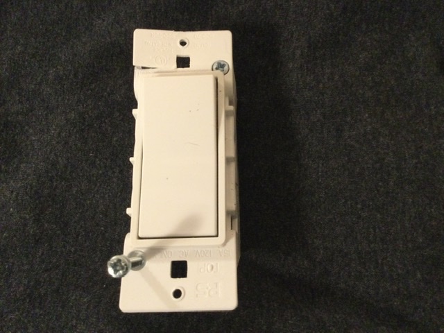

!@#$&* bedroom light switch in the trailer. Sick and tired of it flashing and not staying on.
Real switch and real blue box, replacing the other POS. I can’t even see how that meets code. Not that anything is enforced here but this is just ridiculous.
Every damn box in the shop is metal, and the house is getting wired the same way.

Plastic will not corrode as easily as metal, but heat may cause fast degradation.
Depends on the environment. And reasonable wall thickness, and proper plastic material, many types exist.
I would prefer it to metal as there is less risk of electrocution in damp or otherwise conditions.
As for the switch, it seems we in India are not the only ones struggling with cheap junk.
