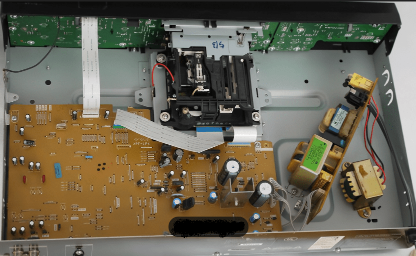

I thought it might be interesting to do a comparison between two Minidisc recorders, the MDS-JE480 which was one of the last models that Sony produced, a model that was firmly in the 'budget' category. The other is an MDS-JB920 which is an older model but much more of a heavyweight and dare I say more audiophile oriented. The budget MDS-JE480 does however sport one of the last (and best) developments of the ATRAC compression system 'ATRAC3 DSDP Type S' while the MDS JB-920 uses an earlier version of ATRAC. The later ATRAC versions were needed for the inclusion of LP2 and LP4 recording modes which doubled and quadrupled recording time available per disc, a very useful feature and one the MDS-JB920 lacks.
The actual MDS-JB920 used here is one I was fortunate to obtain a few months back. It has that classic early generation quality feel to it, it's a real heavyweight and offers very high build quality throughout. Unlike the MDS-JE480 which majors on using SMD components, this one uses mostly normal sized through hole parts.
https://www.diyaudio.com/community/...ttle-conundrum-at-the-end-of-the-post.405949/
The MDS-JE480 I have owned from new and this picture is from the web. It is much more a lightweight budget model but it is nicely finished and very feature rich and of course having that very desirable ATRAC3 Type S encoding system.

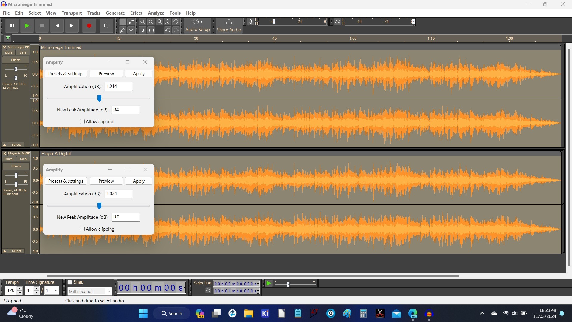

My ADC Spectrum Analyzer thinks that the Micromega sample may be at a slightly lower volume.
Hmmm, that's an interesting observation. I originally equalised the levels using Audacity on the raw original files and set the peak level at -1db. For curiosity I've just loaded the files (the actual ones attached to the forum) back into Audacity to see what gain is needed to bring them them to 0db. It should be +1db... they are all close...
These are the two digital files along with the reference.
Could there perhaps be a difference in frequency/amplitude distribution that a spectrum analyser picks up on and interprets that as a higher overall level... interesting one :)
