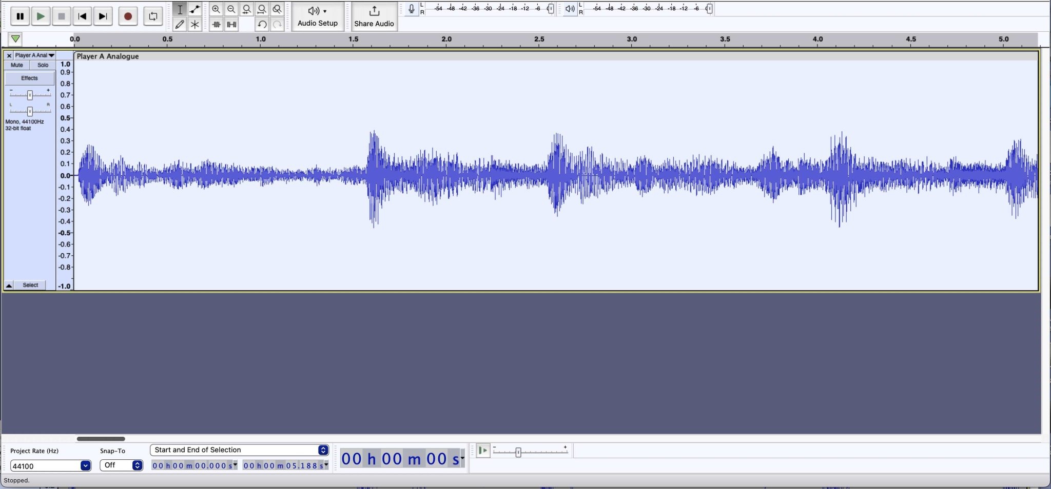

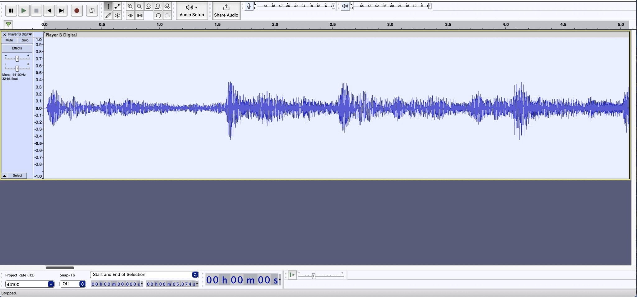

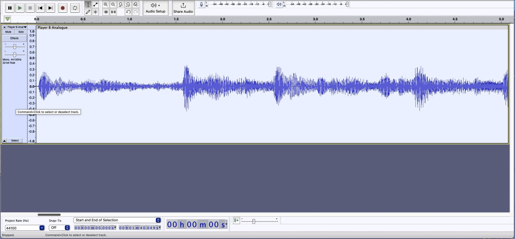

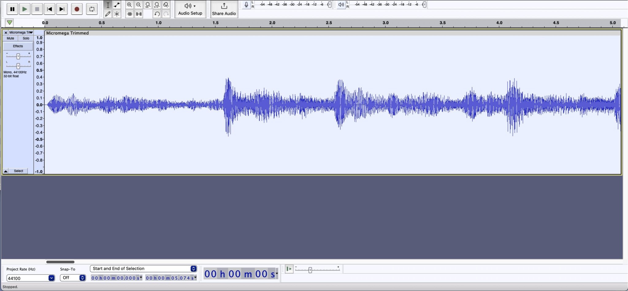

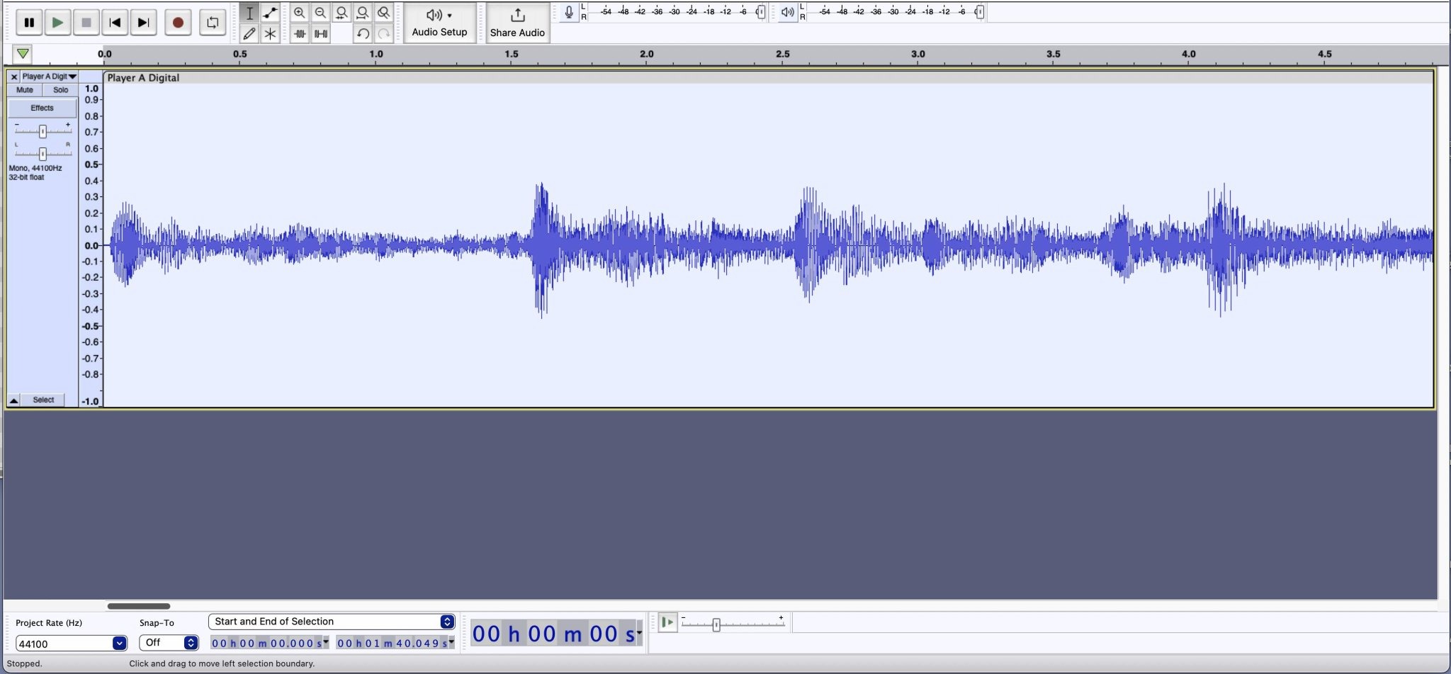

After I finished listening to the tracks, multiple times, out of curiosity I decided to watch the display of the spectrum analyzer as I replayed each track one more time. When I got to the Micromega track I noticed the first note did not register on the display. From this observation, I jumped to the conclusion that the track was at a slightly lower volume level.
To try to pin this observation down, I looked closely at the first few seconds of each track with Audacity. Since the spectrum analyzer was set display combined left and right channels, I summed left and right to a mono signal, and then selected the first 5 seconds and zoomed to that selection. The results are shown in the attachments. If you look at just that first note for each track, the Micromega looks to have a lower amplitude. I am not sure this lower amplitude extends for the entire track, but it seems possible. I am assuming it is just a fraction of a dB but I have not tried to quantify it. Does seem interesting.

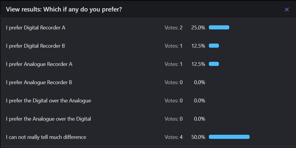

Well time is just about up and so firstly may I say many thanks to all those that took the time to give these a listen.
To put you all out of your misery I can reveal that Recorder A was the budget MDS-JE480 and Recorder B was the older MDS-JB920. Both are very good in what they do imo and differences are very hard to pick out I have found.
The poll has only a small number of samples unfortunately and as such I'm not sure statistically if it reveals very much.
Thanks again for listening :)

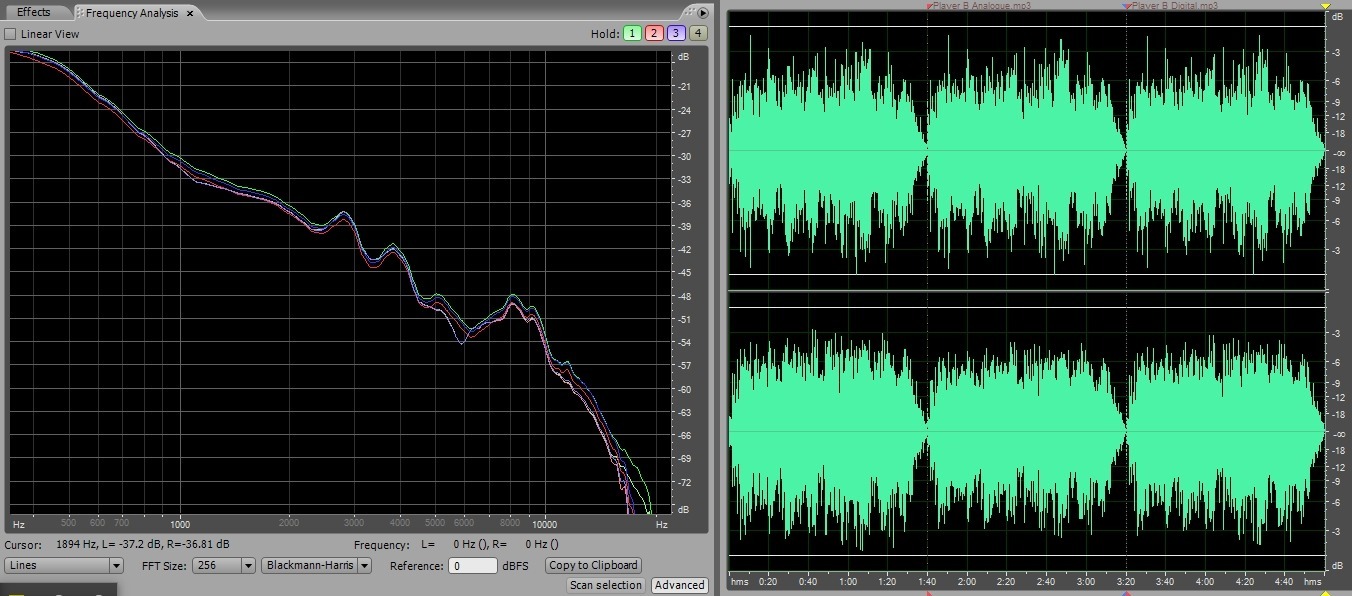

I compared the reference with both analogue A and digital A.
First track: ref.
Second track: analogue A
Third track: digital A
Both channels scanned hence the dual frequency plot.
The 3 colours above the Frequency Analyses window, green, red, blue, one for each track, overlap nicely.
Here is the ref. compared to Analogue B and Digital B.
First track: ref.
Second track: analogue B
Third track: digital B

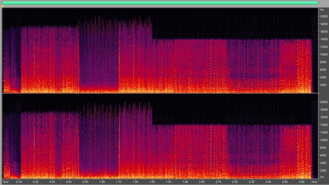

For anyone interested :)
All the talk of LP modes had me try something out, a single track (totally different musical genre this time around with lots of HF content) that changes seamlessly through the different modes. It starts out in LP2 mode until 45 seconds in at which point it changes to 'Normal'. That carries through until 1min 30 secs at which point it switches to LP4 until the end. That is the changeover that is most noticeable. LP4 mode is giving over 5 hours 20 minutes recording.
  • Minidisc LP Modes.zip
Moderator
Joined 2003

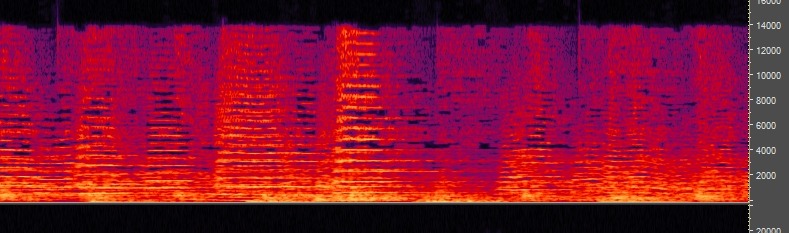

I had a listen and a look at the track.
I can't hear the difference between LP2 and normal mode, but LP4 is definitely audible when compared.
Looking at the spectrum, one can see how much information is lost in LP4 mode. I would compare it to 128k MP3.
The magnified part clearly shows the 'holes'.

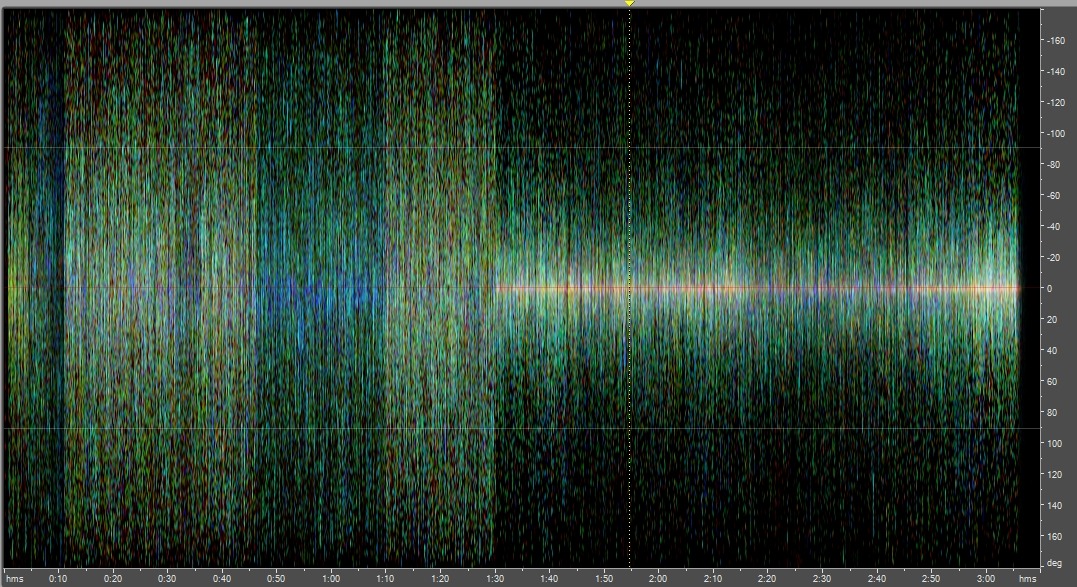

Also, the spectral phase display shows a very different pattern and the loss of info.
The redish line in the center is weird.
If these modes are used as intended, they are nevertheless very useful.

That first shot is quite graphic, if I'm interpreting it correctly there seems to be a hard limit on bandwidth in LP4 mode with nothing over 14k present. When listening one of the biggest changes I notice is the stereo image reduces considerably in LP4 mode. A real narrowing of the sound stage.

On the contrary, both transitions are seamless to me. I can't tell about micro details but it doesn't sound less vivid or like typical harsh mp3.
I recorded the track three times, once in each mode and then cut and spliced them using Audacity. Thanks for listening (y)
