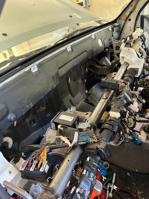

Just had to change the air conditioner evaporator in my son's Toyota 4WD, which involved removing the whole dashboard and pulling back the reinforcement bar. It was quite a job, but we did it...in two whole days.
Been there. I had to pull the dash twice on my ex1996 Ford Ranger SuperCab. Both times for the heater core.
Something tells me I had do it once for my ex2001 F150 SuperCrew, but it wasn't for the heatercore.
I soon might have to pull the dash to fix the blend door in my current 2011 Ford Crown Victoria LX. The plastic hinge is known to break. Guys have been fixing the hinges with cheap metal parts from a hardware store.
