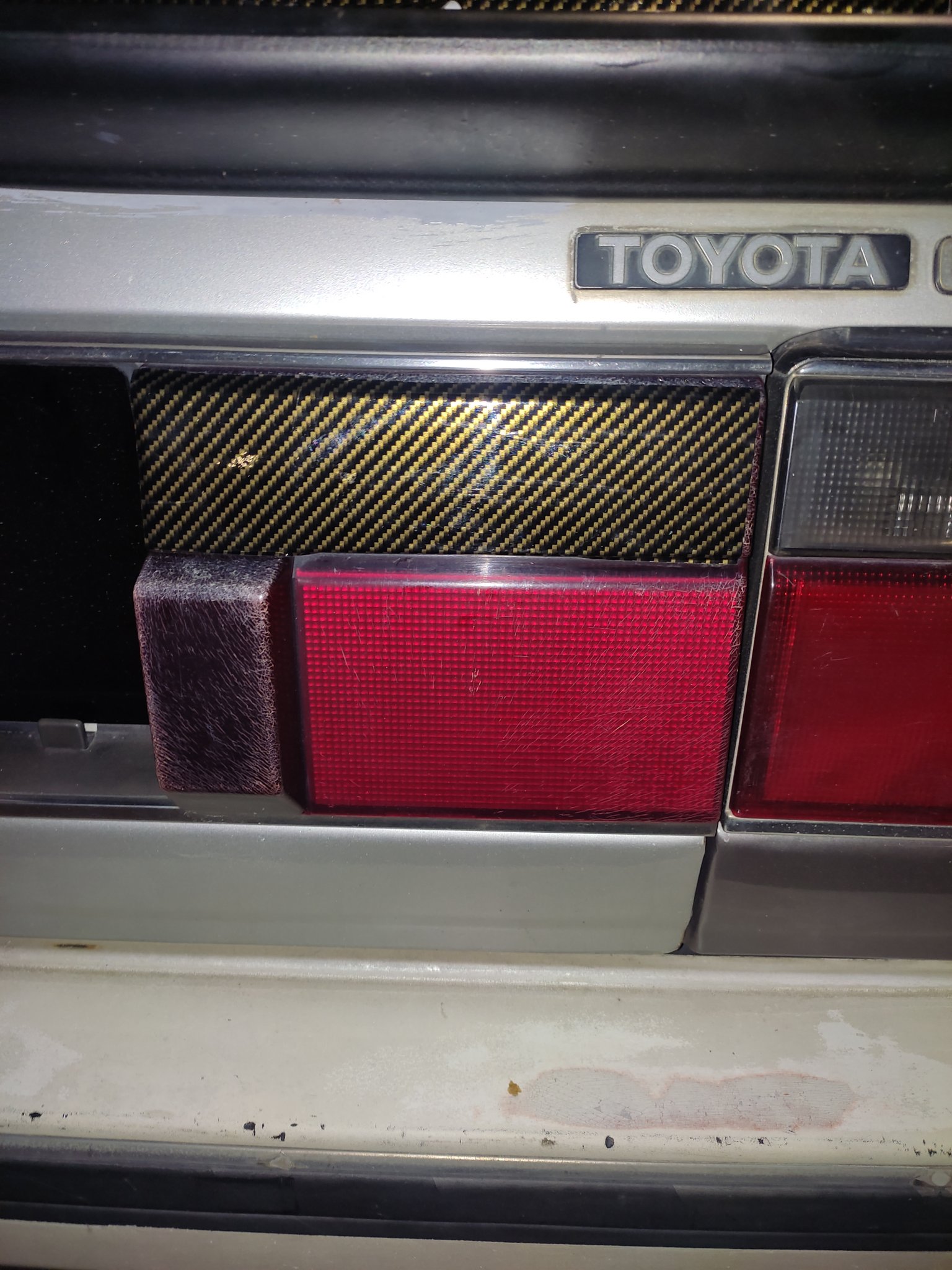

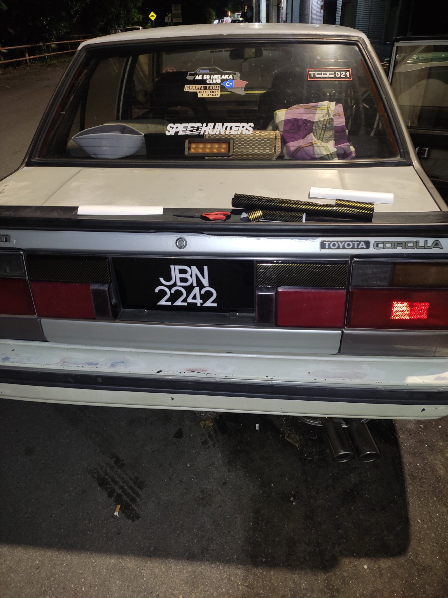

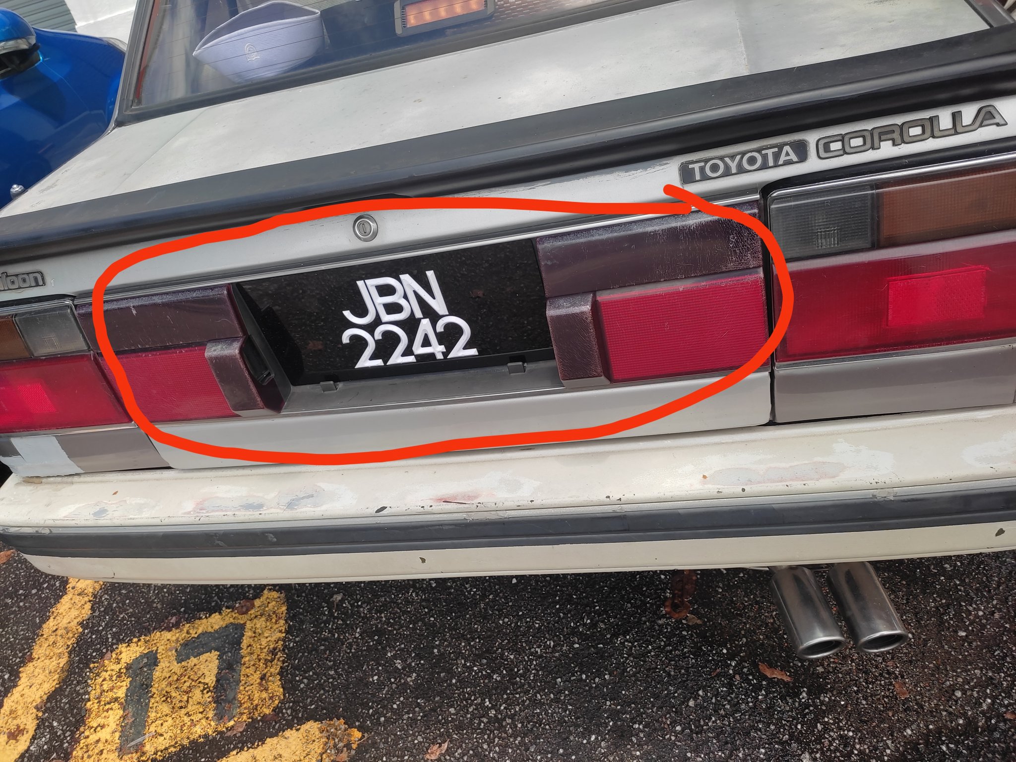

Non audio related a.k.a off topic ... 😅 Quick fix (i dont know wether it counts as repair or not 😅🤣) to my old toyota corolla rear reflector by sticking carbon fiber sticker on it ... They started to get brittle and cracking soon 😅 still searching for replacement reflector as these were getting hard to source ... Still a small part on the red side not fixed yet 🤣
