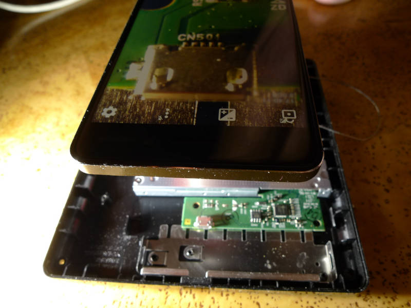

Few days ago the micro USB connector suddenly came off the portable bluray player, and soldering those tight pitched legs was not the most easy thing, my finest needle soldering tip looked huge in comparison to the USB legs under the improvised magnifying glass made up of my mobile phone with the camera set in macro position, which btw actually worked great provided there's enough working light (see the magnified USB connector centered in the mobile display compared to how tiny it is on the PCB in the background), but it took a couple of rounds of soldering before I got it to work, a bit nerve wrecking as the the plastics on the USB connectors started to melt a bit.
