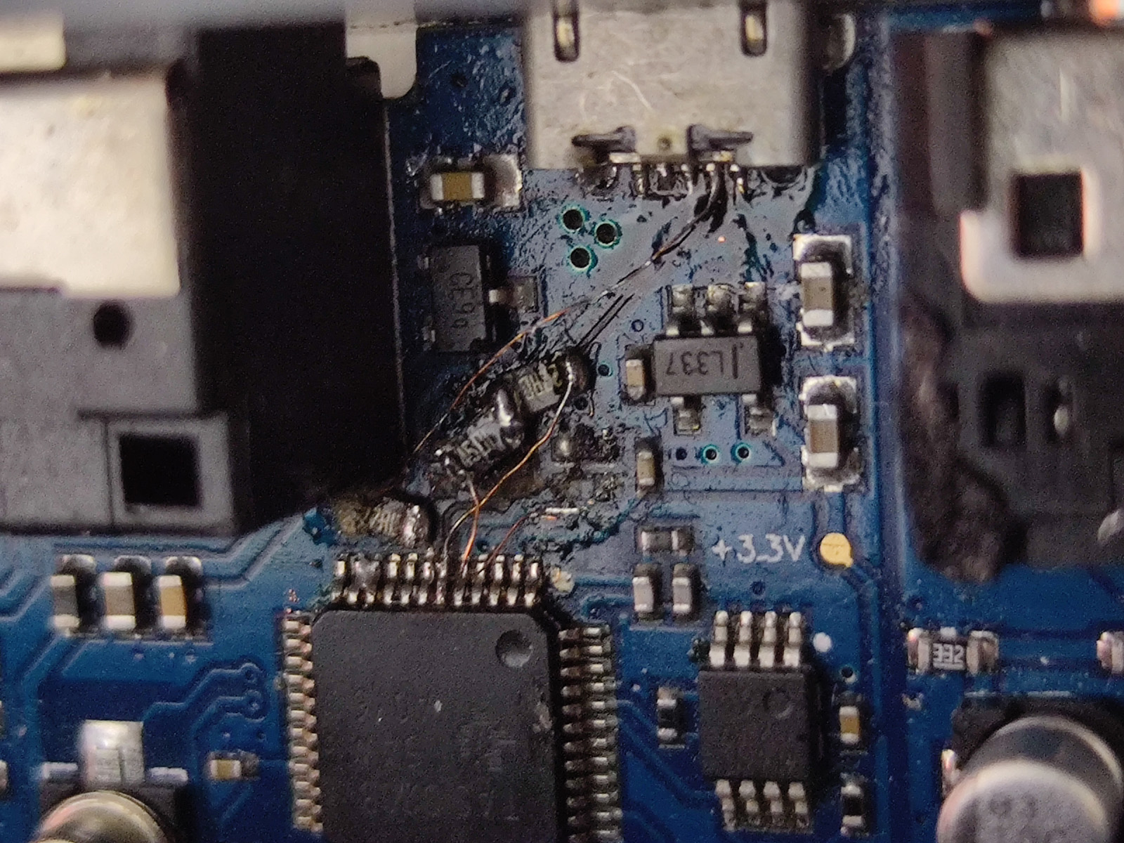

I dead bug style restored functionality of a burned down USB input in an SMSL Q5 Pro mini desktop amplifier. A black hole in the PCB was all it remained of the 0402 size SMD components comprising the input route of the TAS1020B receiver chip. No pads remained to solder on and vias were blown around & further upstream. After much patience with a dirt cheap headband magnifier and fine tweezers it was recognized by the PC, locked, and playing again without interruptions or noises.
For a sense of scale, the copper strands you see for point to point connections are teared out "hair" from solder wick braid.
BTW that's not a solder bridge on two pins of the TQFP package, its intentional to restore a common ground return blown.

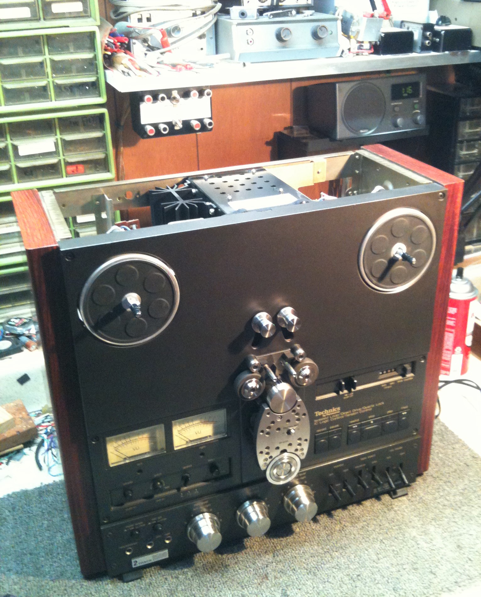

Only 94 pages?
Last year I had to overhaul a Technics RS-1500US reel-to-reel deck from top to bottom.
The TWO needed service manuals a total of 113 pages to plow through.
Talk about FUN! 😱

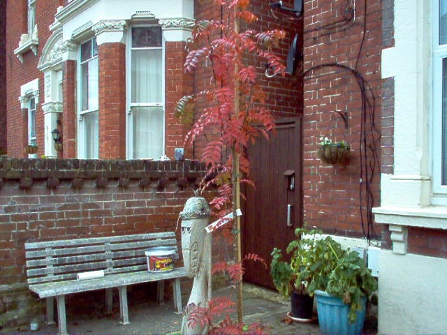

Painted the Garden Door with Ronseal One-coat Timber Care. Tricky bit was opening the container. No instructions. 😕
Took ages actually, and I specially paid attention to the bottom, which is where the ROT often sets in IMO. As you can see.
The second picture is of my foolish neighbour Paul's neglected Garden Door.
Take more than a coat of Paint to fix THAT! 😀
