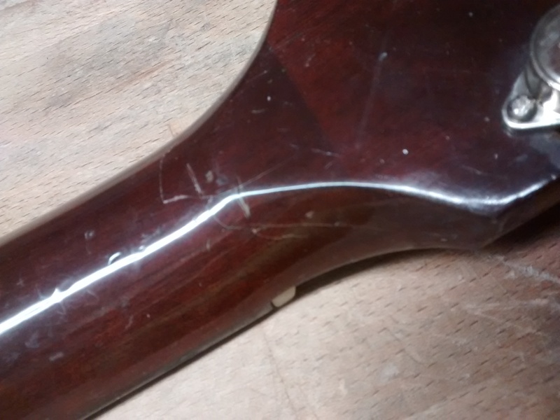

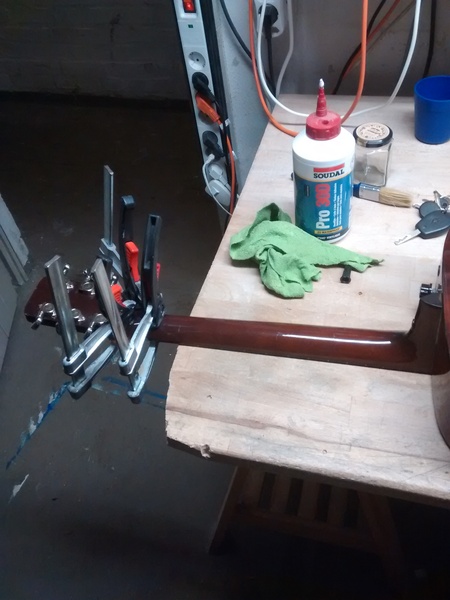

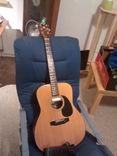

My beloved acoustic guitar I bought about 1972 was on the bench. This old lady served me for about 50yrs and I may have stressed her a bit too much during this corona era. Eventually she encountered a breakdown, dropped to the ground and broke her neck. Immediately I took her to next emergency station in the cellar. Applied glue on both sides of the fracture. Smoothed it with a paintbrush then heavily pressed using 3 clamps. About 8 hours later I removed the clamps. The healing process looks nearly seamless. I allowed 1 day for convalescence and in the meantime bought some strings. Now I have set up the strings and will check her on the next band rehearsal this evening.

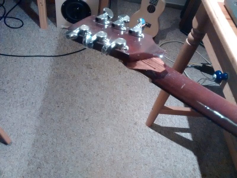

I had a disabled friend who played in a band.
He had a very expensive guitar.
One night at a gig during interval an elderly lady tripped and fell on his guitar snapping the guitar neck.
Luckily he made guitars himself from scratch and managed to fix it ok.

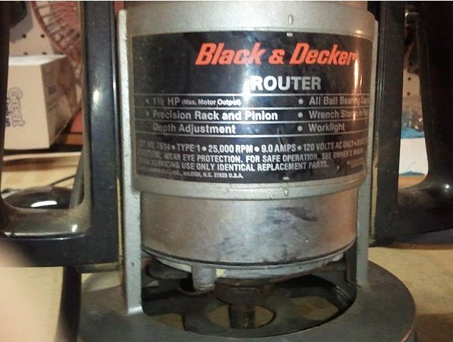

Had to do some repair to my Black & Decker router tonight.
I had planned to use it today, but it wouldn't kick on, I thought it was the trigger switch.
But it wasn't - apparently the brush housings have a projecting pin that presses into a receptacle down in the housing.
I would have preferred a design that is more solid and secure, but managed to clean and slightly bend the pins for a solid contact.
She reads 5 to 8 ohms now with the switch locked on, instead of 180+ to meg ohms.

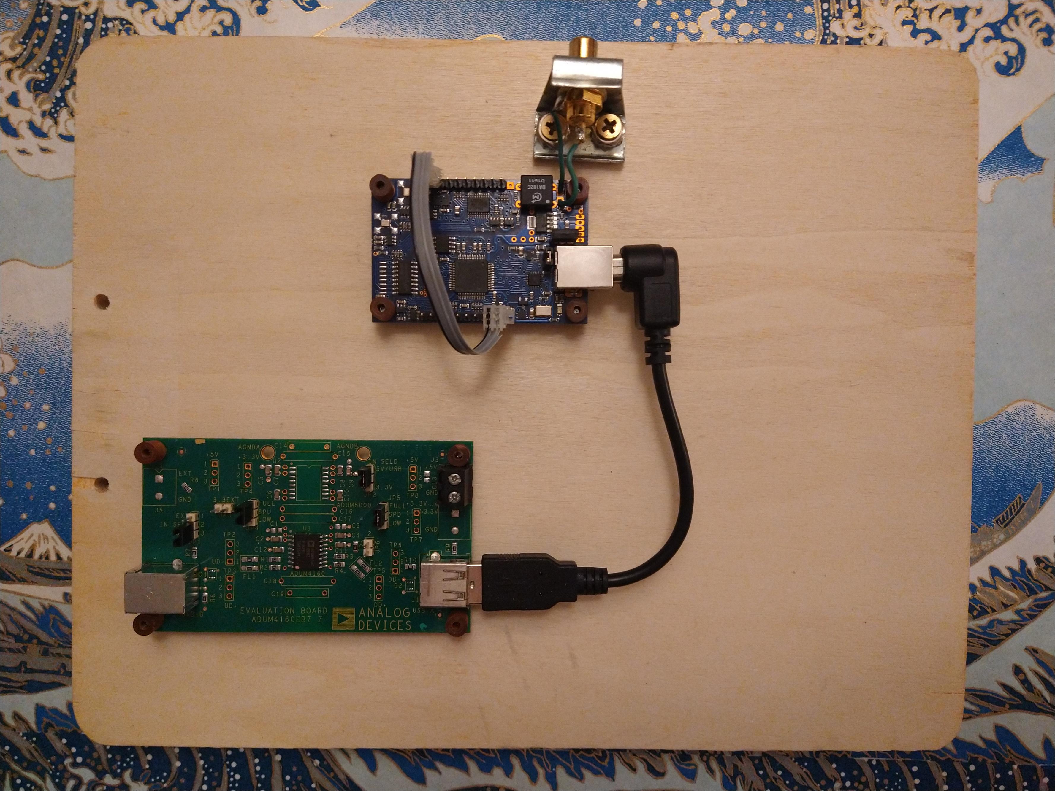

Hi YashN. I've been dealing with USB isolation myself. I have a DAC that I love but it only has SPDIF and AES digital inputs. I bought a USB to SPDIF converter board that had a toggle switch to toggle between an external +5 Volt supply and the power derived from the USB's +5 Volts. The differences in listening between the external supply and the USB were very significant. Also having the laptop charger connected to or off of the MacBook was a noticeable difference when using USB power (off was better).
That experience got me on the path to finding the best solution for USB as a source. I bought Analog Devices' ADUM4160 evaluation board which galvanically isolates the usb path between ends. It allows separate +5 Volt supply inputs on each side of it. I also bought another USB to SPDIF converter that has its own isolation and separate +5 Volt supply inputs at each end too. I will be powering these devices with four LT3045 voltage regulators and linear power supplies. I hope to get it all mounted into a nice chassis of its own.
The ADUM4160 evaluation board is interesting and even gives you a spot to solder in common mode chokes for the USB signal. As sold that is jumpered to bypass that socket.
The picture shows the two boards as I get ready for a test build with external power supplies.
