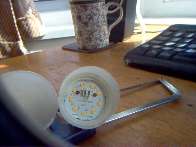

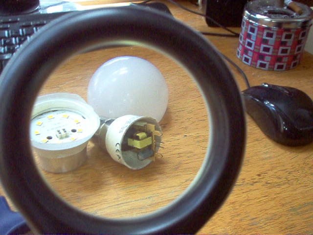

Mine is a broken Tesco 8.5W 2700K. It refuses to glow.
Using sophisticated tools I have disassembled successfully and now just need advice on where I obtain a new yellow coil before gluing it back together. 😎
The yellow coil is clearly split and broken apart. 😱
I suspect it is the INTEROCITOR coil. I would further guess, as a layman, the overall device is an "interocitor incorporating electron sorter" and "intensifier disk" combined. But could be wrong. 😀

That is a Ferrite transformer, the old designs were like that: separate driver and LED boards. In a 9 Watt, the supply is constant current 27V.
For 20p I would not bother, just keep aside for when another pops with a different fault. Then mix and match...check that the LEDs are OK.

Investigations of the failed 9.5W lamp have been ongoing and illuminating. I ripped the board out with pliers.
842735d1589123914-universe-expanding-clouseau-png
It seems heat is the factor that shortens LED bulbs life. The small electrolytics are rated at 400V and 130C, and we know they conk out quicker when hot.
And they do get hot. But my guess is a small soldering fault on one of the 8 pin SMD components. Two pins had a stray solder blob shorting them.
We might speculate that this fault, whilst not fatal to initial operation, caused overheating or failure elsewhere.
