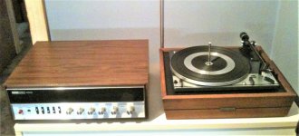

The current Dual, which is not my main player by any chance, is tucked away in the closet.
It's the Dual 1215, on tapered walnut base w/factory dust cover - in absolutely flawless cosmetic condition - AND - fully serviced by me.
I've also modified the cuing-damping system to work "full time", instead of having to pull the arm lift lever prior to automatic operation.
Here it is next to a vintage (also pristine and modded) Harman Kardon 330A receiver....
This sounds weird to me, as I don't know of any Dual changer/automatic TT that needs it's cue lever to be pulled or released in addition to operate the Start lever. Maybe your's was faulty previously?
And where's your 1229 now, as this surely was the better unit of both?
Best regards!
First, the 1215 has actually two methods of tonearm lift/lowering..
1) -In automatic play, the controlled damping happens *after* the tonearm starts to lower onto the record.
In other words, the arm partially drops free, only to resume lowering with damping, just before touching the record.
It is not a defect or fault, it is designed that way.
2) - And as the instruction manual states, if a very sensitive/compliant/delicate cartridge is used, *full* lowering with damping can be used by pulling the cue lever first, before activating the start/change cycle.
My simple modification always provides *full* damping in auto-mode while lowering the arm all the time without the need to even touch the cueing lever.
Just like the 1229 did.
As for that 1229 that I once owned, purchased brand new in 1974, (and I also owned a 1219 too...) both were stolen from my apartment back in 1982 by thieves, as was much of my lovely audio system too.
All those years after, I used a plain Garrard AutoSlim model, and then a BIC 960, until the late 1990's when I got a Kenwood DD linear tracking model, and then added the pristine 1215 to my toybox.
Which, by the way, is very capable of performance comparing to the higher-end Duals.
