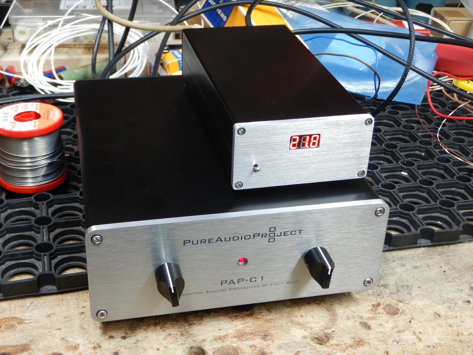

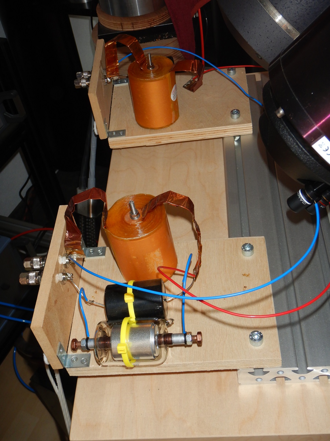

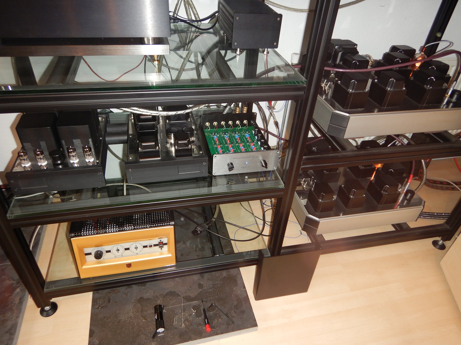

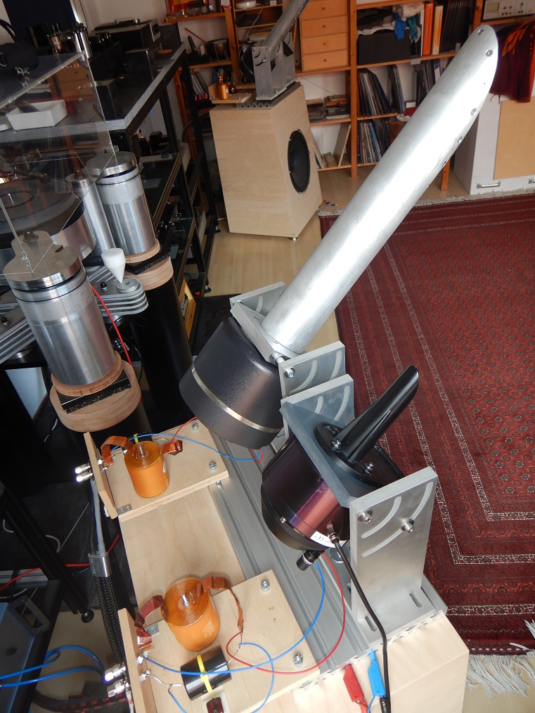

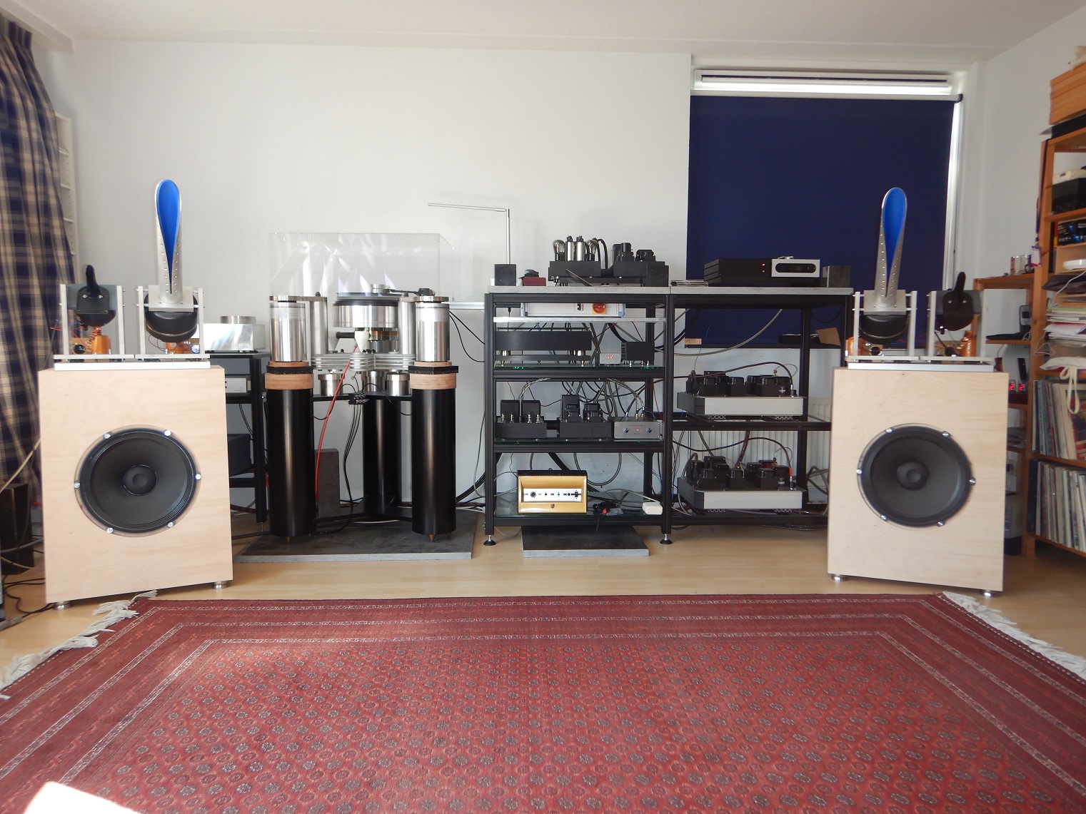

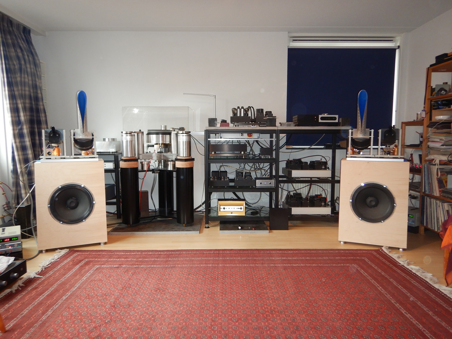

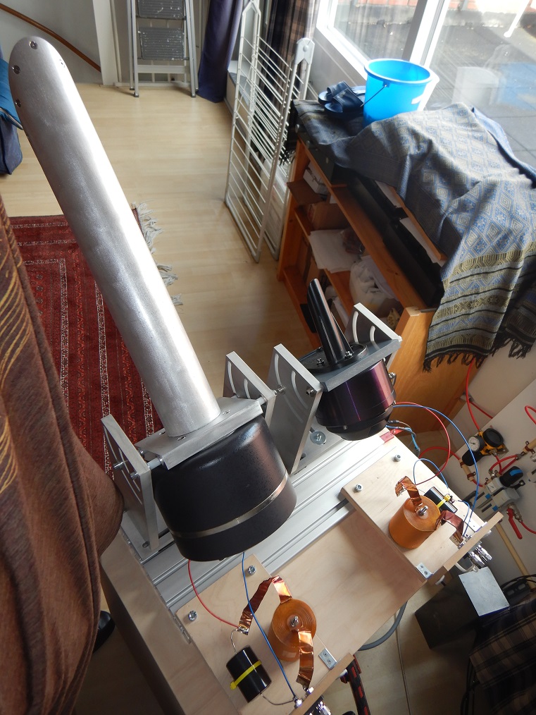

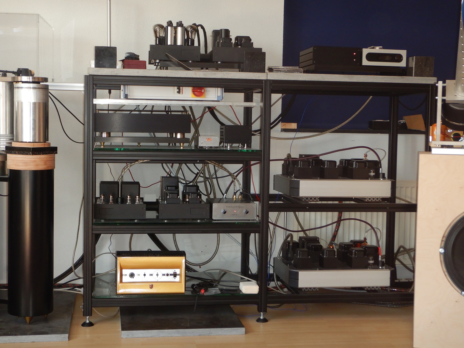

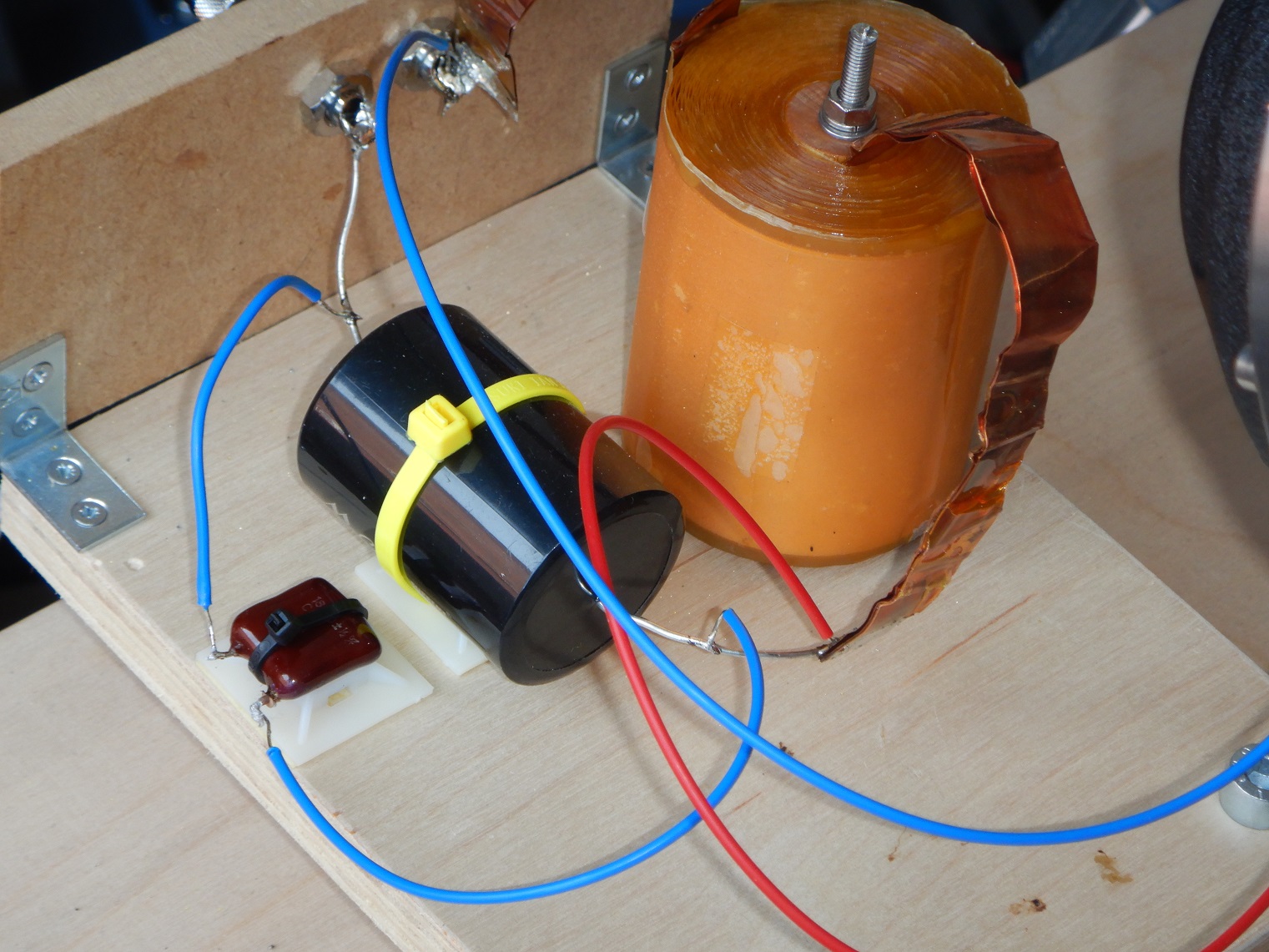

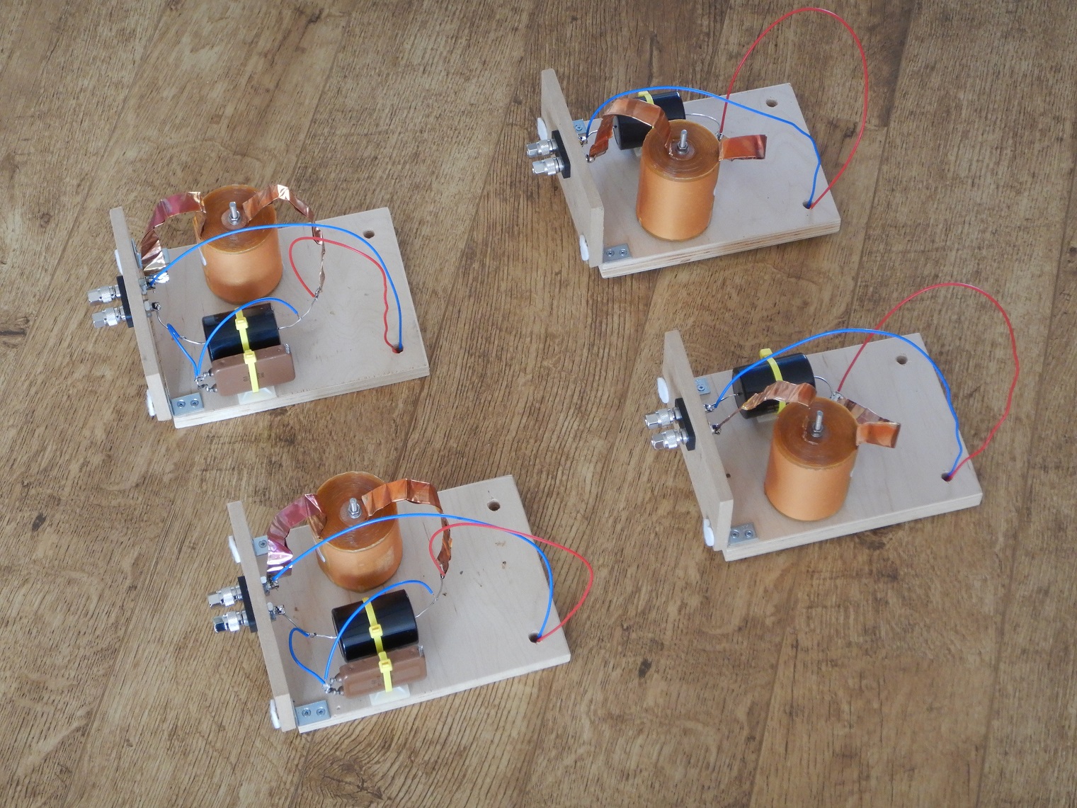

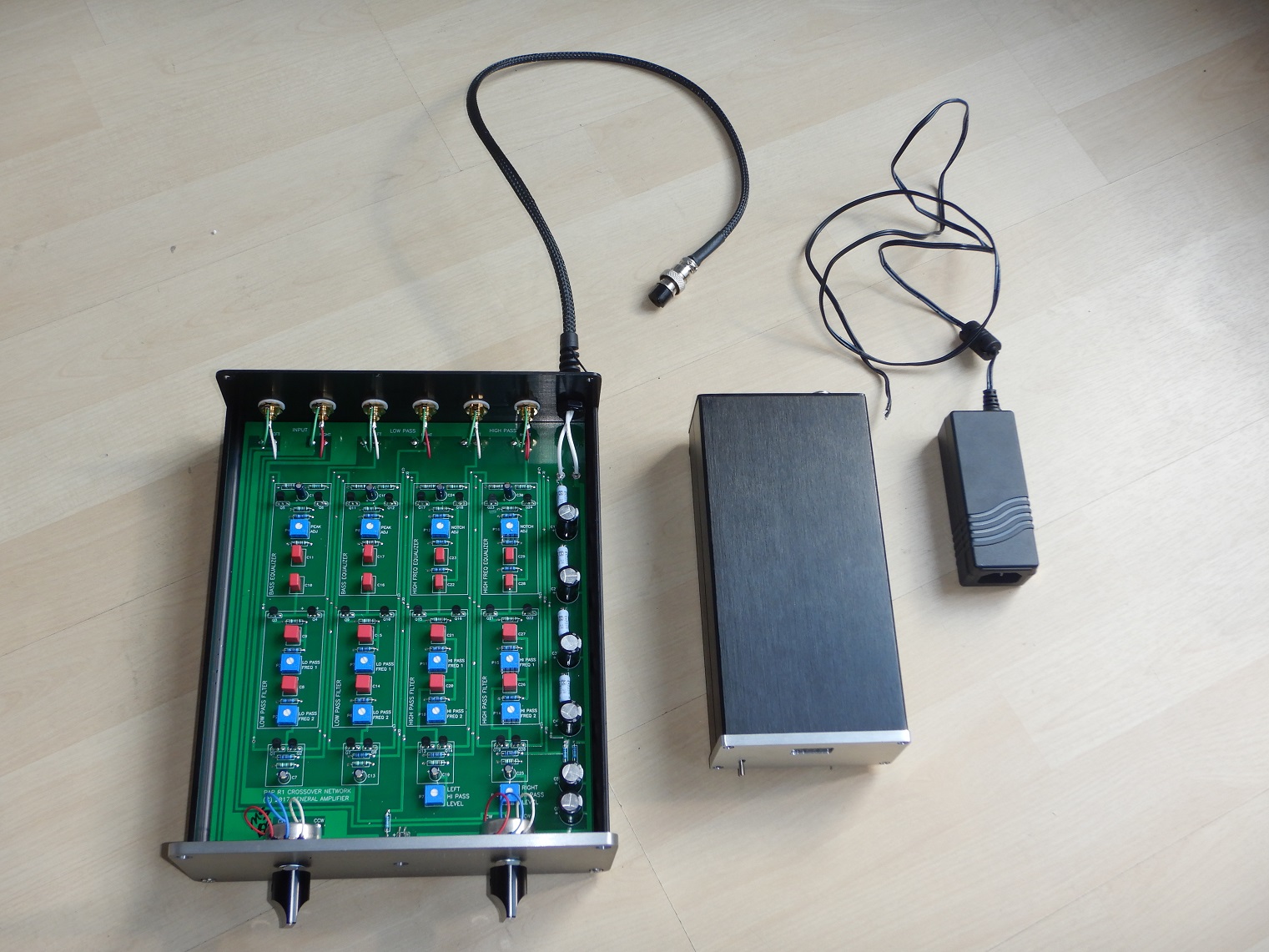

Absolutely not off-topic at all !!
Both active and passive have their pro's and con's. And i like to use their benefits to the max.
So i use a active analog XO to cross over the bass to mid/high. In this way i spare a serious bass-coil. Quality bass coils do exist (have used Mundorf VN390's) but even that quality can not match a proper designed/executed active analog XO.
See picture's. Guess who designed this well-sounding beauty (hint to writer of last reply).
From that same active analog both mid and high is being send to the respective amplifiers for mid and high (so no bass signal). From the respective mid/high amplifiers the mid and high compression drivers get their selected frequency job through a passive XO.
Simple 2nd order so you can invest in those few parts. I got good experience with Mundorf VLCU coils (way better then those rock hard foil coils; that wax impregnation works) and SilverOil caps (didn't prefer the SilverGoldOils).
So i use a mix with of passive and active analog crossovers to good results.
Of course i also tried digital XO's but that was a musical dissapointment.
The only thing i changed at the active analog XO was the power supply. Standard delivered with a ultra lightweight switching affair....almost as an afterthought. A simple but serious lineair affair improved the performance of that XO.
Pictures enclosed of my DIY system. It's tri-amped so i can manage each driver as good as possible. The loudspeaker has a field coil 15" woofer (Fertin 38EX), a Fostex D200a with oversized K-tube as mid and a Von Langa field coil A4000 compression driver with K-tube as tweeter.
Regards, Reinout

Thank you in particular for sharing pictures of your set up. I should probably post a few here as well.
I am curious about the horns - my system uses conventional bi-radial horns, and while I have seen pictures the devices you are using you are the first to post something using them.

What i really like with passive crossovers is the tweaking. A simple bypass cap can have a real effect on the overall outcome. Try to get rid of the metal glare of some compression driver diaphragms.....tweaking with caps can bring interesting results.
Exactly why i like to use both ways:
- active analog for bass (avoiding that huge coil)
- passive analog mid/high (with easy options)
Pictures of some bypass cap listening tests included
Reinout
