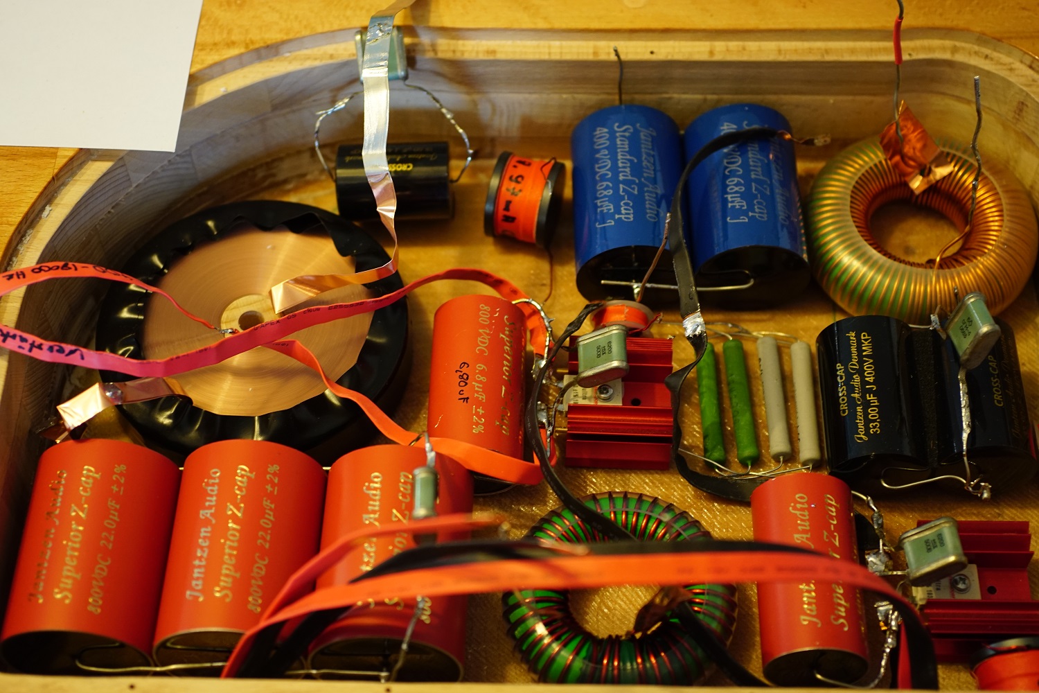

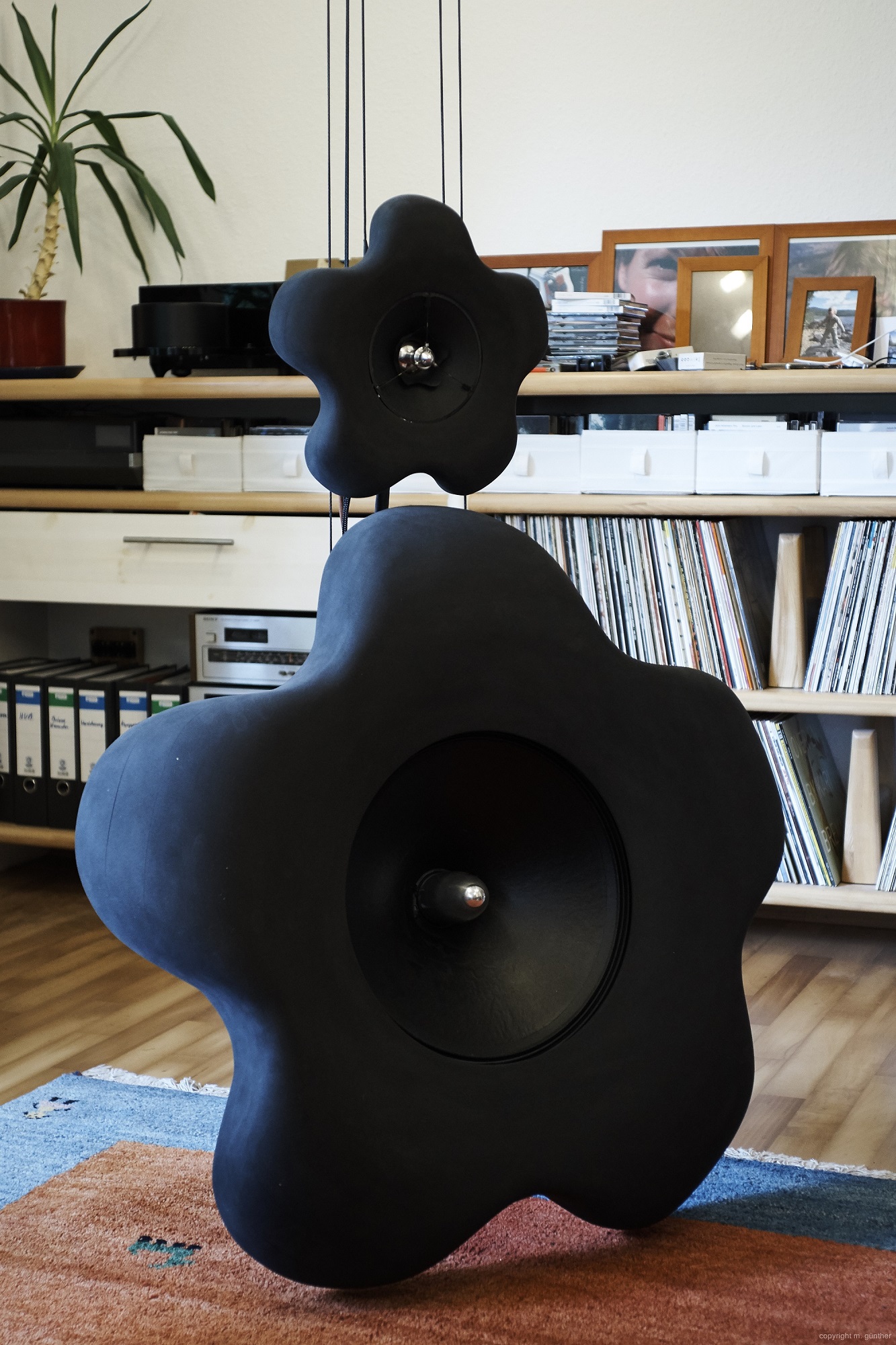

My reasons to choose passive filters over active ones are simply quality of music reproduction. I´ve tried quite a few expensive active filters, analog and dsp in the past, and always in the end preferred a really well-made passive filter.
This is a lot of work to make and can easily be much more expensive than dsp solutions with cheap amps.
While active solutions are of course a feasable way and make a lot of sense especially in complicated multiway systems, for my personal listening pleasure I prefer having a single DAC of very high quality, having an analog source of very high quality, and having just one pair of mono amps of very high quality. I simply couldn´t afford that in multiple numbers...
I do also prefer shallow filters - as shallow as possible, as steep as minimally needed. I also prefer relatively simple WAW systems, as simple as possible, but again of high quality implementation. A simple 2nd order/1st order passive filter (for my black flowers) is shown in the picture - that´s all out, not that simple anymore and not cheap.
But then, all this are my personal choices with which many may disagree. Everyones choice is valid if it provides fun when listening to music.

I found that the high output impedance of the 300B SE amps I use for driving the mids and highs are somewhat of a performance liability - I would get slightly flatter overall frequency response with amplifiers that acted more like an ideal voltage source. This is particularly the case with the 2440/2380 combo and was somewhat improved by using the lower impedance tap on the output transformer - flattened things out by more than 1dB when measured.
Resolution, imaging and stage depth all improved significantly compared to the passive set up, going from the Varicurve to the SHD further improved all of the above and gave me a lot more ability to fine tune to the room and my preferences, it also gave me electrical correction of driver offsets which are a problem in this system since I don't have space or means to align the mid driver to the woofer..
It is complicated and difficult to maintain, when it works perfectly it meets most of my original goals (there always has to be room for further improvement right?) It can't fix all of my mistakes but it does mitigate most of them.. 🙂
When it doesn't work perfectly there is a lot to go wrong.. Interestingly most of the problems I have trace back to things like worn out or defective tubes or other failing components. Understanding how to use a seemingly simple tool like Dirac3 plays a pretty big role too - it's quite possible to end up with terrible sound if you don't know how to use the tools effectively. Endless possibility for mistakes exist in a system this complex.
I'm an old guy with a lot of design experience and have chosen a path that suits me and my goals. It's not for everyone, OTOH I am not going back either.
My biggest remaining problem is likely this room, and that will not change. This house is where I will likely live out the remainder of my life so I have to accept its limitations and make the best of it. In most ways it's the best sounding room I have had bar one. It's also got some pretty bad LF room modes.. LOL
