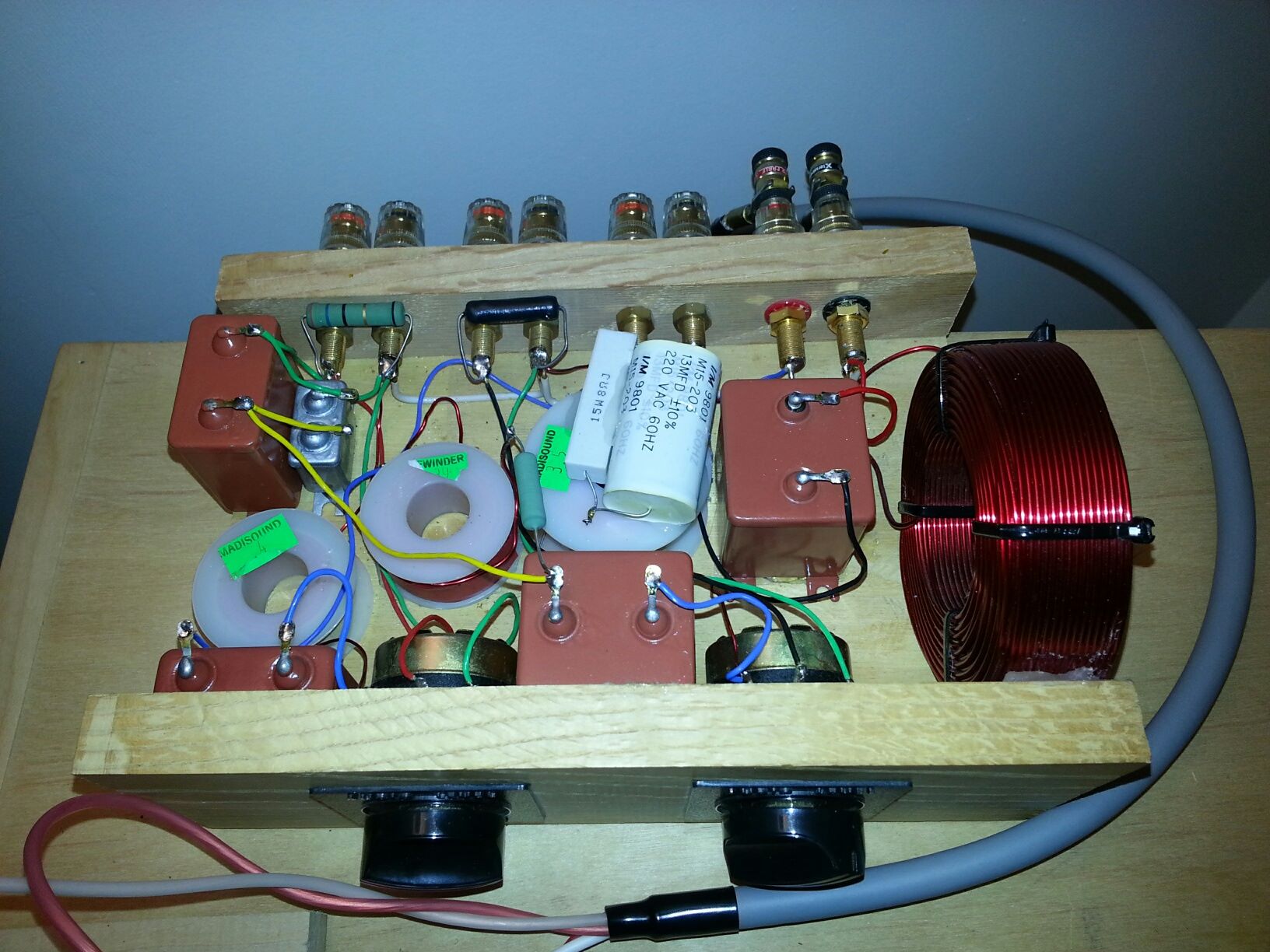

A simple 2nd order/1st order passive filter (for my black flowers) is shown in the picture - that´s all out, not that simple anymore and not cheap.
Offtopic, but would you care to expand upon the audible effects of the bypass caps which look like Soviet era silver micas?
There are actually much worse film caps out there, but OK.
That was a passive/active joke.
I can not know as I have not listen to your system which I surmise to be much more better than mine 🙂
There are some things you can do with passive components that you cannot do with active; such a zobel network to flatten impedance, notch filters, shunts, etc... These are things that affect the impedance and electro-mechanical response and damping of the driver, and can be combined with active or passive networks to get the result you want.
I forgot that I later changed to Russian MBGP military surplus which I found to be considerably better than the Clarity and Mundorf caps.. There used to be a lot of them on eBay: Hermetic Military PiO Capacitor 10uF 630V Russian USSR MBGP МБГП Paper Oil ~600v | eBay as an example - I found these to be quite good and much less expensive than some considerably inferior sounding metallized film. I've attached a very early picture of that XO, the sole plastic capacitor in the picture is the woofer zobel. A slightly improved version of this XO lives on in another friend's system. One of the big mistakes I made here and subsequently partially remedied was putting several of the coils too close together - I fixed later by re-orienting a couple of them. No evidence of coupling - not really surprising given the very low power involved.
The line level crossovers are 3 way 24dB/octave LR type of my own design. The capacitors in those are REL RTE polystyrene foil, 2% tolerance and selected where possible to 1%, and matched in the same location on the other channel. I kind of like SMD so the resistors are Panasonic 0.1% 1206 thin films, op-amp based, and there I selected OPA1641.. I/O is all balanced.
There is a lot of tube hardware in the system which demands periodic maintenance. I waited too long, having completed some repairs and whole tube replacements in the amplifiers.
It's a bit of a challenge when sometimes all you want to do is listen to music. I have a lot of sources as well - some like the TD-124s need attention soon. The Studer A810 is the only thing really at the moment doesn't need my ministrations.
