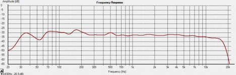

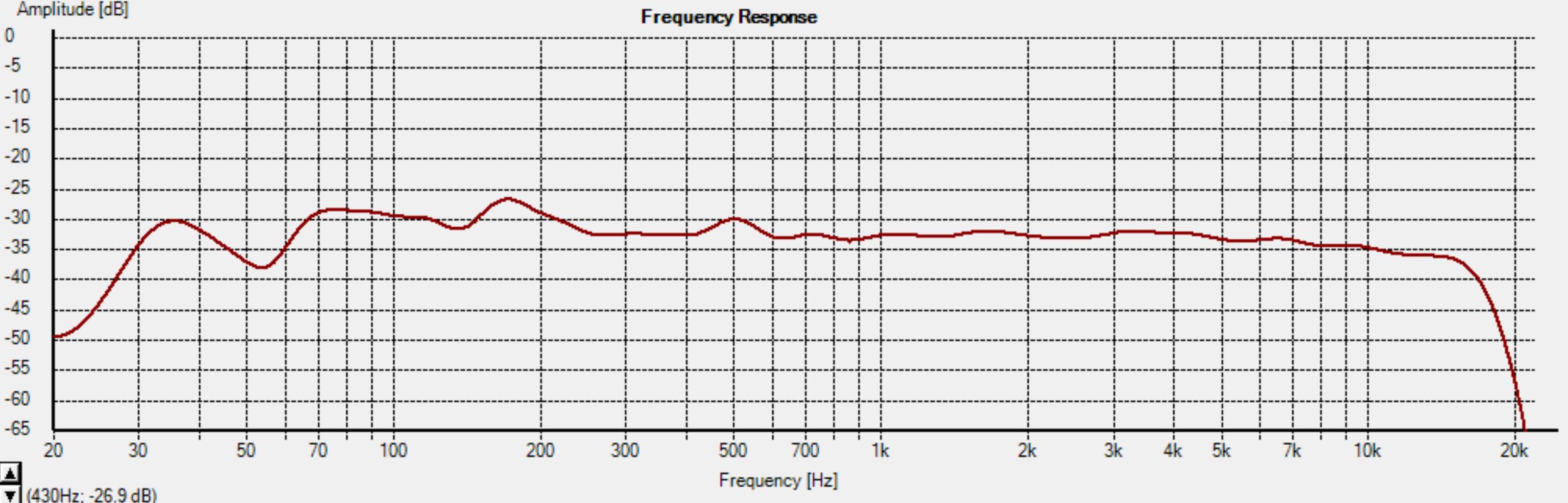

With speakers, yes, the classic B&K curve is a good start. I ended up with something similar for tonal balance. Flat from 400 Hz to 10 kHz, slight boost below 400 Hz, more boost below 100 Hz. The below is an in-room LP measurement with complex gating in Holm.

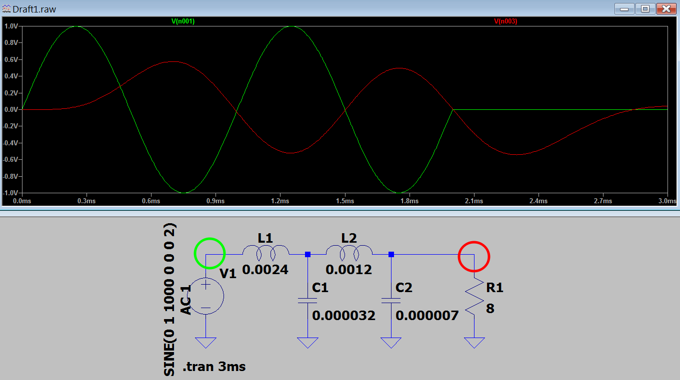

I've run this simulation to show what a phase shift looks like in the time domain. With input, the output Voltage doesn't move at first.. also it continues after the signal generator stops, ergo it has been delayed.
Such filters as this can be used to represent the effect of limited bandwidth.

If the high frequencies of the speaker are delayed a lot relative to the low, the bark may not sound like a bark anymore. Right, Mark? In reality, crossovers don't introduce so much phase shift and so it is never a problem.
Yep, i know all too well about phase shifts in the time domain.....from bandwdth filters. Heck, aren't I the phaseholic that's always bashing IIR xovers' phase shifts? 🙂
What i've been trying to convey, rightly or wrongly, is that the understandings we bring from measurements of limited bandwidth speakers, reproduction gear......don't seem to apply to natural sounds, productions.
Iow, natural sounds, productions, are not IIR, and are not matched by IIR speaker systems. Natural sounds don't match anything other than, they are what they are, imho.
