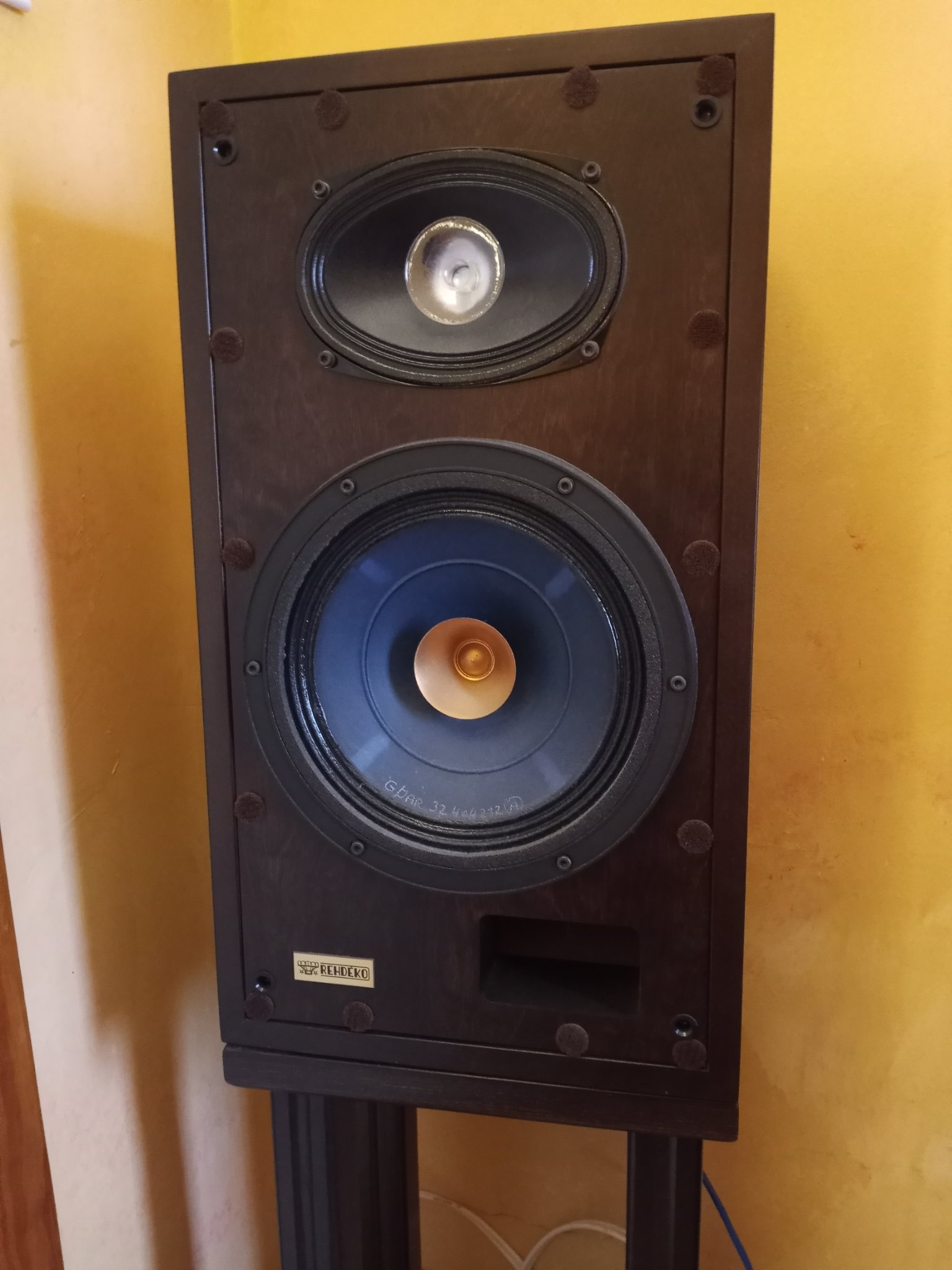

I have a pair of those in the middle...at least the one pictured resembles them
Grabbed from a portable ( I think Lesa) turntable set, 32Ω 6-7" cone with reversed magnet mount (in front ) and whizzer.
A true reference!
...30 yrs ago!
Now they're ( those...) are sitting
Last incarnation was a TDA 2822 piloting a 1:4 minuscule transformer
Outdated by TPAs...
Edit: no, mine have octagonal basket
It's an old Audax PA driver ,nominally 10" .
Very common in its days , now rather pricy and sought after.

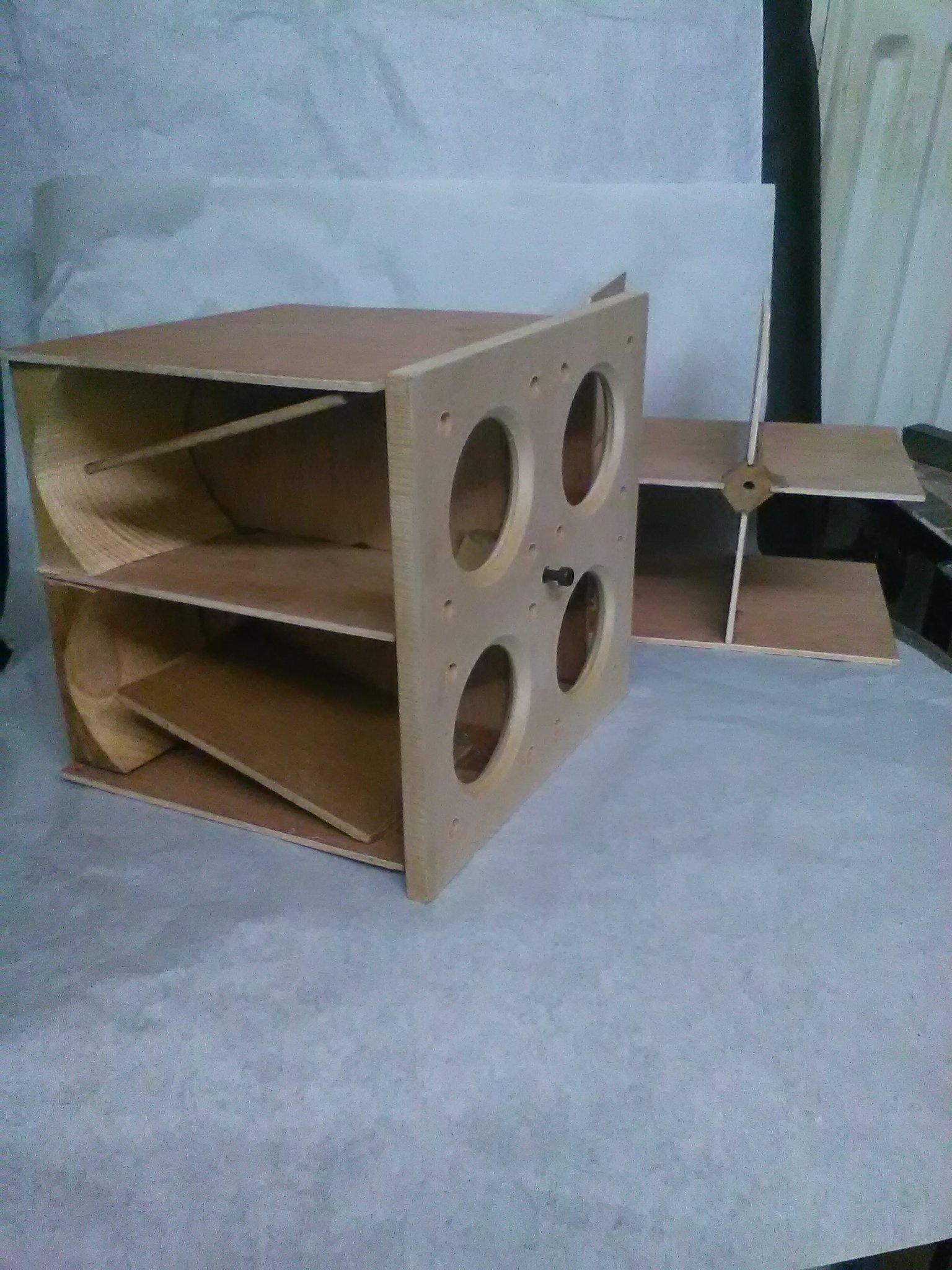

Or you could arrange 4 in a square, with the top outer, and bottom inner wired in series, and the bottom outer (with a low value capacitor across it) and the top inner wired in series, and the two sets wired in parallel (the capacitor to stop beaming). The cone break up of a small cone, but the surface area of a bigger one. I've only experimented with 3 inch drivers, but I would like to try it with 61/2 inch drivers.

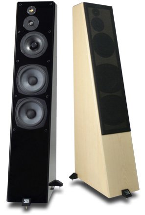

My friend listened to my "advice" and bought Reference 3A grand Vena. Of course I wanted to hear them hence the "advice" The "magic " fulrange" was run fullrange and pair of series connected woofers (16Ohm) ran parallel and was rolled off with big air coil , first order.
Damn midrange was running out of steam so quickly in a sizeable room as to be completely unusable. We moved it to a smaller room and could not get any music out of contraption . I took it to my home and gave up after a few days.

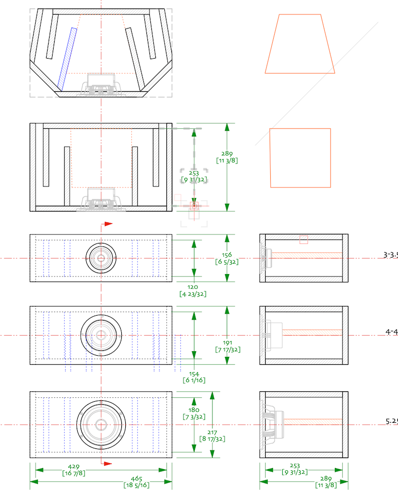

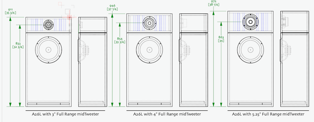

From 2021. SEAS A26 vented. Near the end of the A26 ReViz document. More a thot experiment. FR could be embedded in the box. It could be sealed. This is the CGR on the bottom, sealed, or any of the aperiodic boxes could be used.
https://frugal-phile.com/boxlib/A26-ReViz-0v90-080323.pdf
dave
