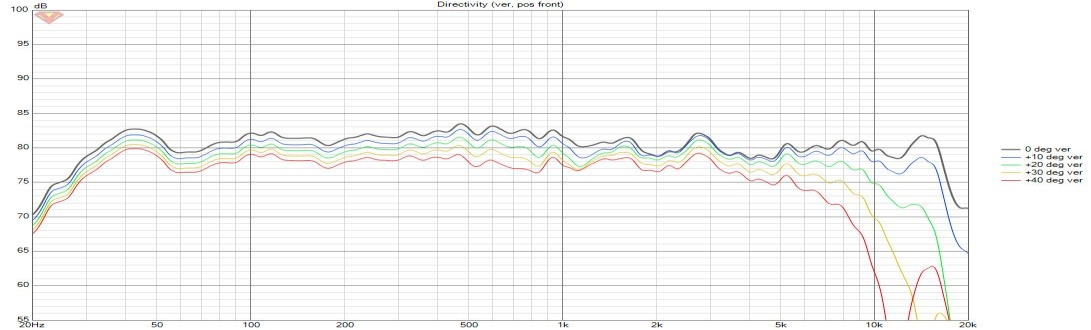

Fun and simplicity is one thing, but there is something to be said for the quality of the off-axis / ambient sound, especially if you're up and about. At least that is what I've found.
The tonal colour of reflected sound is more coherent. Narrower dispersion at HF produces a smaller 'mess' of reflections from the ceiling and walls mixing with the direct sound. And the lack of a crossover region means that reflections have a more consistent tonal colour. The reflected sound from a two-way system that I built is subjectively far more obtrusive. A comprehensive fix would be to cover the walls and ceiling with wavy foam to tame those reflections, but it's not an option. Adding a wave-guide to the tweeter would also go full circle in reducing the ±60° spray of high frequencies.

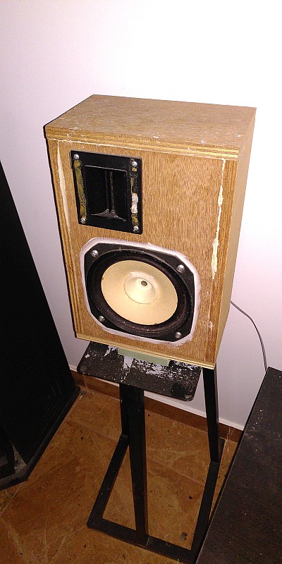

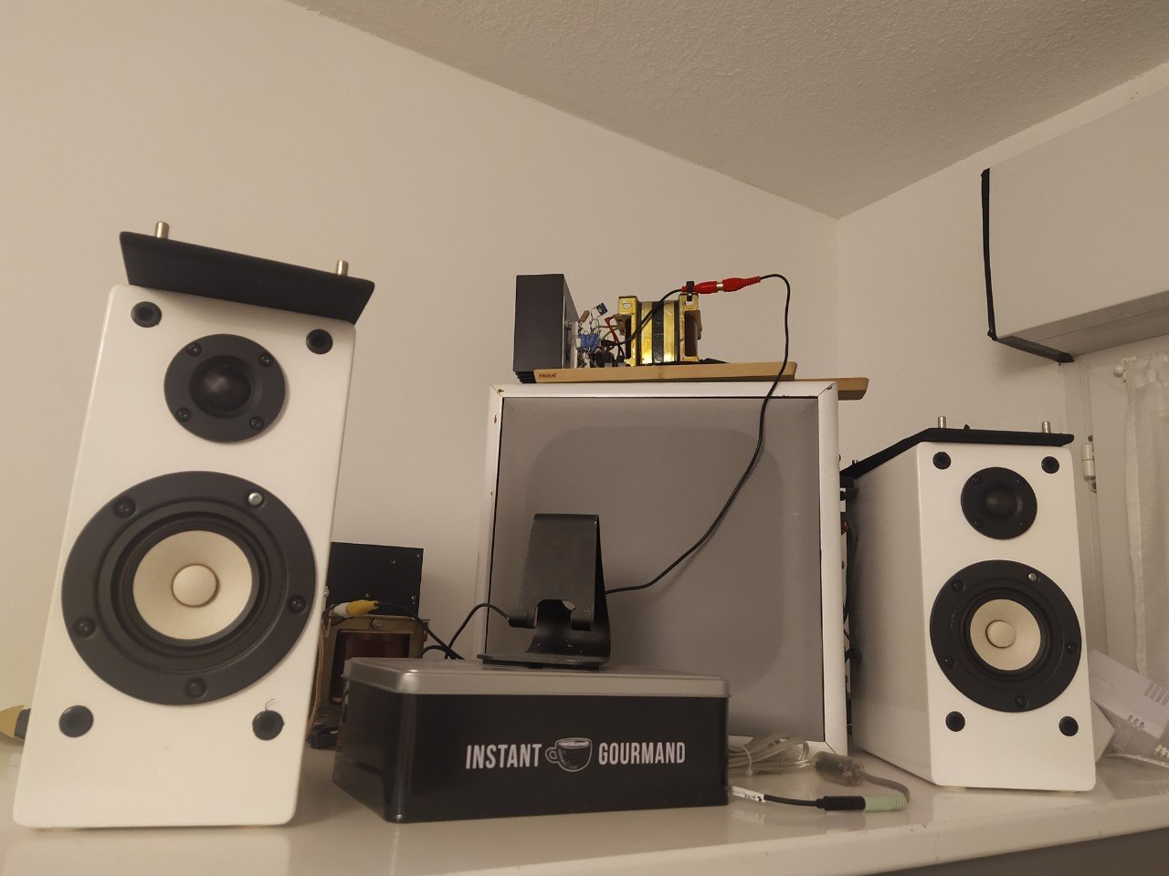

FWIW, at the moment, due to circumstances, I listen to a unfiltered, uncorrected full range speaker in a small closed cabinet. I bought the chassis looong time ago, it is not for sale anymore. It's a 6.5" Fostex/ACR FE164 that I bought to go FR (at that time this concept regained traction, due to the interest in Lowther speakers, which I could not afford at that time) and at first I made a (heavy!) concrete closed cabinet with the edges tapering off for it. Very nice. After that, I used it in a tractrix rectangular fronthorn (Bruce Edgar style) with a smaller mouth than the driver for some compression. I put the FE164 aside, when I discovered the BMS 4592ND CD, when they came on the market. From then on, my system evolved around those drivers.
For another room, I decided to build a small speaker with the FE164 again, this time with the top end augmented with a Fostex magnetostatic tweeter with the same 91dB sensitivity, filtered 1st order (only one series capacitor) at 8-9kHz for some air and better dispersion of the higher frequencies. I damped the wizzer cone with a little bit of longhair wool around the outer perimeter between the whizzer and cone. The cabinet is stuffed with real longhair wool.
The amp I use at the moment is a Sony AVR and the bass is served by a 80Hz filtered active Sony ported subwoofer from the 2000's. The "satellites" are not high passed and as such directly connected to the amp output without any intervening crossover components.
Because I migrated to another EU country, my inventory is still in storage including my big horn setup. To have some music in my small rented house (I will soon move to a much bigger house, where I will setup my big horn rig again) I put the FR speakers on simple target stands, leaning backwards to align the tweeter and FR driver and sticked them very close to the back wall. The sub is in a corner. Because the music is in the midrange, it's caracter is preserved in a musical way but still you have the air and slam with the tweeter and sub.
I must say, with good recordings, they really shine (to my enjoyment.. at lower volumes I do not miss my big horns, shame shame) and when recorded as such, f.e. a piano, it is right there in your room, very realistic with good sense of scale. The sound is seamless with correct tonal representation of f.e. saxophone. Dynamics are pretty adequate and can play +80 dB easily. Female voices, recorded well, are a dream. You can throw any music at it, whether it is reggae, dub, house or jazz, it plays it. As being point sources for the most important midband, they also image well. Unfortunately, I do not yet have any measurements but it sounds balanced and crisp as it is, so no real urge to try to improve it. An improvement would be the flush mounting of the tweeter and driver, and maybe better cabinet damping, but for the intent of just having something small around, I do not strive for perfection.
The room is very reverberant, but it does not really harm. The back and front walls are slanted about 10 degrees -so no real flutter echo's appear. If I had no other speakers or a critical wife, I could very well live with them. So my advice for OP is to at least consider the Fostex FR drivers currently available, and augment them with a supertweeter and active subwoofer. Hardly any filtering needed, to preserve the music in the wide midband. I agree it is not a strict one driver full range solution, but it does cope with the weaknesses of having only one driver.

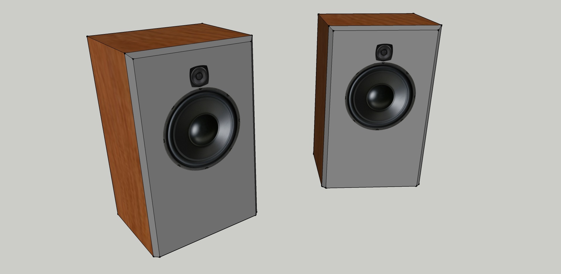

Yes indeed, Good results very possibly. Took it to a further extreme for fun with some low cost drivers. Try 2.5" wideband and 12" high Qts sealed woofer.I think it's possible to cross-over a 3-4" fullrange/wideband to a 8-10" (sub)woofer and get a system that falls in the full range area. Like the systems in the WAW thread. I think they would make great bookshelf speakers or even monitors.
Center to Center ridiculous good at that point. was actually accused of not being designed correctly the =vertical looked to good to be true.
Rather large enclosure for sealed high Qts. Member Cannon Fodder tested the concept with a foam mockup. Nicknamed WD-BG ( White Dragon Big Girl)
All for fun with low cost drivers.
