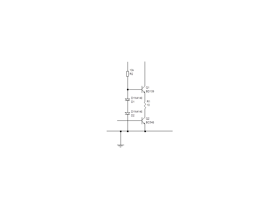

Hello
Looking in some other VAS I've seen this one, anyone know the pros and cons of this VAS ?
Thank
Bye
Gaetan
Gaetan,
It might be better to put the limiter on the collector rather than the emitter side, still measuring current, but set to a ridiculous current well short of the max collector current but much higher than the VAS operating current.
If you place it on the drive (base) side, there will be a transition zone of activation which could affect the sound quality.
Hugh
Hello Hugh
I was not sure about this VAS, usually I don't use a current limiter in a VAS, so I did asked for the pros and cons of it.
Btw, I've just look in all my amps schematics and this VAS was coming from a Leach amp, the image I've post was the VAS alone (no amp schema) from a web site.
Thank
Bye
Gaetan
The Leach and similar amps that have current and/or IV limiting on the output stage can overload the VAS when the limiting activates.
The extra transistor is there to prevent the VAS being driven to destruction by the LTP trying to force the VAS to drive the current limited output stage when it is already overloaded.
The sum of the two resistor is the required degeneration that the VAS needs.
The BE resistor should be sized to drop ~2/3 Vbe (~400mV) when the VAS is passing ~ two times it's bias current.
If VAS Ib=10mA then VAS can go from 0mA to 20mA and not be overloaded. When running at upto this range of currents the Protection transistor must not interfere with the VAS feed from the LTP. If the lower resistor is 20r then 20mA of maximum VAS peak output current produces a Vbe of 400mV. The protection transistor will be fully active when the VAS current rises to ~30mA (~3times Iq).

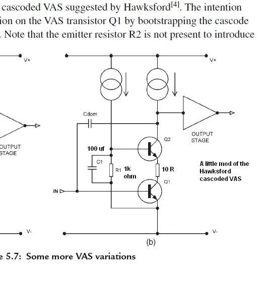

Hello
I know that there is different opinions about the listening result of a cascoded VAS in a amp.
But can we use a Hawksford cascoded VAS, without a buffer transistor, with low power amp (up to 40 watt) ?
I just want to know more about it.
Here is an image of a Hawksford cascoded VAS with a very little mod. I could use this one with a 30 watt amp ?
Thank
Happy New Year
Bye
Gaetan
...a Hawksford cascoded VAS with a very little mod.
Hi Gaetan
That "very little mod" completely defeats the point of the Hawksford cascode.
Have you read the Hawksford article itself?
Worth some effort even if it's written a bit obscurely.
Personally I find it easier to understand as an internal feedback loop, but perhaps that's just me.
Best wishes
David
Hi Gaetan
Best wishes
David
Hello
Can you email me this article ?
gaetan888 at gmail dot com
Thank
Bye
Gaetan
Hawksford cascoded VAS... from the book of Douglas Self...
What edition is your book?
I have the 5th edition (Focal Press) and there is an emitter resistor for Q1.
That resistor is essential to make it a "Hawksford" cascode, as opposed to just a cascode.
It looked that you had removed this resistor for your "very little mod" but it seems D.Self or the book publisher messed this up.
Best wishes
David
Paper is here. http://www.aes.org/e-lib/browse.cfm?elib=5157
