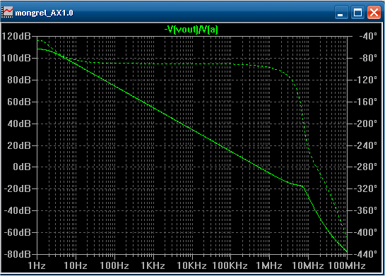

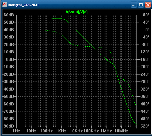

BTW , I know on the simple bootstrap amps .. I have measured close to a volt between bases on the differential. I just measured my GX (luxman) , just under 20mv for 130v p/p. confirmed on the real thing. All my "new" amps show nearly nothing (<5mV) as far as voltage differences between base voltages. 😕
As expected on a well designed high NFB amplifier. What freq did you do the measurement at?
1k and 10K (2V input).
AX is the standard "blameless" (Bode att. 1)
GX is the big amp (120v p/p) (Bode att.2)
Ax has over 100db gain , it is the one that sounds sterile (but good) , and does not even show a couple mV between bases until you go "nuclear" at over 100v p/p.
The GX only has half the gain but sounds nicer in general , it deviates up to 20+ mV when "pushed". So , the "cause and effect" holds true between OLG and the differential. I've never tested this before. Both are stable , run basically the same NFB network , only differ in loop gain.
