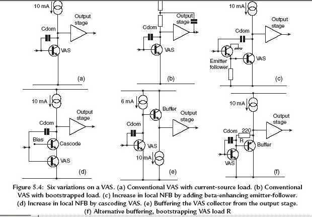

Hello
Wich one are better between the VAS E (buffering VAS collector...) and F (the bootstraping VAS load R) in the image I include ?
I've try the VAS E (buffering VAS collector...) in simulation, but connecting the collector of the buffer transistor to the upper rail did not work correctly.
For now I mostly use the VAS F (the bootstraping VAS load R), and I just found out today, in simulation, that raising the 220 ohm R up to 8K ohm reduce the gain and the distortion of the VAS and amps.

Gaetan's thumbnails :
In "e" the 220 Ohm resistor is bootstrapped by the emitter follower, itself loaded by a CCS : the 220 Ohm presents a high load to the VAS.
In "f", the VAS is loaded by a first CCS and followed by an emitter follower conventionnaly loaded by a second CCS. So "f", with its two CCS's, has more components than "e".
Some time ago, there was a question about the difference of quality between "e" and "f", and there was no response.
According to Self, "e" is more distorting than "f" :
Discrete design: More on 2-transistor shunt-feedback amplifiers
Having used a bootstrapped resistor in the VAS of his Mosfet amplifiers, Mike Renardson found that, for ultimate performance, this resistor should be replaced with a CCS, which, in fact, turns out to be a bootstrapped CCS. Its implementation needs a bit more of voltage drop than the 0.6 V across the previous resistor :
MJR9
Some simulations tend to show that the circuit of a VAS loaded by a bootstrapped CCS itself loaded by a second CCS (like in Renardson's scheme) gives slightly lower distorsion than "f". This is quite normal as its first CCS
has almost constant voltage across it. It may also have a superior PSRR.

I've tried both.
1. A 'buffered' VAS (C from Self above) simply gives better VAS linearity because the extra small signal transistors raises the VAS loop gain enclosed within Cdom. The correct name for this is a 'beta enhanced' CE VAS stage. Simple and works well on fully complementary designs with resistive LTP loading as well.
2. Cascode ('d' in Self Above). I have an amp running with this - fully complementary design. Zo is high, but the trick it to feed the VAS into a triple EF output stage. Re the 'magic resistor' you can also use this resistor as a current limiter for the VAS when the output stage current limiting kicks in.
3. Others - have'nt tried them, but my next power amp will use a Hawksford cascode.

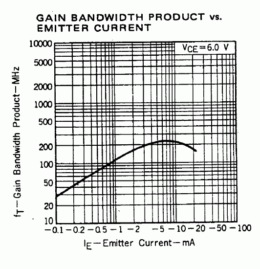

I did try other VAS, I've found the beta enhanced VAS (image C) harder to stabilise with low value cdom capacitor, and the VAS buffered collector (image E) was not work as I expected.
So I've go back to the bootstraping VAS load R (image F) , but rainsing too much the value of R (the 220 ohm resistor) cut the current to the VAS transistor collector and cut a lot the bandwith of the KSC3503 VAS transistor. A resistor R of 220 ohm are quite right since the VAS transistor and the buffer transistor will have quite same current but maby the buffer one need more current than the VAS one.
