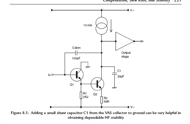

Looking at the 2009 edition of D. Self amp book, there is a beta enhance vas using a hf compensation cap (C1), any one have try that C1 with this type of vas ?
Btw, in his text Self suggested a quite big cdom cap of 100pf for the beta enhance vas, even without a phase lead cap, a 100pf cdom cap are much bigger than needed.
Here is the image of the beta enhance vas with hf compensation cap C1.

comparing this to post27, I am confused.With beta enhanced VAS you have two lag compensation choices; from emitter of buffer to VAS base, OR, from collect of VAS to VAS base.
Is Q1 the buffer and Q2 the VAS? Q2 is the device sending output to the next stage and I have interpreted Q2 as the VAS.
Q1 buffers the VAS input.
But, could your description have swapped VAS to Q1 and Q2 is a buffer on the output? But Q2 cannot be a buffer it is a common emitter stage.
The pic above is the classic 'beta enhanced' VAS. Q1 is the 'buffer' and Q2 the VAS proper. Again, 'buffer' is not really what Q1 is - its there for beta enhancement to raise the VAS stage loop gain. I have looked at overall amplifer loop gain with and without beta enhancement in the VAS stage and the difference is about 12dB (simulated, but its quite accurate enough in this case) so Hugh's comments above are spot on in this regard. As to why DS seems to require 100pf, I cannot understand. I'm getting away with 33pf and 10mA tail current (yes, I like to run it HOT and fast !!). Then again, my LTP degen resistors are 150 Ohms, so loop gain is quite low.

If Q1 is buffer, and Q2 VAS, then the two choices are collector of Q2 to base of Q2, OR, collector of Q2 to base of Q1.

Can I guess that Leach thought along the same lines with 300r of degenaration in the LTP emitters?If you increase stage current in the LTP enough, you can add degeneration, in your case to straighten the normally S shaped transfer function, and keep gm of the first stage unchanged over low stage current, zero degen. This trick means that you keep the same loop gain, but you widen the linear operational region of the LTP, so that the error correction remains more accurate for a given loop gain.
For a VAS with active load and emitter to rail, gain set is maximum, and depends largely upon beta
I thought the gain of a CE stage was Rc/re where re was the VAS transistors internal emitter resistance and Rc is the external collector load, which for a CCS depends on the transistors early voltage (rc proportional to 1/VEarly) which is why the gain is so much higher han a resistive load that delivers the same bias current.
Yes, but if for example we use a perfect CCS, a fictitious beast, with Z of say 2M. If the VAS runs at 6.5mA, re is 26/6.5 = 4R, and theoretical gain of this common emitter amplifier is 2exp6/4 = 500,000 or 114dB. I have never seen an OLG of 114dB on a conventional single stage VAS audio amplifier, typically loop gain is about 65dB max, which with CLG of 30dB indicates 95dB of OLG.
So clearly OLG does not approach the calculated limits. Something is holding it back. That something is die geometry, and particularly beta.
