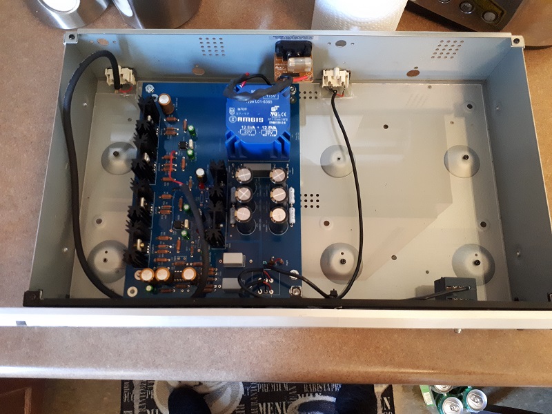

Hi, can someone give me some advise on the thickness of the wire connecting ac to the board.
i am looking for solderable C14 iec inlet with switch, and i found this,
4304.6079 Schurter Inc. | Connectors, Interconnects | DigiKey
is this good or is it a overkill?
The inlet module is very nice!
Wire gauge required is more a function of length than anything else, if less than a foot 18ga or even 20ga would be fine. Use what you have, and you can always double it up if you are worried.

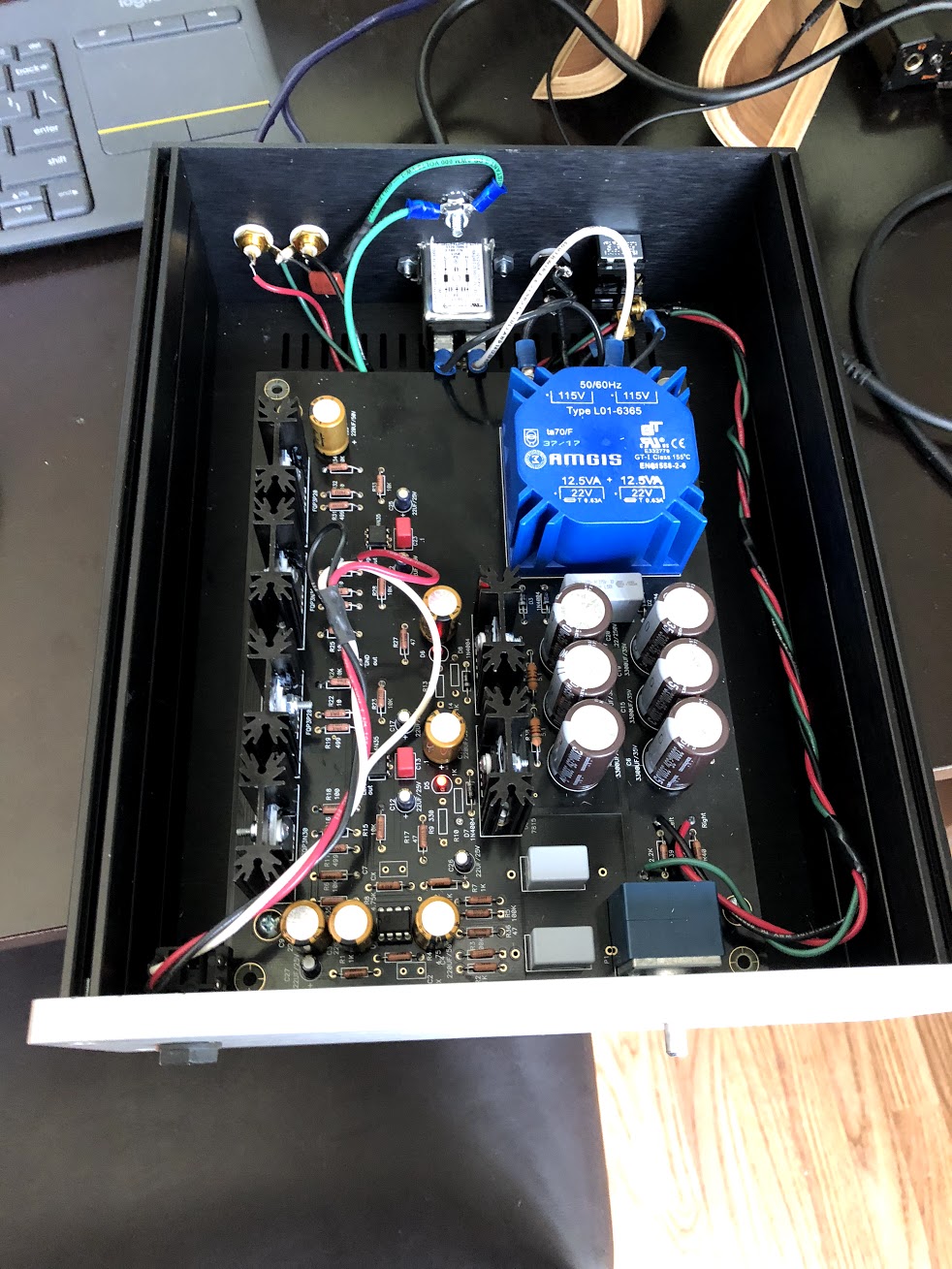

Almost complete, Need to tidy up some metal work, add a volume knob, and add a Headphone jack. Sounds very nice driving my A40. A big thanks to Wayne, 6L6, and alexcp (who sold me the board).
Those are very nice. I have used before for a power amp.
Its not overkill. You also have a power switch and you only need one opening for everything.
