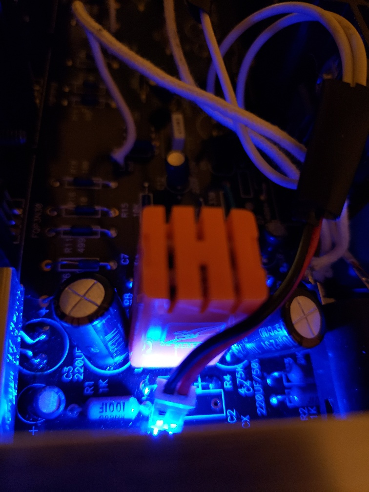

Looking for a part number for a blue led (mouser or digi-key) to use like mark johnson used...off of trafo secondaries....also what value of limiting resistor should be used?
Alex

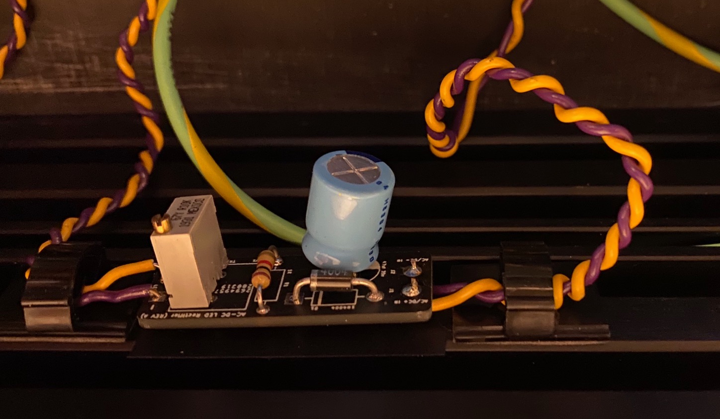

I used these blue LEDs:
https://www.mouser.com/ProductDetai...moCkIWNKZPhms%2BJcXfkLsoIev9TD00Xpn/Rv9/mCg==
I used a 1k in series with a 200k trim pot (https://www.mouser.com/ProductDetai...ronics/67YR200KLF?qs=gQBTb7UQo2JGOjeea5fZCQ==)
Noting that I am using a diode/cap in front of it as it is right off the secondary tap of the transformer.
One easy way to figure out what the R value is, is to build a small test rig where you have a small cap + 1N4004/7 diode ahead of the resistor/trim pot/diode that lets you connect a bench DC supply that you can set to your full project's supply but in a controlled way. This lets you dial in the brightness you want/etc... if you don't want the user to set this.
I built my "test rig" using the nifty little board that Gaz2613 created (its shown in my build pix earlier). Its basically wired up with a barrier connector on both the input and outputs so I can connect my bench supply to the input, and the LED in question to the output with the trimmer pot set to its min. Then I can set things exactly how I want them and then go build that into the project.

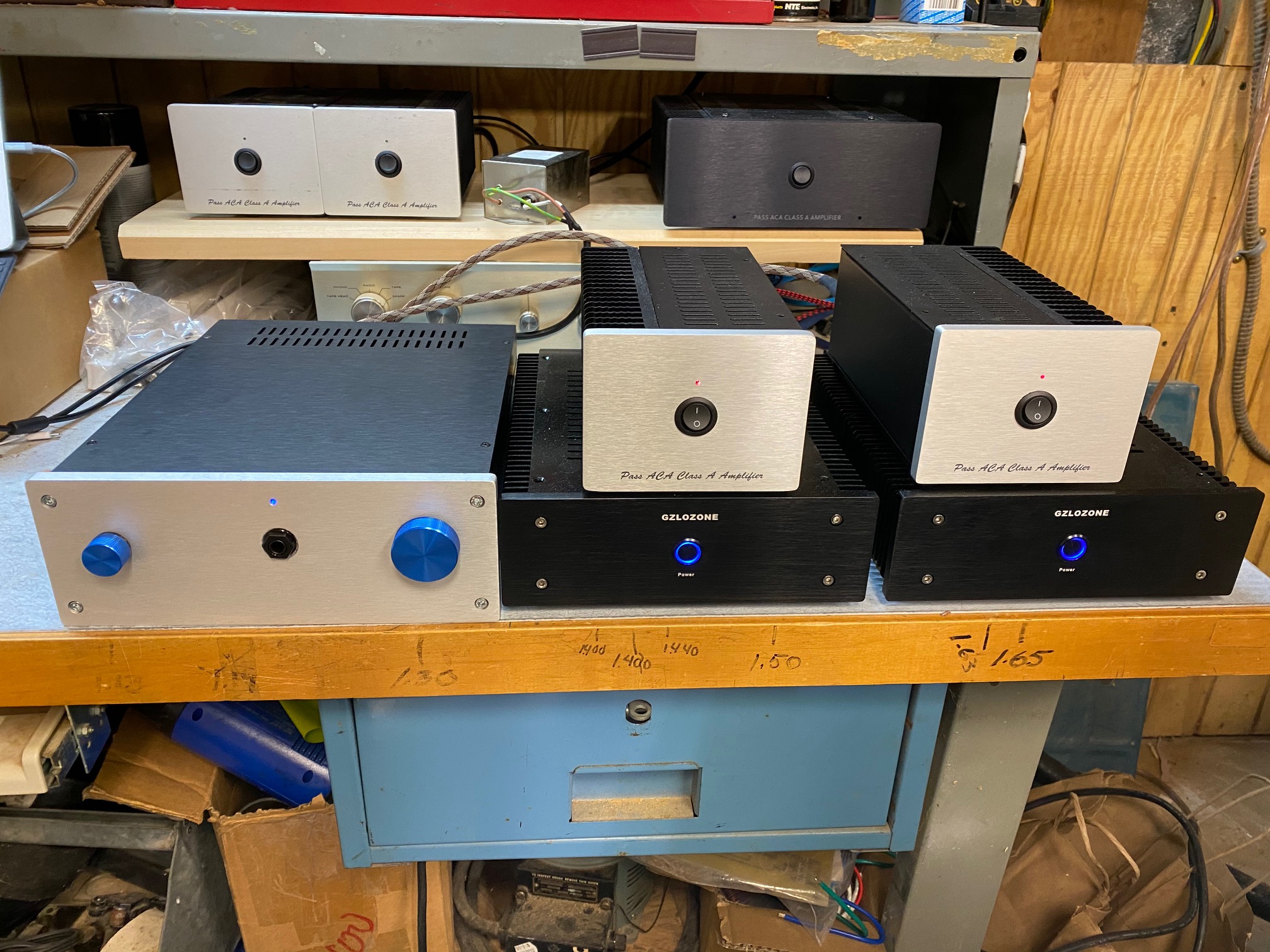

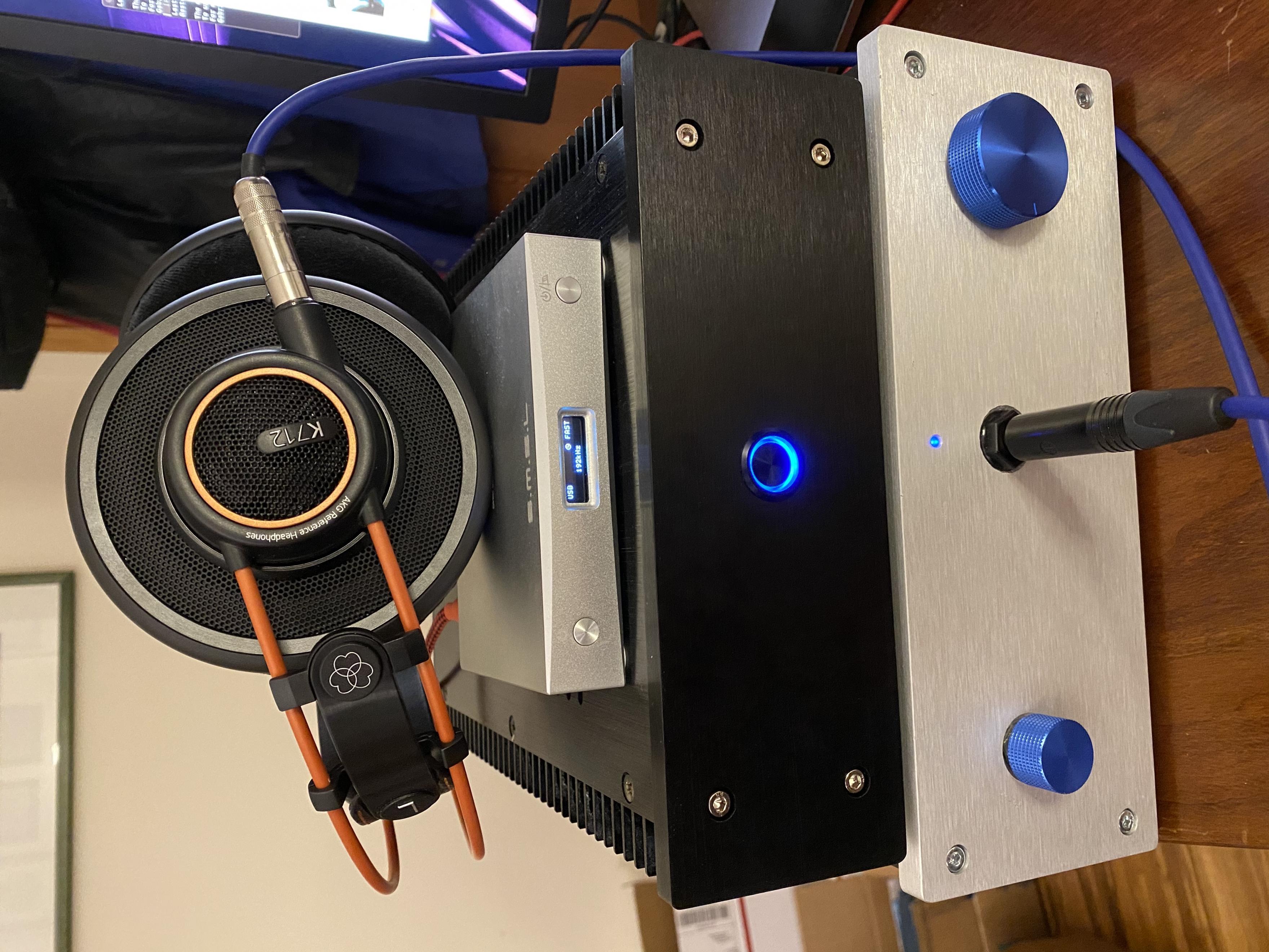

Hi folks. I recently received some Burson V6 Classic OpAmps provided to me by Burson for the purposes of reviewing them in the Whammy. I want to thank the wonderful folks at Burson for being interested in and supporting the DIY Audio Community.
Equipment Used:
Whammy "premium" build (see earlier in this thread for a detailed description). I used the Burson Classic V6 OpAmp of course. I used a SMSL M8 Mini-DAC set at 192k/24bit input, powered by a custom linear, regulated PS that I built. I used AKG K712 Pro headphones that measure out at around 60 Ohms.
I used the Whammy as a preamp driving 2 Amp Camp 1.8s run as monoblocks powered by 24VDC linear supplies I built for them. These were driving a pair of custom MTMs I made using Vifa drivers, and 12db/octave crossovers.
You can find a pictures the setup attached below. Apologies for the rotated image - No matter how I rotated the image, the image uploader insisted on rotating the image that way.
Material used for the review:
Mellancamp, Rough Harvest, Human Wheels. Spotify.
Close mic-ed. Very punchy/dynamic. Excellent tonal balance. Highs/lows pleasant. Male and female voices neutral. Spacial separation excellent but presentation up front. Closely mic-ed instruments very present. Very high male vocals "Ss" a tad harsh but not offensive by any means.
ZZ Top, Tres Hombres (expanded/remaster 2006), La Grange. Spotify. Very good imaging and dynamics of guitar. Opening bars have nice close mic-ed vocals. Other subtitles clearly like rim taps on drums. Multiple rhythm guitars clearly discernible with lead in the middle. Center presentation up close. Maybe a tad harsh on high guitar notes.
Dream Theater, Falling Into Infinity (96k/24bit source.), Hell's Kitchen/Lines In The Sand. Awesome dynamics and detail. Solid/flat bass. Top end balanced. Pleasing presentation. Fantastic imaging. Presentation wider but still "up close". Tonal balance excellent. Most of the non-TI monolithic opAmps I've tried on this song make it sound "messy". This clearly separates the instruments and is a treat to listen to - as if I were listening to the studio master. Bass harmonics at the end of Lines In The Sand (around minute 11) are clear.
Dream Theater, Greatest Hits (and 21 other pretty cool songs) 96k/24bit source, Lifting Shadows Off A Dream. Similar to the above - fantastic separation, detail and balance. Introduction is "heavy" in that the bass is solid down. Clear imaging. Guitar distortion is clearly that of a Mesa. Male vocals are clear, not harsh or "over-bassed" or "smeared" which many monolithic OpAmps did. Similarly with cymbals. They were not harsh at all and very realistic. As with the previous 2 tunes, this is a good test of just how clearly resolving the Whammy can be with a discrete OpAmp installed.
Diana Krall, Turn Up The Quiet, Like Someone In Love
Excellent female vocals but a touch of harshness on "ssss" on S phrases. Very present and up front. Balanced. Can clearly resolve lots of detail of her voice including taking a breath between phrases. Decay of reverb very realistic.
Jessie Cook, Free Fall, Incantation. Super low low bass. Guitar well balanced. Very good dynamics and spacial imagining. Lots of "air" around the instruments. Decay of reverb very realistic.
Bruce Hornsby, Solo Concerts, Mandolin Rain. Well-balanced piano up and down the keyboard. Excellent dynamics and "air". Male vocals closely mic-ed. Can clearly resolve lots of detail.
Gordon Goodwin's Big Phat Band, The Gordian Knot, T.O.P. Adjacent. Fantastic dynamics and imaging. Good instrument placement - pin point imaging but presentation is "close up".
Conclusions:
General comments: The presentation is much more focused than the SparkOS I have in the stock/kit Whammy, especially when using headphones. Center presentation up close compared to other OpAmps. Generally very pleasing presentation. I had similar results to the headphones when using the Whammy as a preamp albeit the inevitable bass roll off. Vocals and top end were still excellent. Imagining and dynamics were fantastic, exciting and engaging even at moderate listening levels.
The songs I chose provide a good test of just how clearly resolving the Whammy can be with a discrete OpAmp installed. Female vocals, low bass and dynamics are things monolithics have a hard time with, and the Burson Classic excelled at them. Male vocals and dynamics are other things that can suffer. I found the experience to be very pleasing. I was never fatigued or had to pause listening.
In conclusion, the Burson Vivid V6 is an excellent OpAmp. It has a certain "up front" or "close" presentation that some might or might not prefer. At this level, and in the top-notch Whammy, it is a matter of taste compared to the other monoliths that are readily available. I'd definitely recommend this to someone who is interested in this sort of presentation.
I will be reviewing the V65 Vivid in about a month's time, and will try to carefully compare the two together as well as with the SparkOS dual discrete.
Cheers!
--Tom

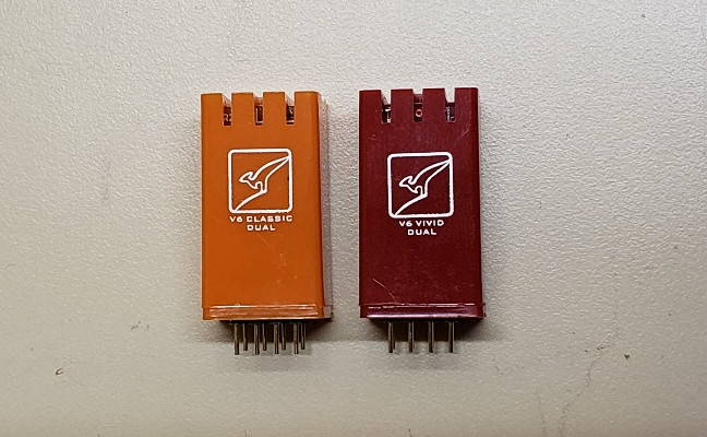

Burson V6 Classic vs. V6 Vivid
Thanks to Burson for providing V6 Classic Duals.
Summary? I like V6 Classic over V6 Vivid, in this application.

Vivid made instrument separation good. Classic let me distinguish between the different notes made by those instruments.
With the Classic, I started to enjoy the music.
I'll keep the Classic in my Whammy.

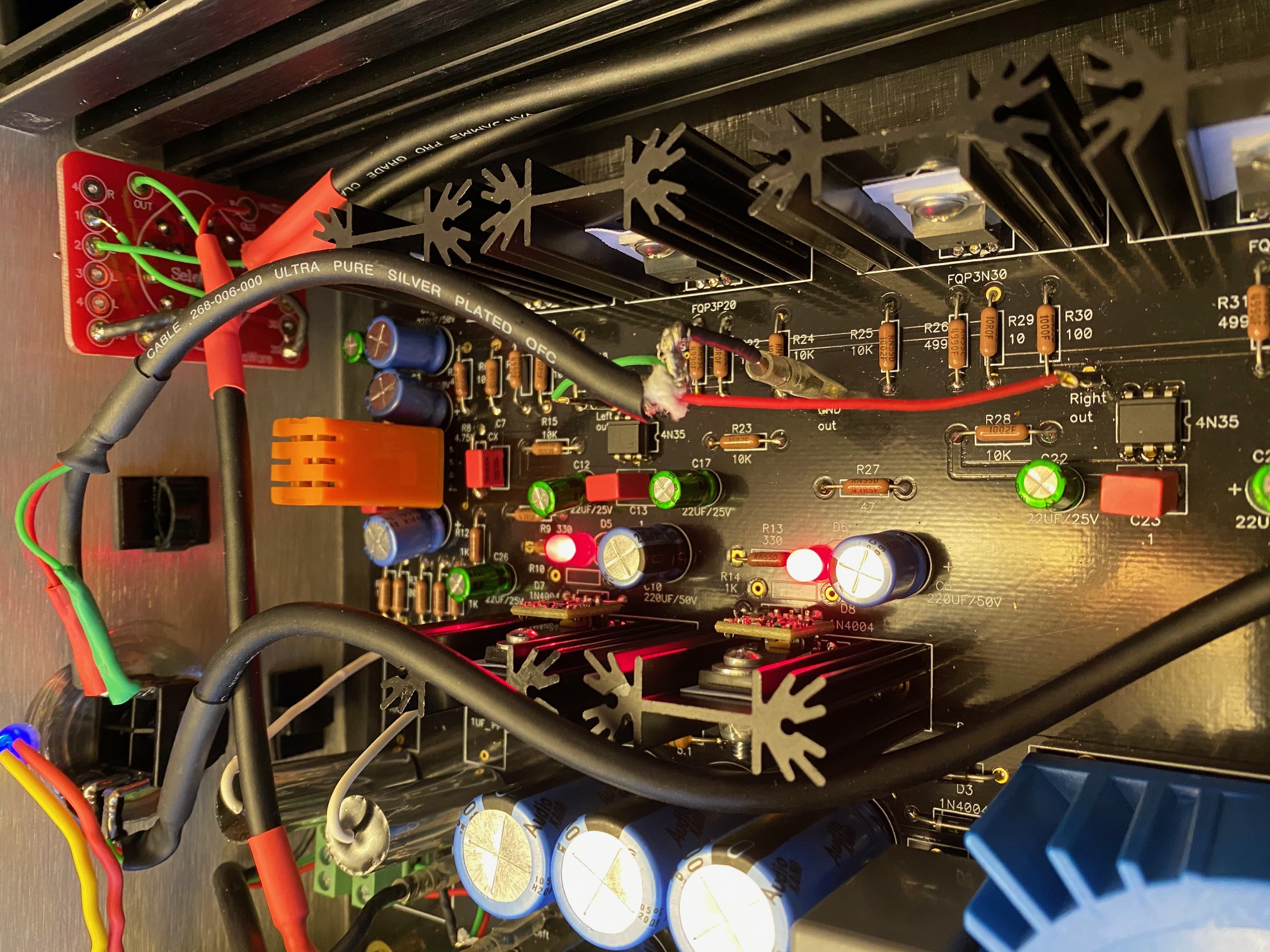

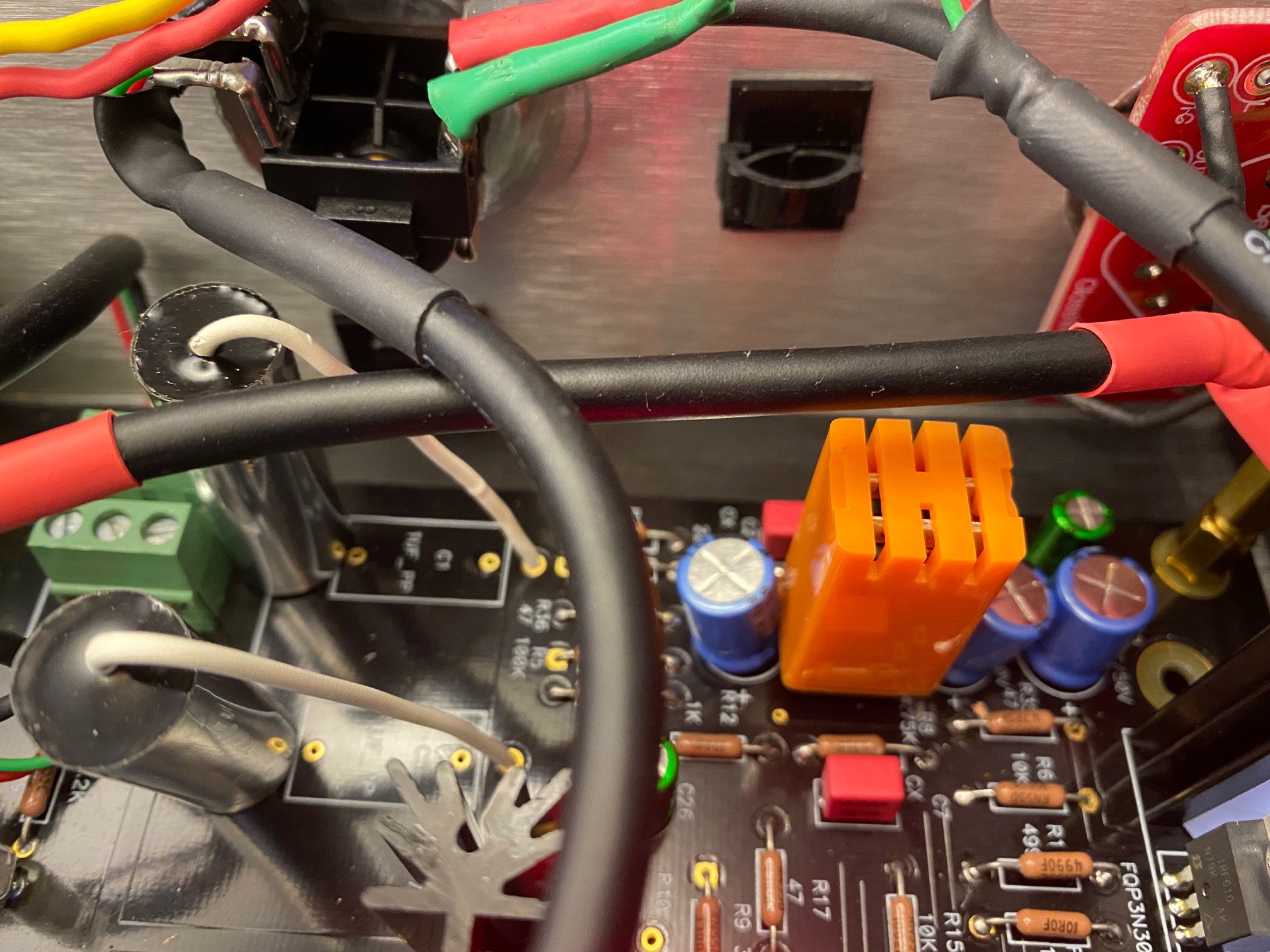

A few folks have asked me to provide detailed pictures of my second Whammy to see how I fit the taller Burson OpAmps inside, so I am posting some follow-up pictures here. Two specific things I did to make the Burson's fit which also applies to the SparkOS OpAmp too:
1) make sure the headphone input jack is positioned higher than the max height of the opamp.
2) make sure the caps around the DIP8 connection point has plenty of area around it. You see I had to bend back the Nichicon caps around it, and I made the leads a tiny bit longer to allow for this.
One limiting factor I found is that in the "kit" build if you mount the Alps pot to the board you are pretty tight on space in the front because the board is right up against the front panel and that can interfere too. This is why I ended up using the next sized up Galaxy chassis. Wayne was right in the original article that using the Hammond or smaller Galaxy will be a challenge and for me it was. I hope these tips help others get things situated in a way that works.
--Tom

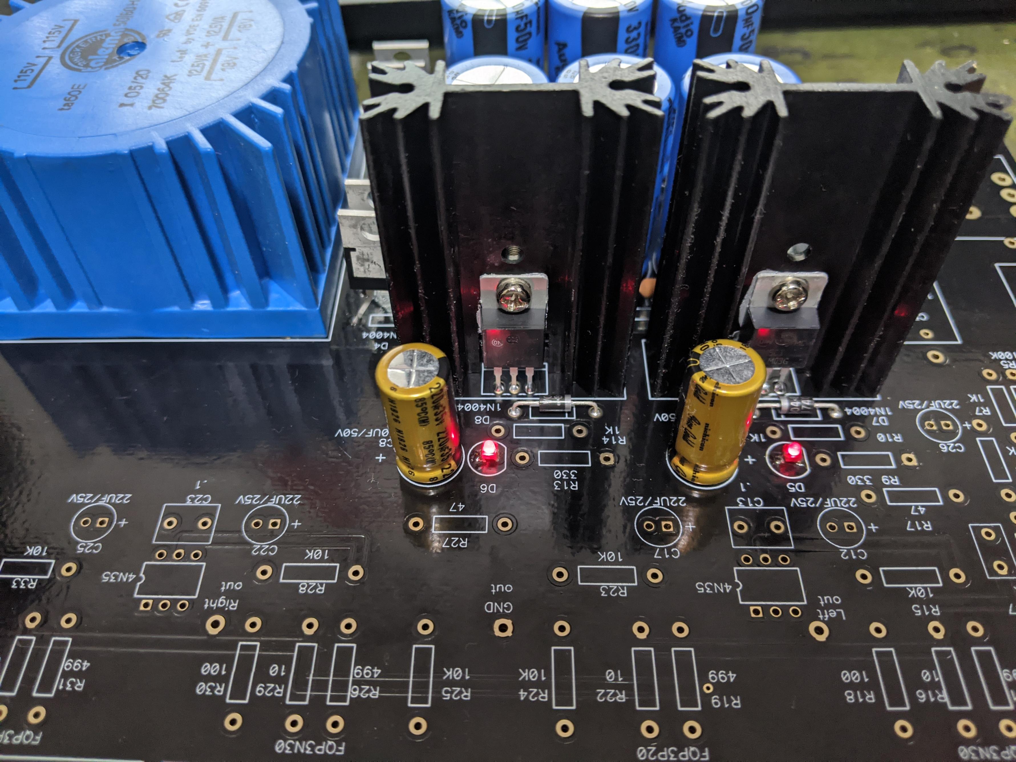

Issue with testing the PSU
Hello everybody,
I need some help to complete my Whammy build, it's my first DIY amp and I'm struggling a little.
After soldering every component of the PSU, I tried to measure voltage as explained in the build guide but my readings are +17V and - 32V.
The LED on D6 doesn't light up, I tried desoldering it because I thought its polarity was inverted but I ended up breaking one of its pin so I'll order a new one.
I tested every resistor no error, every diodes (no reading on D7), I can't read the voltage regulator 7915CT while I get 1V on 7815.

Hi guys,
Just finished and tested the power supply section with a few mods from stock.
- Cree Schottky in place of standard 1N4004 on the rectifier section
- HLMP6000 led instead of standard red led on regulators
Voltages measured fine on the test (+16.5V, -16.6V). The reasoning behind the choice of the HLMP6000 red led was that the forward voltage appeared to be consistently 0.15-0.20V lower than the standard red led.
The absence of 'magic smoke' and 'no-no sparkles' marked the completion of stage one build and testing.
If anyone sees anything amiss here, please let me know.
Cheers
Poly
